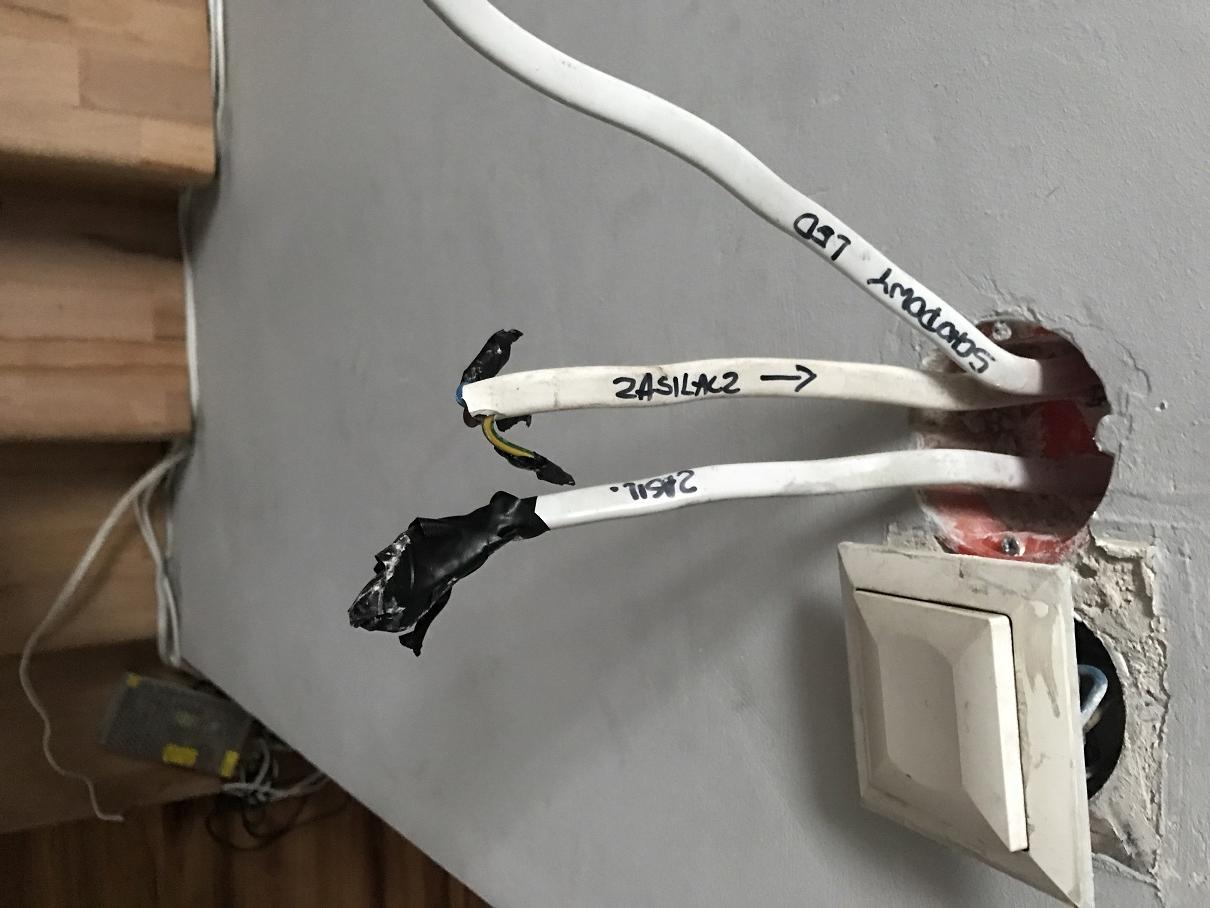

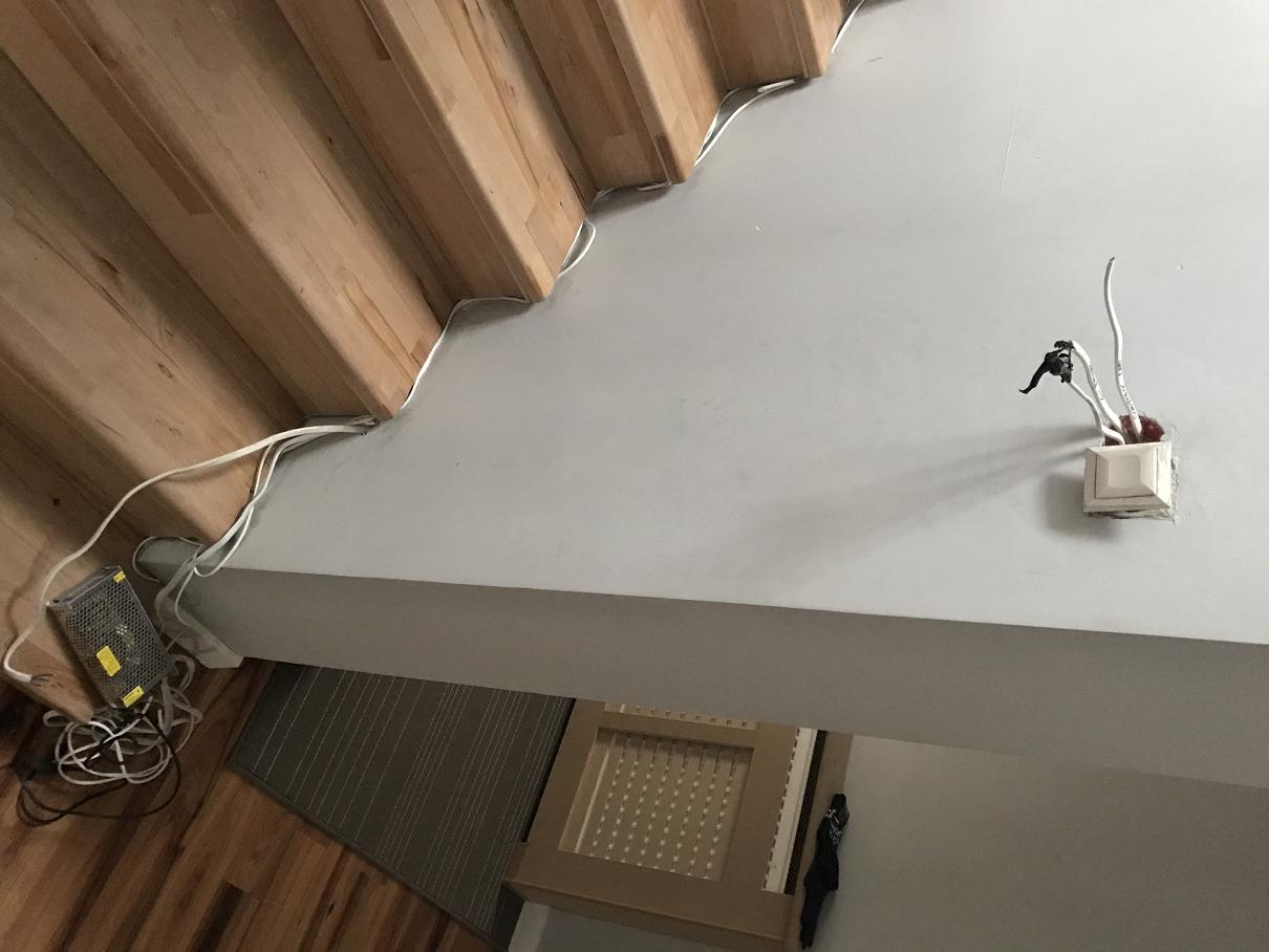

    I need help connecting the stair switch to the led strip. I need a simple bluff instruction which cables should be colored where to connect to the switch at the bottom and top. There are 3 cables sticking out of the box on the ground floor: 1 power supply, 2 power supply (goes down at the stairs), 3 stairs cable that runs up.
    Attached picture.

    And the 2nd stair switch at the top is already connected or the cables are sticking out, because there are no photos
  • #3 16206720
    Obertasek
    Only the cable has no switch yet
    #4 16206726
    Henryk200
    Posts: 45
    Help: 5
    Rate: 12
    and how many cables are there? 2?
  • #5 16206736
    Obertasek
    On the top there is one cable that protrudes in the photo with the described stair led
    #6 16206789
    Henryk200
    Posts: 45
    Help: 5
    Rate: 12
    DOWN: the switch should be at the bottom (letter P), then you connect the power L (brown), then the led staircase connects black and blue goes up, you also connect the black and blue at the top and yellow-green to the letter P and at the bottom yellow and green you connect the power supply with brown to the cable, and the blue one with the blue power supply from the power supply

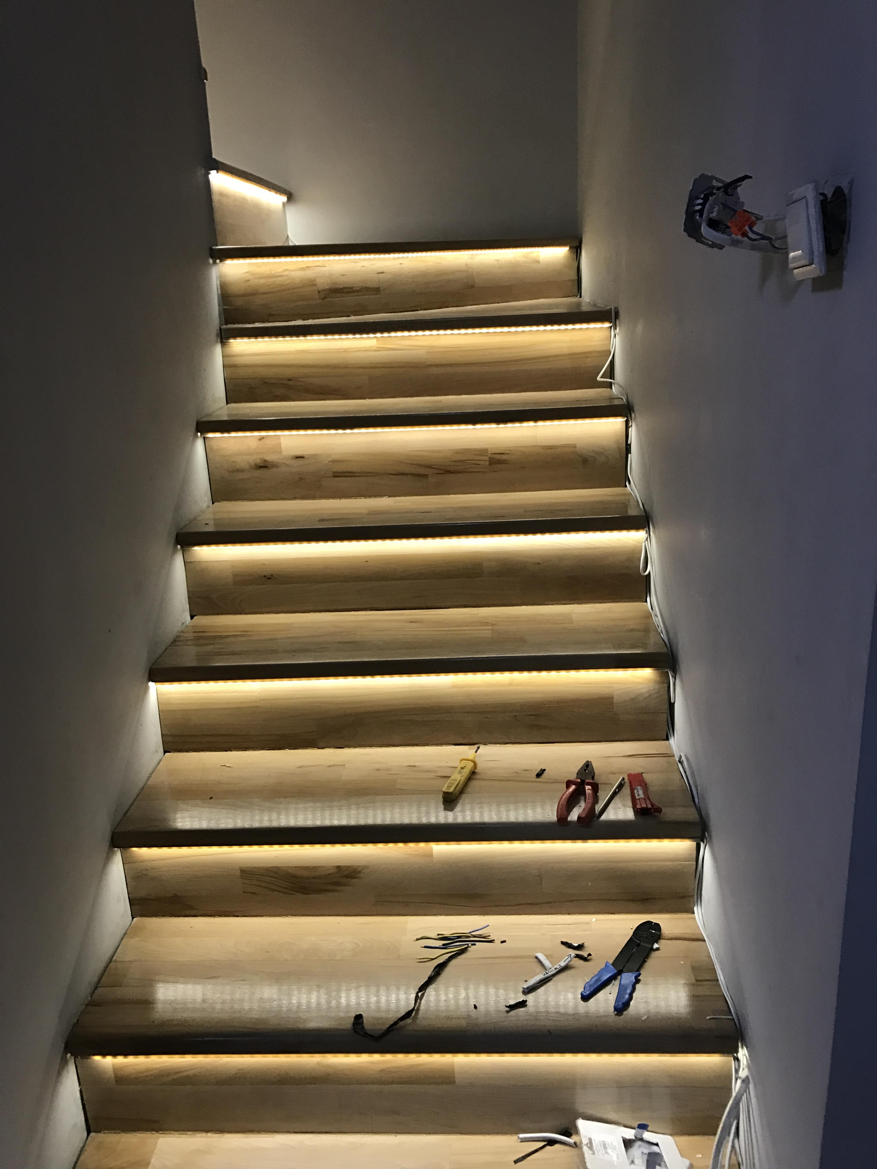

    Thank you for your great help. Everything works.
