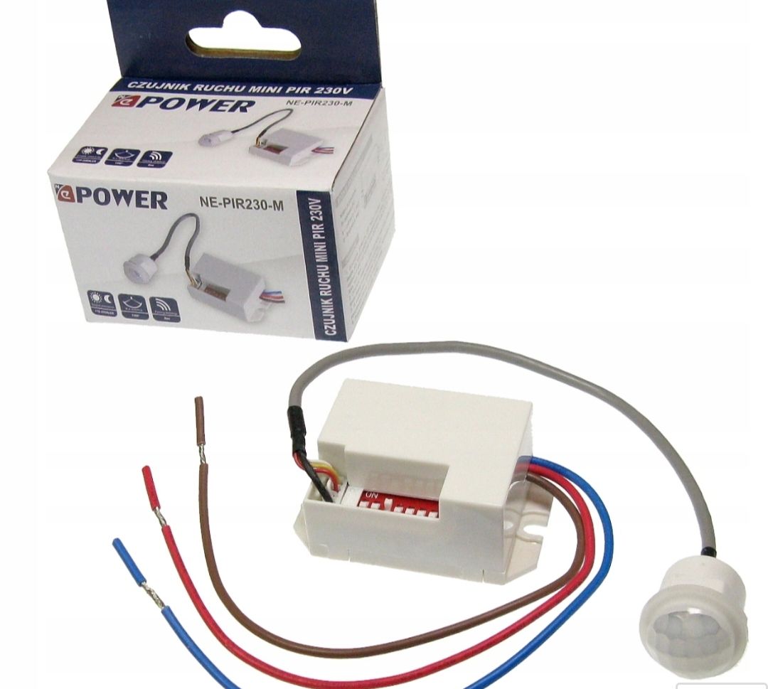

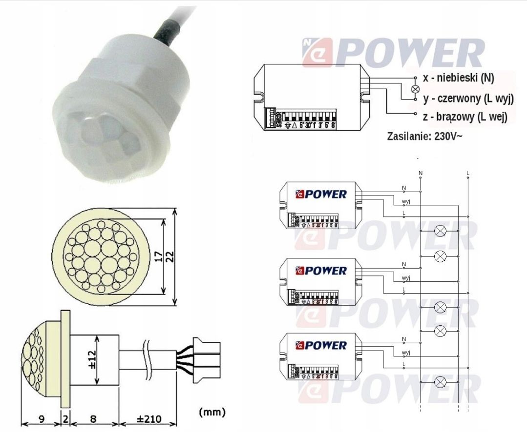

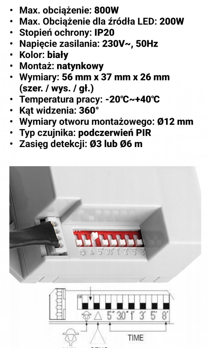

    Hi, can anyone advise me on PIR AC LED stair motion sensors? I have two sensors, one at the start and one at the end, 5 lights with 3 watt LED bulbs. Each time, after about two to three lights, the sensors hang up and the light does not go out. When I wanted to complain about them, the service technician said that something is sticking in them because there is too much voltage when switching on - LED bulbs at standard would not be like that and something needs to be applied before the sensors.

    This service gentleman was not concerned with the wattage of all the bulbs. Just about the wattage of some start-up at the first start-up, which is too high. And causes some welding of the contacts.

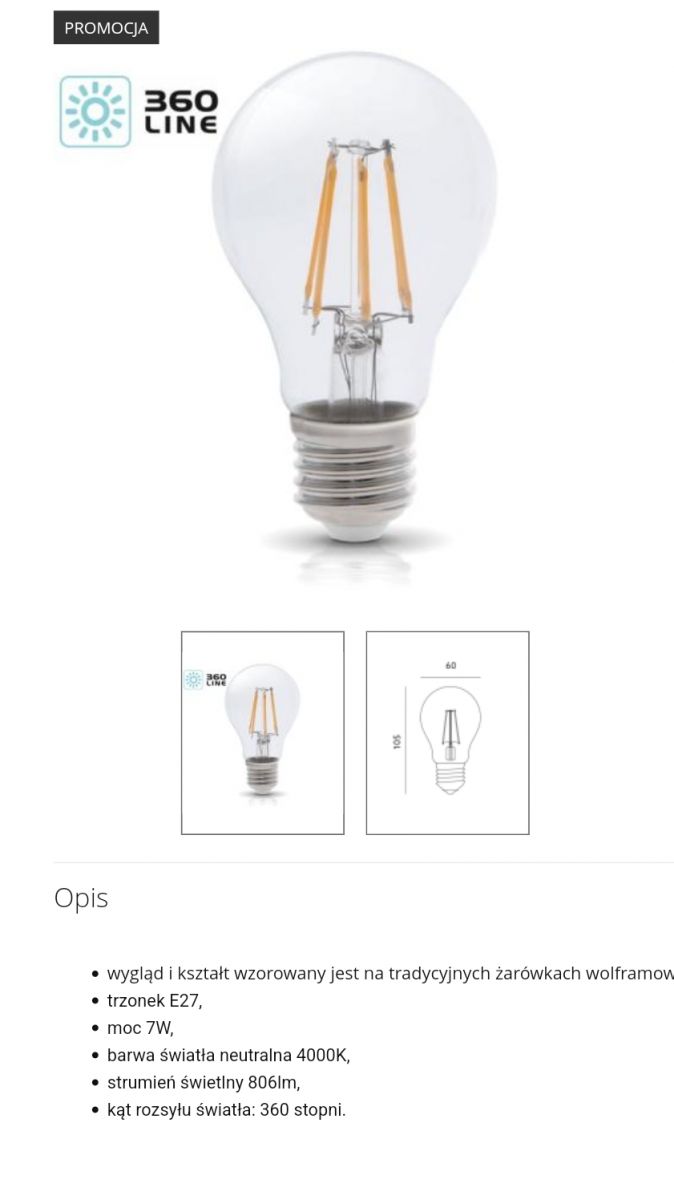

    It is known, capacitors charge quickly drawing more current at start-up. But this is still not enough to cause a malfunction.
    Include the instructions for the sensor and the lamps you used.

    The lamps are normal without sensors, so I bought the two sensors and fitted them.

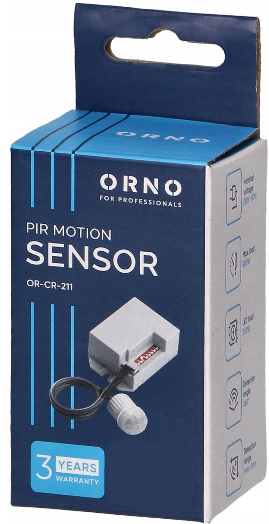

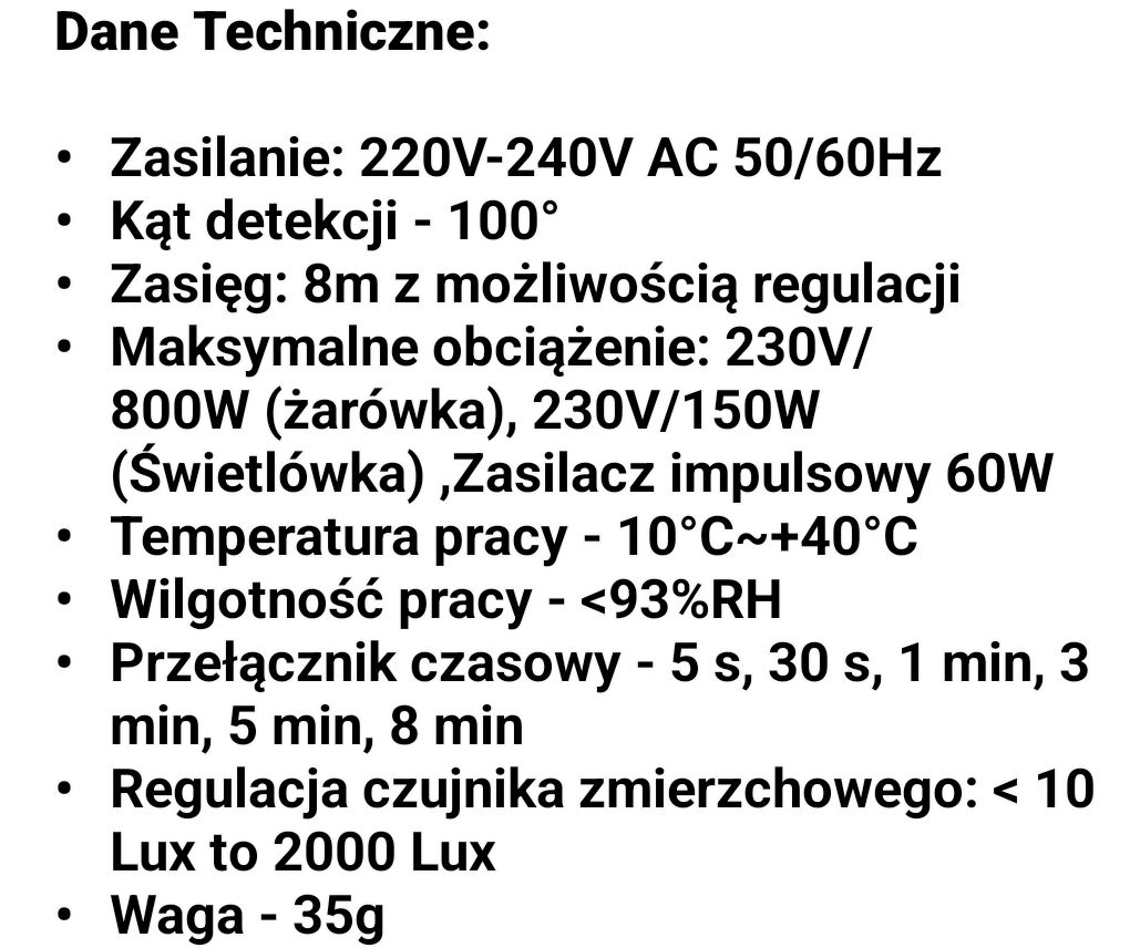

    >>21241404 I think so. But I will say that I can exchange for this expensive or better one because I don't have the strength anymore my wife cries that it's dark etc.

    After all, it is the same

    >>21241476 This one is similar, but I can exchange it for what you recommended.
