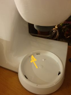

    The limit switch type sensor is in the housing at the bottom, with the bowl mounting on the left side. Just pressing it to simulate mounting the bowl. The round lid from the mixer drives for me does NOT have to be put on when working with the bowl (arm horizontally). There is a hole in it for, say, a magnet, but it is empty. After pressing this limit switch (from the bowl) several times, the robot works as it should.

    Bosch MUM54251 Mixer Issue: Flashing Red Light When Using Lower Container, Blender Works
    I marked the end with an arrow. Once it is flashing, you must turn it to zero for the change to take effect. Otherwise it won't work
