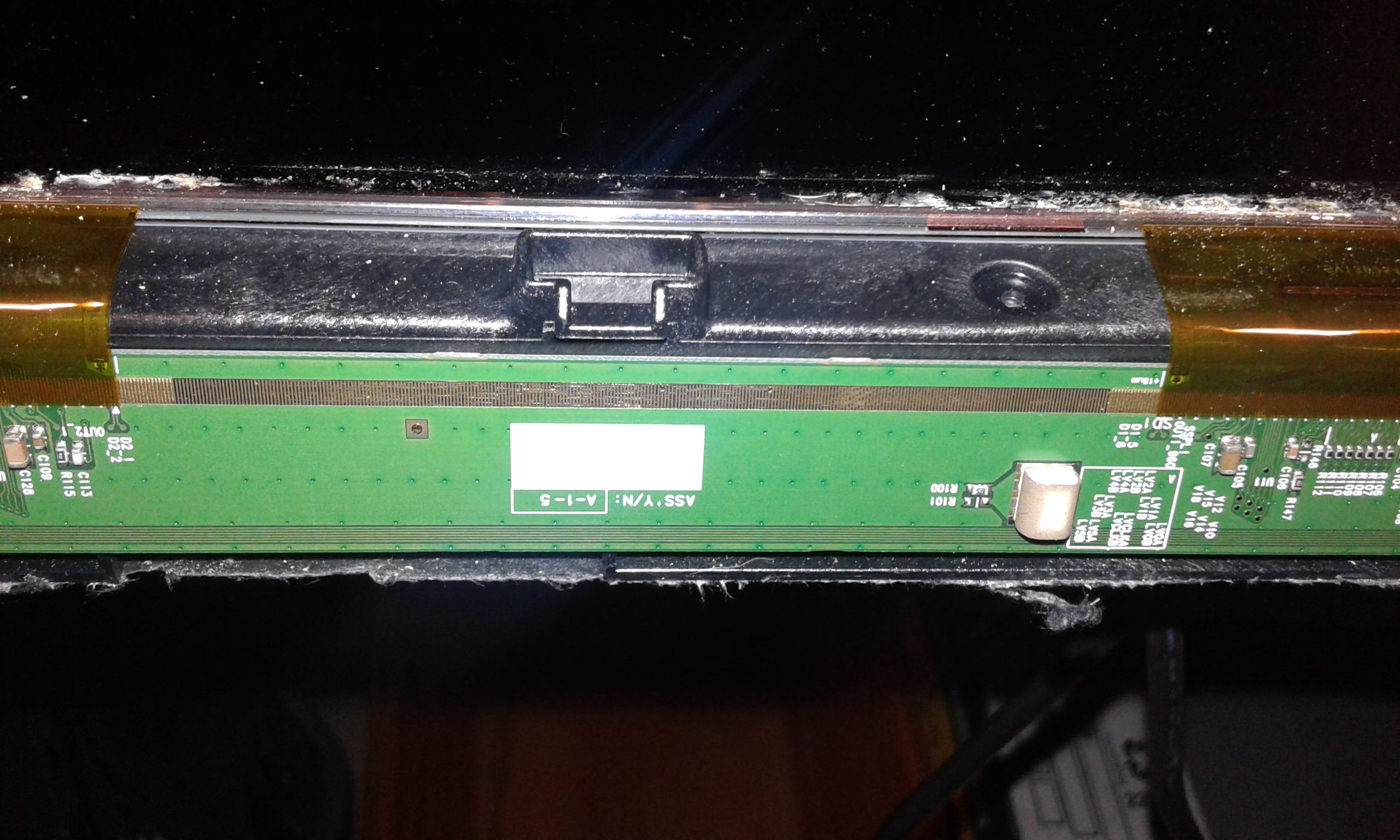

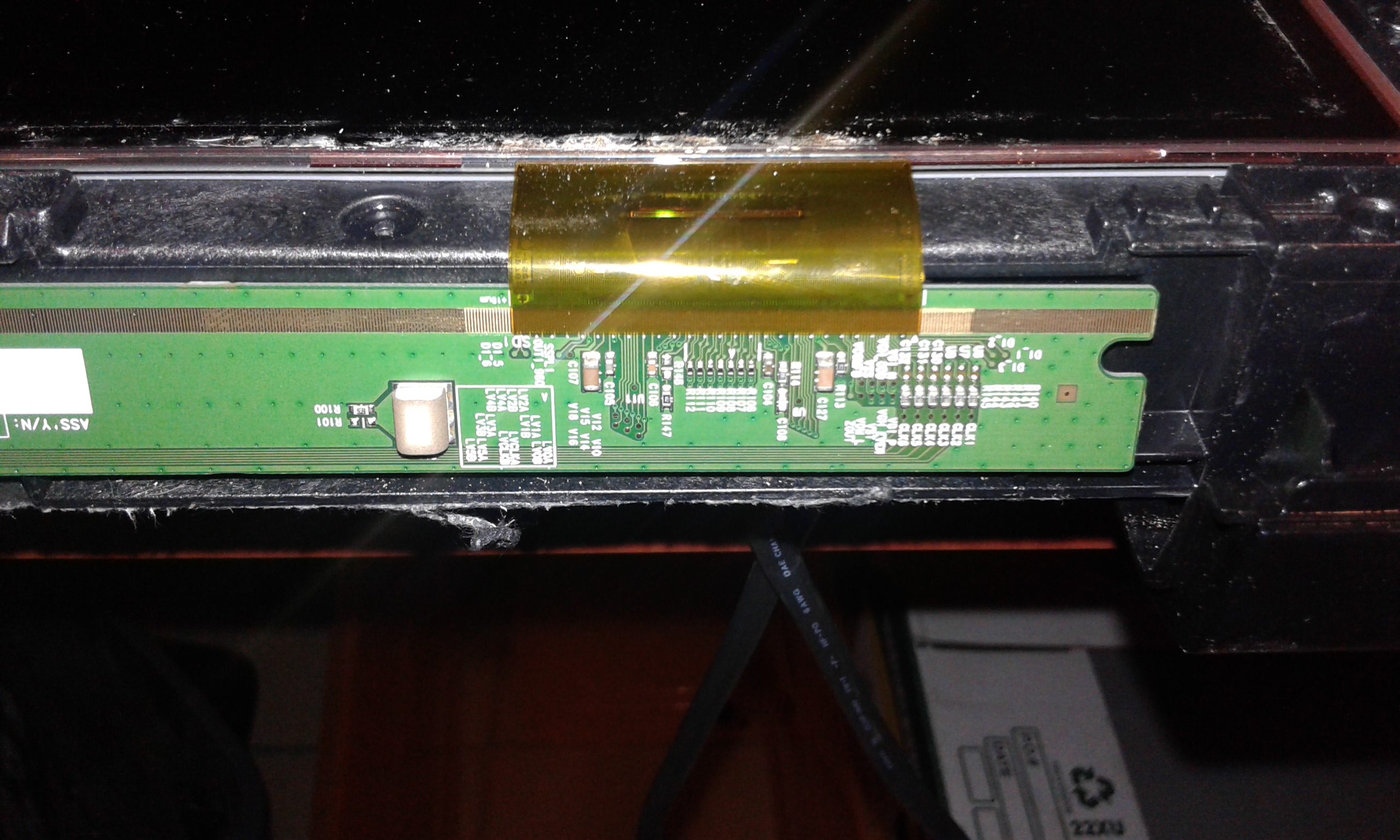

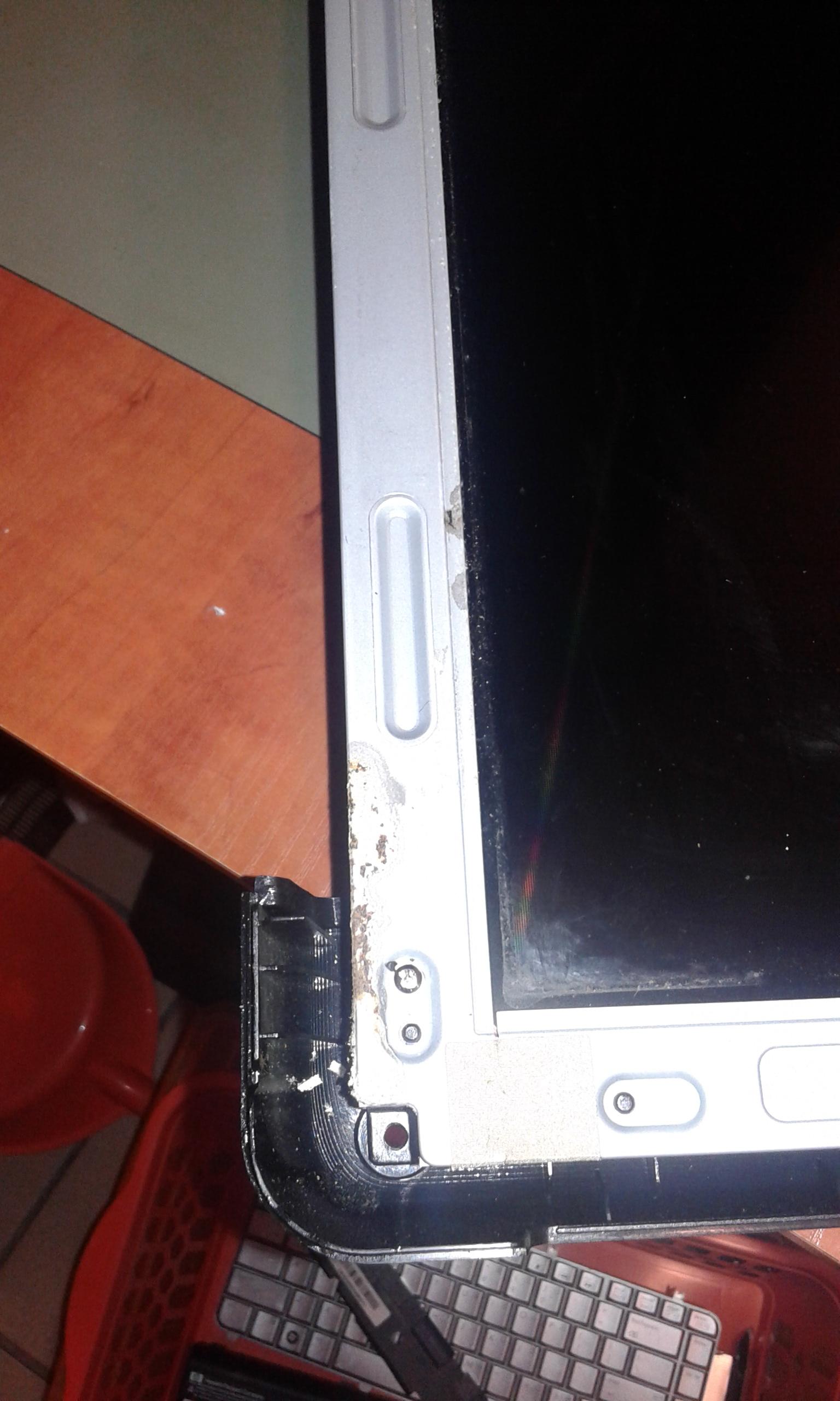

    Hello, I have a problem with the Philips 37PFL4606H TV - the image is foggy, please help me locate the fault. I was looking for a matrix in the logic, but there are no damages, there are no scales. However, it is worrying that the TV was exposed to moisture or flooded, below I put pictures.

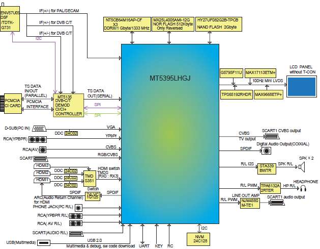

    On this forum, 20 topics were written about 37PFL4606H /? (58/60/12) for chassis TPM7.1E LA and in one Link it states that there is a matrix
    37PFL4606H - 125 - LG370WUY SCA1 (or equivalent to LC370WUG)
    Also given what : main and power supply.
    -eg. PSU 715G4546-P03-H20-003U / 715G4546-P02-H20-003E (4606H / 50)
    - e.g. main 715G4481-M03-000-005X / 715G4481-M02-000-005B (as above)
    - SoC MediaTek MT5395LUGJ System-On-Chip (SOC) TV Processor
    * T-con on main
    • MAX17113ET Multi DC / DC
    • MAX9668ETP GAMMA Link_ datasheet
    • TPS65192RHDR Level shifter
    _______________
    Give your set.
    Rather damage on this small matrix plate (ears)
    - look carefully under the magnifying glass flex tape ( without drips, dampness)
    - this last picture does not look interesting
      Philips 37PFL4606H TV: Foggy Image & Moisture Exposure - Locating Fault & Solutions
    Generally speaking about the fog in LCD
    Gamma - gray scale correction.
     It is necessary to create nonlinearities in the area of dark tones for a more correct perception of people's eyes, ... is more sensitive to changes in the dark. This is the nature to do, and the plate's constructors take it into account.
    ... this nonlinearity is changed into a bright area, so we see a fog.
    It is generally about V-Com, VGMA_REF, AVDD, ...

  • #10 15987345
    lisek
    Service technician RTV
    Posts: 39973
    Help: 6350
    Rate: 6880
    Give me a matrix !?
    Like matrix with "ears" is rather like this.
    But this price!
    Statistics says 50:50
      (' :idea: ') That's just because without measurements on the system. T-con on the motherboard.
    * same "ears" (6870S-0962A and 6870S-0963A ...) in China is about 30 yuan (1yuan = 0.15 $ / only RC elements), unfortunately the cost is irritated by the re-soldering of flex bands to the die.
    You can unscrew the tapes one by one from the ears and see, for example, what will happen.
    * measure voltages with on / off. tape
    * measure Vcom voltage (approx. 7V) / V2-V5 and V10-V13 at MAX9668

  • #15 15988081
    zdzich42
    Posts: 8031
    Help: 588
    Rate: 868
    Gently purge these raids, maybe you will see something more, under the magnifying glass of course or other magnifying device.
