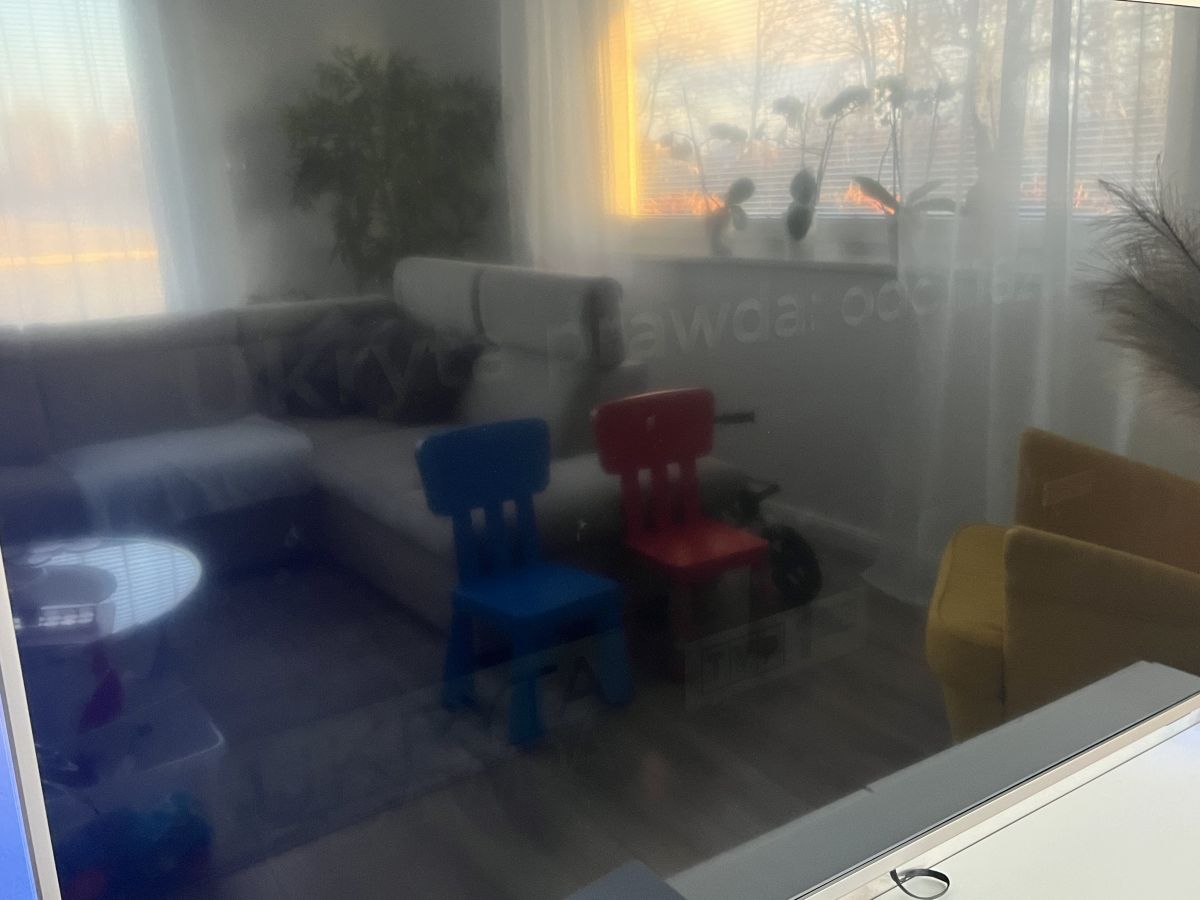

    Hello everyone
    I own a Philips 55PUS6754/12 TV, after about 2.5 years of use the picture has disappeared - the sound works. No menu or anything else is displayed. The only thing you can see is immediately after switching on a short flash around the bezel (probably from the backlight). I have tried shining a torch into the screen to determine if this is just a backlight LED problem but the screen does not seem to display anything.
    I haven't disassembled the TV yet but from what I gather there should be a power supply board and motherboard. Without taking off the guts can you somehow explain where to put the meter to check something?

    jack49 wrote:
    I tried shining a torch into the screen to determine if it was just a problem with the backlight LEDs but the screen doesn't seem to be displaying anything.
    Only Do this completely in a darkened room and with some TV programming on.

    Wojtek M wrote:
    Only do this completely in a darkened room and with some TV on.
    Well here's some good advice. Previously I shone a torch under normal lighting conditions, now I turned the lights off and found that the matrix works!
    Now the question - is it a problem with the LEDs or rather with some kind of driver? Let me remind you that you can see a flash for a moment during start-up.

    All LED strips are replaceable with NEW ones! But first you need to dismantle the matrix and find out exactly, if you have not dismantled such large matrices (55 inches) , you need to have it done by a professional. Also, there may be a break on the LED connectors in the middle of the matrix, but without dismantling the matrix you won't find out. Good luck.

    All clear, thank you for your help. The TV is going for repair tomorrow.

    The backlighting of the matrix has failed. Cost 600zł, after replacement everything works. How old is your TV?

    I have repaired 9 units of this model. In all of them, the cause was the connections between the slats.
