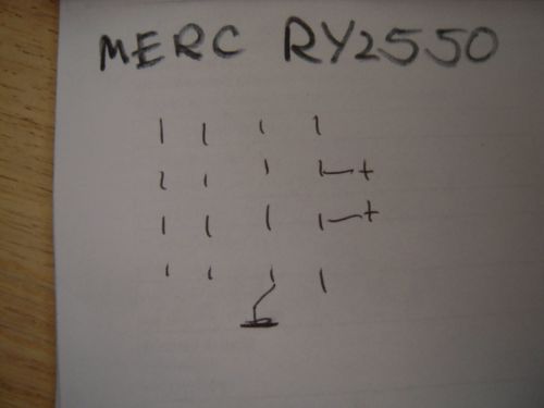

    My brother bought such an invention and we are looking for a description of how to connect it correctly to the power supply and additional signal input / output. Of course, there are no instructions, in Google there are practically no results for this model, can it be based on some similar?
    This radio has to work on the Mercedes Vito. Request for help.

    Everything fits until the radio has no left and right key illumination. Everything indicates that you need to connect the CDC pins, but do you give 12V there? And the last question: the radio entered some anti-theft mode or something and displays a message to turn the ignition switch and reset the system. I do not understand this note exactly under Table A about the additional fastening of the CAN + channel associated with security check. How to connect and why this pin 9?

    Connect pins 9 and 10 to Can-a, then connect StarMB, provide pin and change VIN on the radio, reset and it should work. If it's not blocked.

    Hello. I want to launch such a radio on the table. Giving power to pins 12 and 15, I press it and no reaction, something else needs to be given to fire on the table. I want to check if there is any life in it before buying. Thank you

    Thanks, it works :) the radio fired. The menu is etc. only now no backlighting of the buttons how to solve it?
