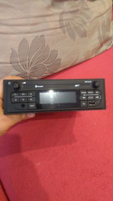

    I have a radio with Renault Twingo III. The radio is R & GO.
    Visteon 281077 / R013 - X07 - Radio R & GO from Renault Twingo III in a diff
    I want to connect it to another car, but it is probably paired with a specific car and communicates with it after CAN.
    Did any of you have to do? Can it be circumvented?

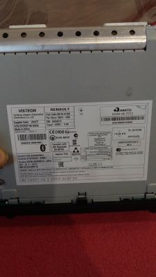

    Visteon production radio
    Supplier code: 281077
    Renault Part code: 28115 6611R
    Part Name: R013 - X07
    In the middle I see the processor STA2165XM2 BC AA022 VQ TWN AA 435 ARM,
    next to the NANYA 1429 memory chip, so it's a smarter system for me.

    I am asking for advice if it can be moved to talk with another car. I would also be grateful for the possible schematic of the connectors. There are two sockets, 20 pin I have an adapter, there is audio and power. It would be useful to spread this 32 PIN
    Or maybe I would be able to connect it to the network of my Laguna II and connect it to CLIP (I suppose that another speed on CAN, but to ask will not hurt)?

    Hi, I have a schematic and similar radio only 1din from Masters. After giving him power it was ok, the menu worked but after connecting + 12V in the contact of the ignition switch (7 pin right cube) the radio has been blocked and there is communication: "System blocked contact the supplier". So what is now with you.
    He concludes that he has been blocked because he has no communication with the car via CAN.
    in the attachment you have pictures of plugins based on which this simple scheme is
    From what I read on the Dacia forum it is possible to connect this radio directly to CAN by selecting multimedia options or something like that. In pdf you have these pins, in addition, as you start the radio, one of the scalpers is responsible for CAN, I do not remember which (probably near this 32pin plug) but how you will look at Google after the signs you find.
    If you solve the problem, write here, because I would also like to run this radio.

    Thanks great for the scheme.
    It seems that in plug 32 I am interested in pins (counted backwards) 17 and 18.
    Pin 17 to pin 14 in the OBD plug, i.e. CAN Low
    Pin 18 to pin 6 in the OBD plug - CAN High
    The chip you're talking about is already located, it's the IC301 position near the 32pin socket. This is NXP TJA1042 (http://www.nxp.com/documents/data_sheet/TJA1042.pdf). I checked the scalout legs to the 32 pin and CAN L and CAN H sockets. The feet are counted from the white dot around, on the foot 6 is CAN L, on the stem 7 is CAN H.
    In the data sheet there is something about the stanby mode, I wonder if it would allow it to be cheated.
    Now, my most important question is whether the incorporation of this into the lagging network of my Laguna II did not burn me in CAN? Because I did not want to immobilize the toy car. I also think about what would be needed to simulate this CAN on the table, would UCH help me?

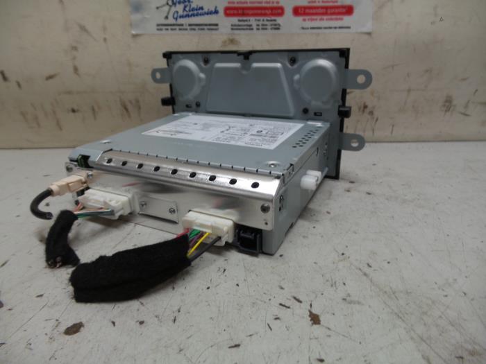

    Gentlemen, I have a radio like the one in the pictures, and I want to connect it to Renault Scenic 2006. Can you advise me where to buy the right adapter? All adapters are used to connect an ordinary radio to the Renault installation, and I just want to plug Renault but from different vintages (slot from R.2006 and plug from R.2015 < ;) I would do the adapter itself, but how can I make it work? And how do you deal with this blocking? I did not know that this was the problem, I thought it was enough to enter the radio code and already. Where to get it?
    This does not apply to you because for an old car without a cana to the radio you set up a radio from a newer year.
    Kostke radio - iso you will get on the Allegro.
  • Need adapter from Scenic harness to Visteon radio plug
    #10 17781784
    netoperek
    Posts: 75
    Rate: 48
    SZYMON BYDGOSZCZ wrote:
    ... Kostke radio - iso you will get on the Allegro.
    Well with this is the problem, because on the Allegro are cubes, where there are sockets to connect the adapter to the bundle in the car, and the plug to connect to the new radio. And I need an adapter, where there will be plugs for the radio presented in the picture, and sockets for the beam in Renault Scenic (the current radio is Tuner List Update).
