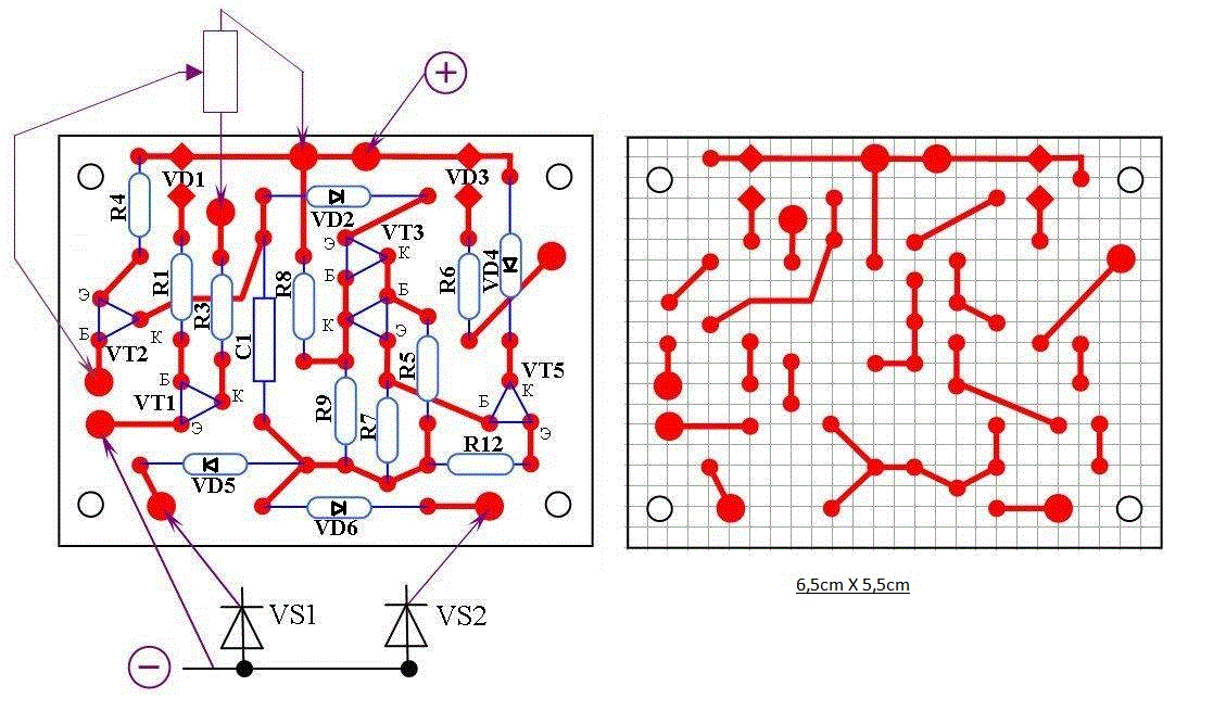

    Hello, I am looking for a charger diagram for gel batteries / AGM 12V 800A 100Ah I have not found such a powerful charger. Thank you in advance for your advice

    Rectifier diagram for battery charging. The maximum charging current is limited by the capabilities of the transformer (power), diodes and thyristors Charger Diagram for 12V 800A 100Ah Gel/AGM Battery: Seeking Recommendations Charger Diagram for 12V 800A 100Ah Gel/AGM Battery: Seeking Recommendations Charger Diagram for 12V 800A 100Ah Gel/AGM Battery: Seeking Recommendations ( electricity ) . Defense against incorrect polarity and short circuit.

    Will the charger like in the scheme above be suitable for such large battery capacities ?? I also mean not too long charging time, i.e. 24h max. Does he also have automatic current regulation ??

    Mate, kowal242! In the first - what you mean - automatic current regulation. In the second - I think I wrote understandably - The maximum charging current is limited by the possibilities of the transformer, diodes and thyristors. If you need a 10A charging current - use a transformer for the rectifier, a secondary winding which at a voltage of 18 - 20 V can protect a current of 10 - 12 A, diodes and thyristors for a current of not less than 15A. At the same time, the diagram can protect the thyristor control that exceeds 80 - 100A.

    '' Automatic intensity control '' I meant versatility for different battery capacities so that I could only connect to the battery and do not have to set any parameters. 10A in my case is completely enough, i.e. the system with the attachments above will work :)

    The diagram only protects the manual adjustment of the charging current. Sure, if you know the rectifier scheme that meets your requirements, then you will quickly disappear the thought of implementing such a project. It is easier and cheaper to buy a finished product.
