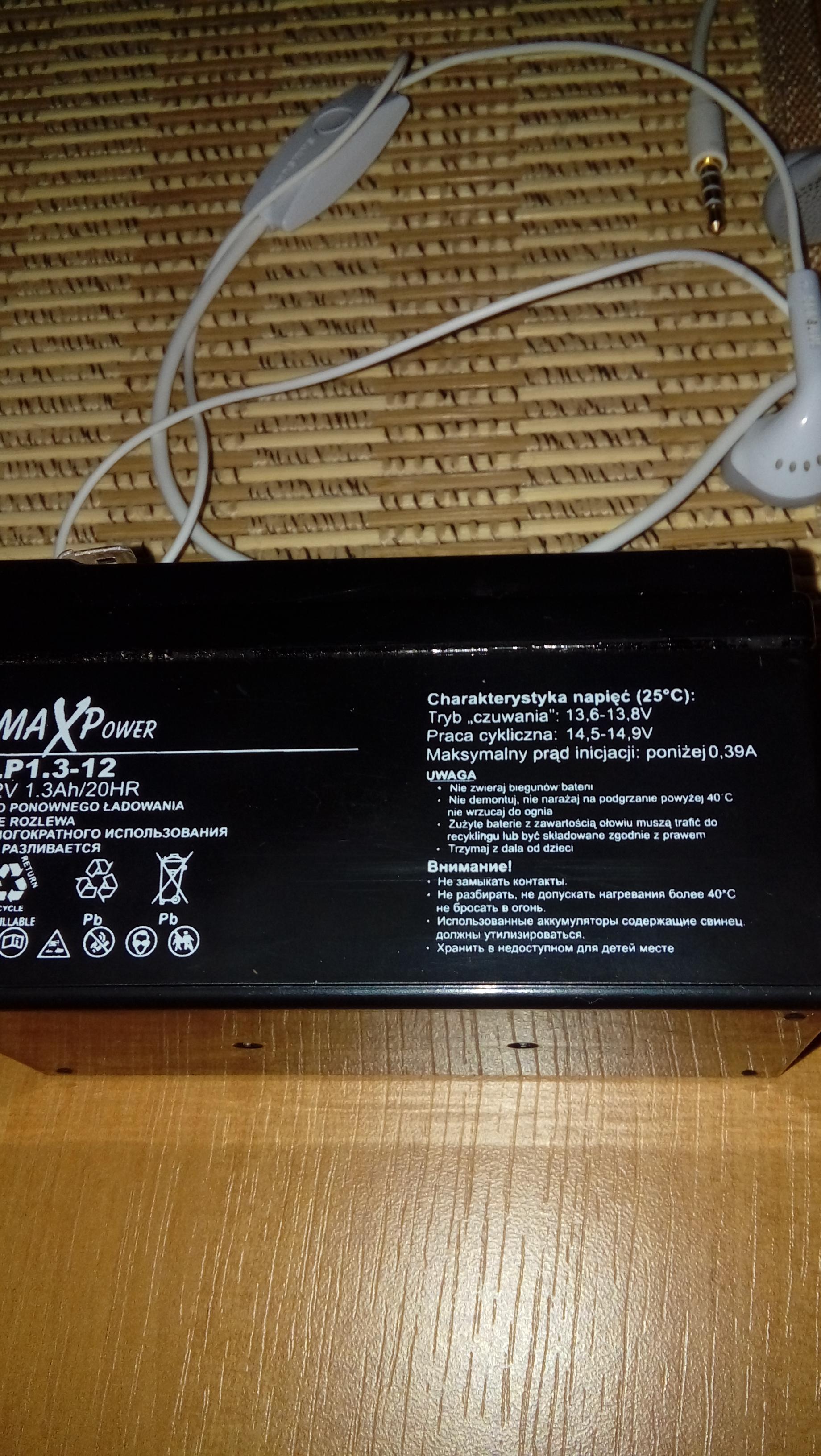

    Hi, I bought a small 12v battery and I do not know if it can be charged with a charger like an acid battery

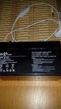

    I do not know if this picture will help in anything Charging 12V Gel Battery: Compatibility with Acid Battery Charger & Rectifiers

    The battery has only 1.3 AH.
    The current will be tiny.
    A good question is what exactly is the rectifier.
    Because if you have one that has a peak on the level of 14.5-15V, it can be especially noticeable that the battery is allowed to be 14.9V. It is not an elegant solution and will be slow to charge in the final phase but the risk of overcharging is much lower.
    The peak can be checked by connecting a capacitor (several dozen uF of age, remember that it must withstand 20V or more) and measuring the voltage on it. Normally, in cheap chargers you will see a peak voltage of 17-18V.
    This is an AGM battery. You can charge it with a regular rectifier, but with a 3-4W light bulb (in series). End voltage as on the casing, do not allow discharging below 11V, store as fully charged as possible.

    And what will happen as the voltage drops below 11v
  • #15 16479029
    Xantix
    Posts: 6483
    Help: 686
    Rate: 1656
    The battery will be deeply discharged and will sulphate which will reduce its efficiency. Do not discharge the battery below 11 volts and charge as soon as possible after unloading. It will prolong its life and efficiency.
