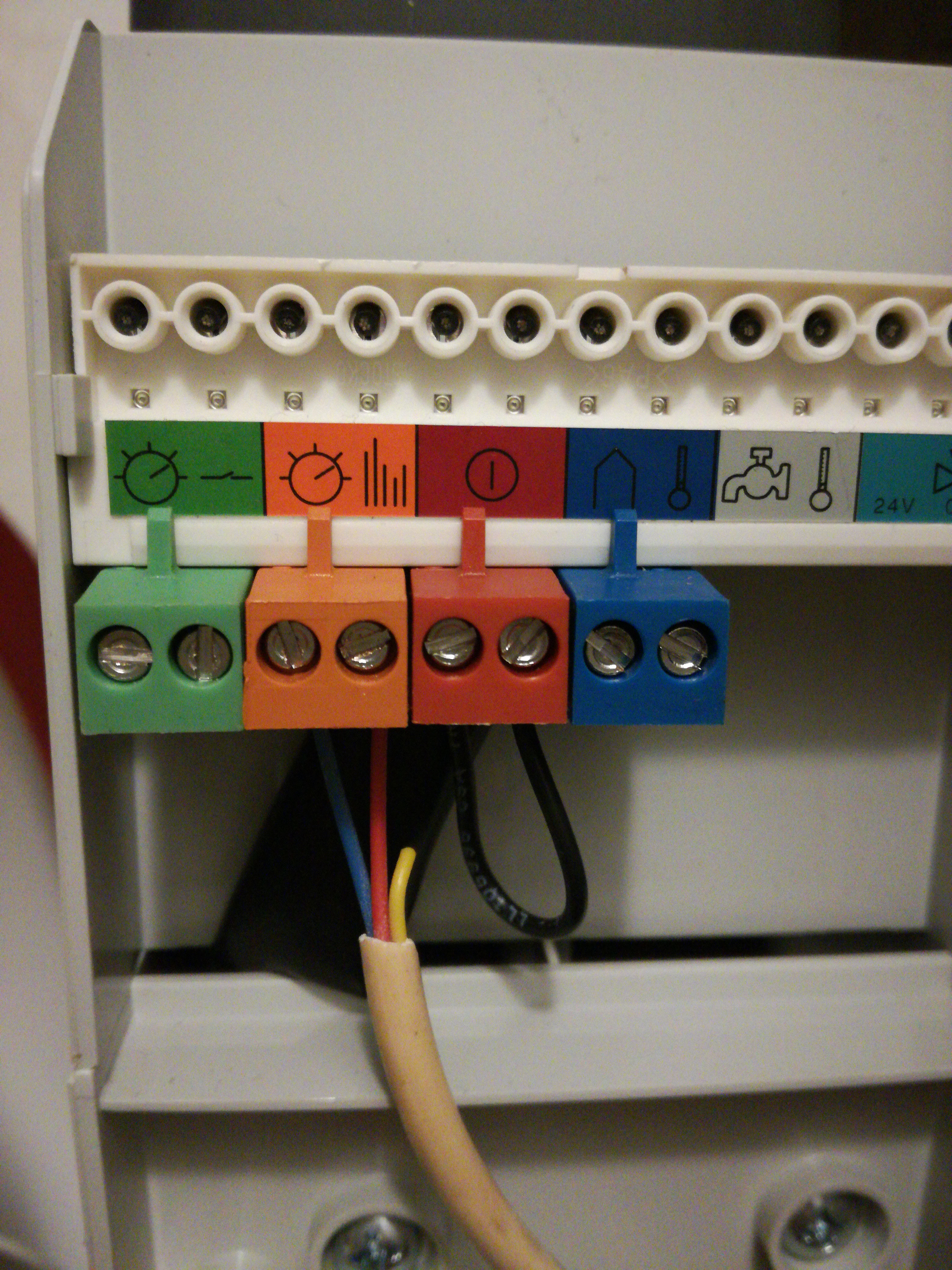

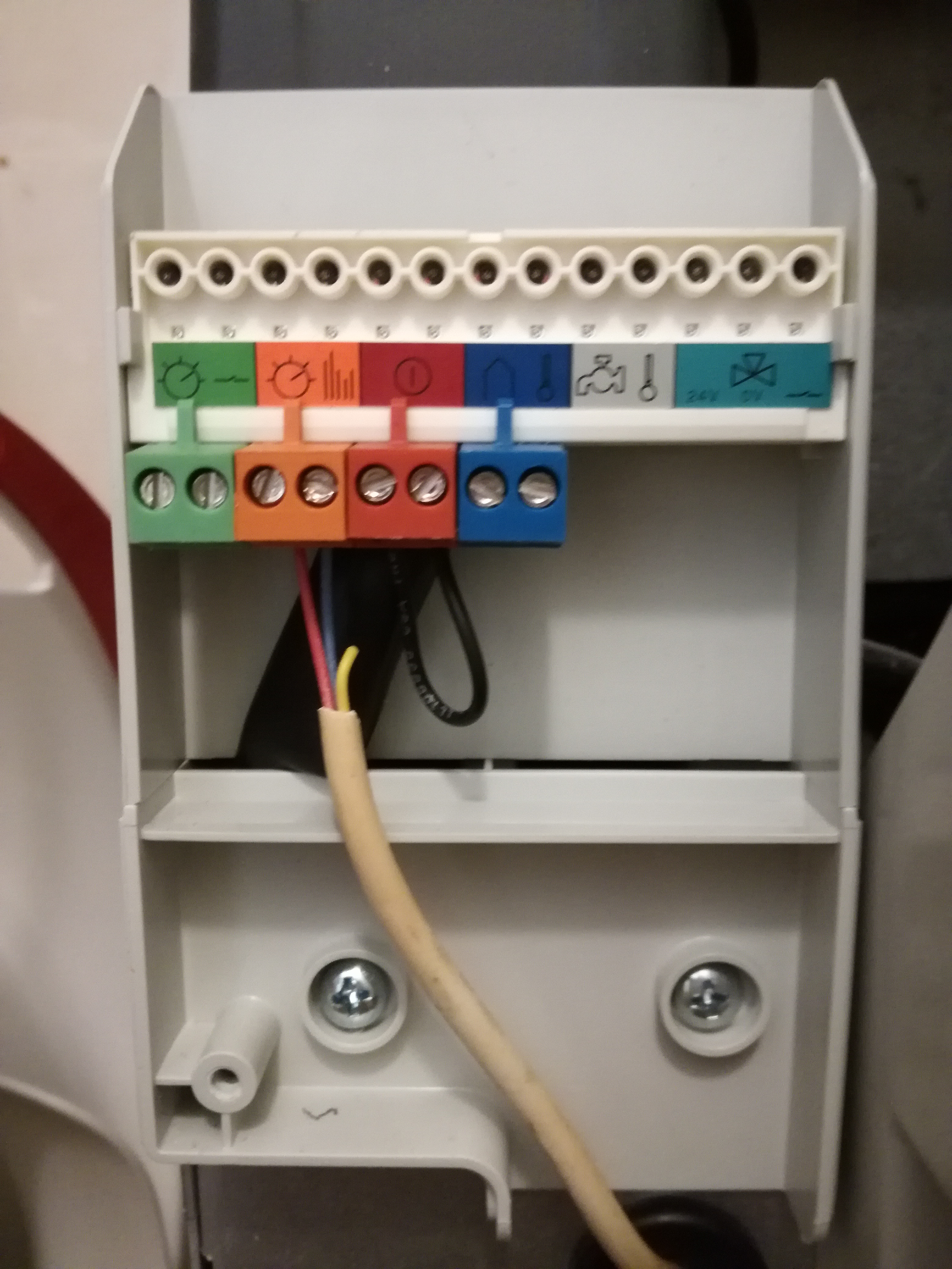

    Hello, like in the subject. I bought a Nest thermostat, you can say that I have almost connected it, but it does not start with the stove (nefit) in the attachment there are a few pictures, maybe someone will help where I made the mistake by connecting the cables.

    Give the diagram and describe your connections.
    The pictures show quite weak markings.

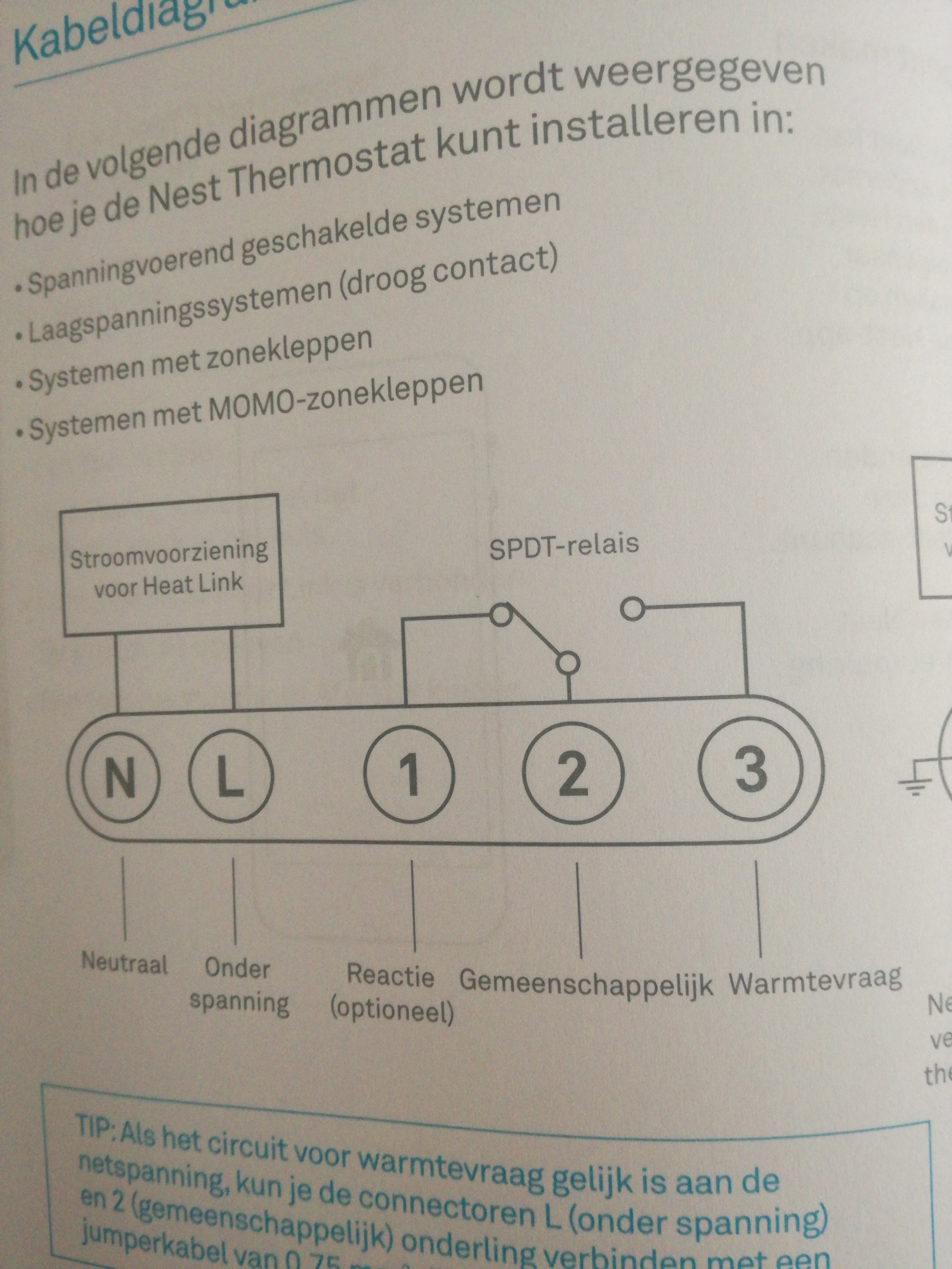

    Hello. Here are what diagrams were included in the kit.
    • Nest Thermostat Connection with Nefit Stove: A Comprehensive Guide and Cable Setup 1483797576079462610507.jpg (2.59 MB) You must be logged in to download this attachment.
    • Nest Thermostat Connection with Nefit Stove: A Comprehensive Guide and Cable Setup 1483797550843-510880371.jpg (4.7 MB) You must be logged in to download this attachment.
    • Nest Thermostat Connection with Nefit Stove: A Comprehensive Guide and Cable Setup 14837871535301944171041.jpg (3.54 MB) You must be logged in to download this attachment.
  • #4 16180161
    Krzysiekok22
    The heat link has been connected as in the diagram, the problem is the connection of the furnace with the heat link. Nest connects wirelessly to a heat link.
    Dude, I don't understand something here.
    If there is wireless communication here, why do you have cables connected to the relay?
  • #6 16181809
    Krzysiekok22
    The wires for the relay are for powering it. It can be powered via USB or cable, and communication is done wirelessly.

    Nefit uses EMS communication and Nest communicates via OpenTherm, you need to buy a small adapter between the stove and the heatlink, "EMS to OT".
