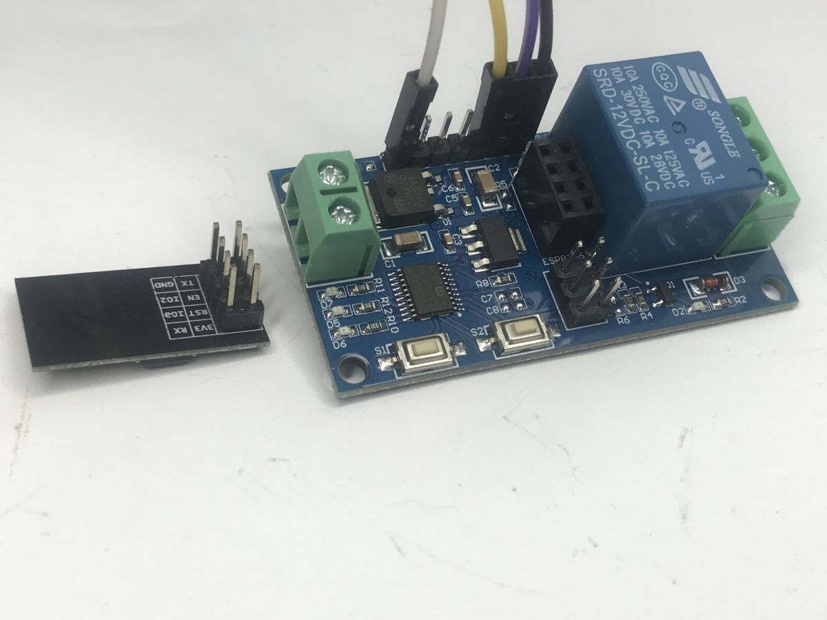

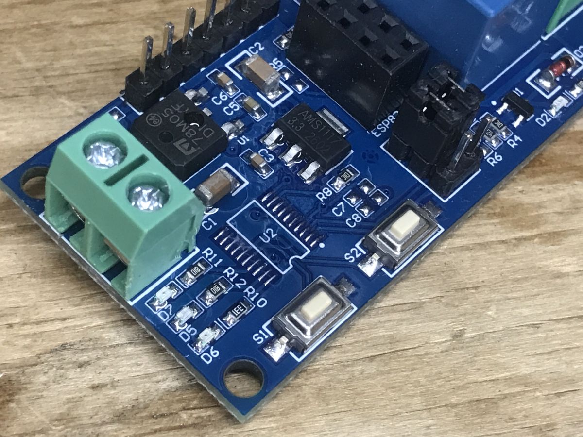

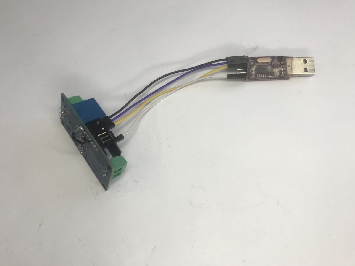

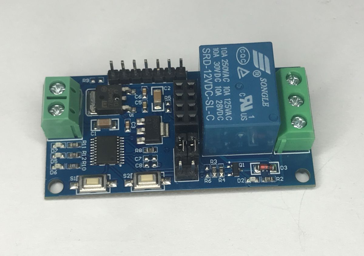

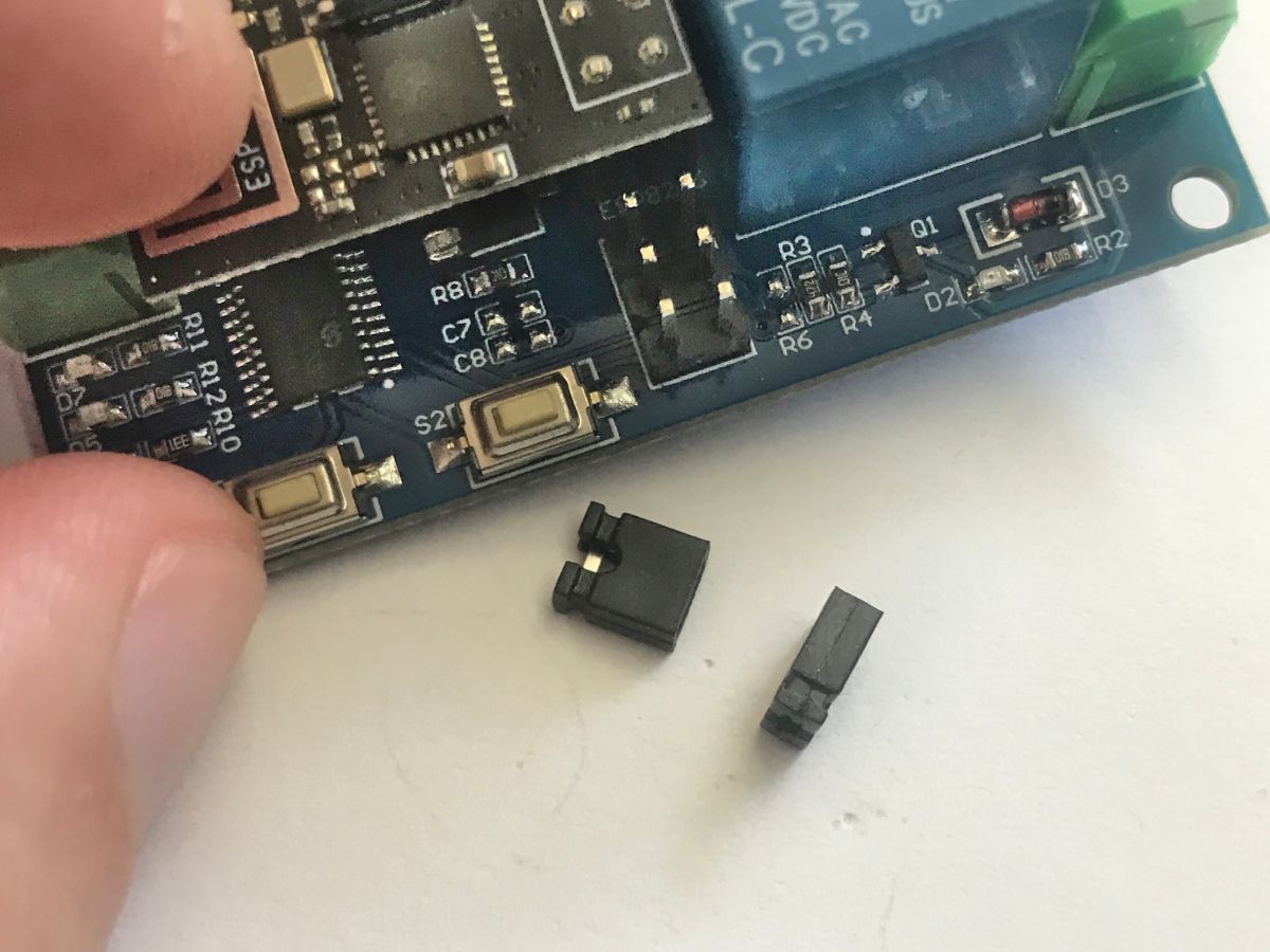

    The reader was having trouble updating the firmware. After connecting the UART, the ESP failed to respond to communication attempts. The device was sent to me so that I could investigate the situation. A mysterious pair of jumpers immediately caught my eye.
    We are modifying the relay controller so that it works without a microcontroller – ESP8266 Relay V2.

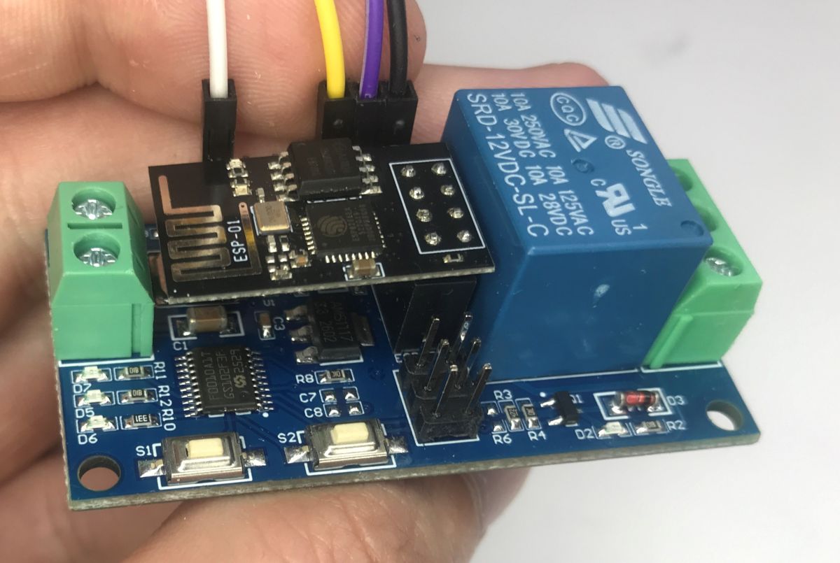

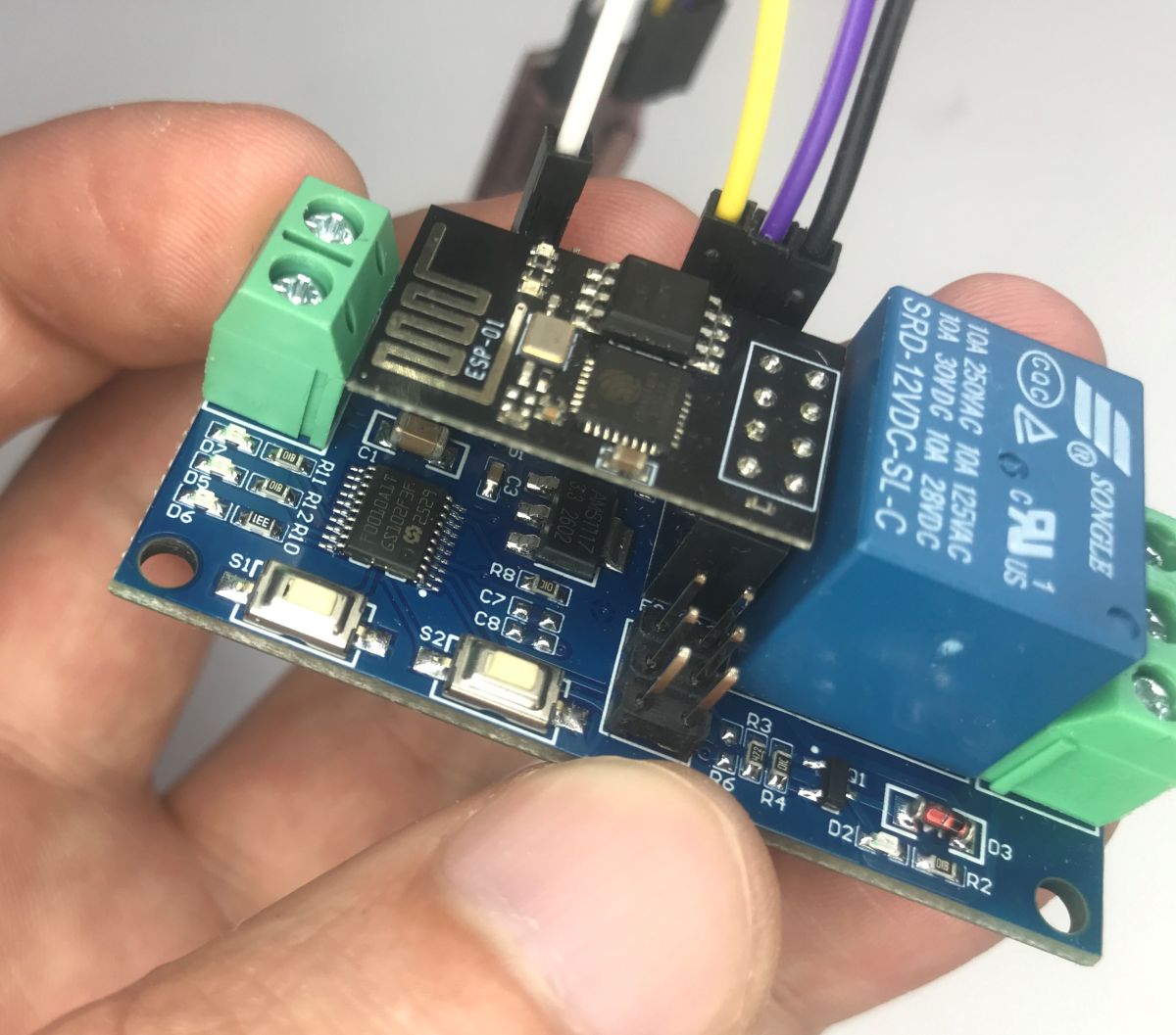

    Underneath the ESP8266 module is an additional microcontroller that communicates with the ESP via UART. But what for? Details of the protocol can be found on the Blakadder website; it seems fairly straightforward:
    https://templates.blakadder.com/LC-ESP8266.html
    But why make it so complicated? After all, Tasmota can control the ESP’s GPIO pins directly. For this reason, I decided on a different modification to Mr Blakadder’s, but more on that in a moment.
    First off – a copy of the original setup. Once the jumpers connecting the ESP’s UART lines to the MCU have been removed, esptool starts up correctly straight away.

    My idea was to remove the microcontroller and connect the ESP pins to a relay, a button and an LED, as described in the thread
    ESP8266 and Tasmota – step-by-step Wi-Fi relay control . You can desolder the microcontroller using hot air, but it’s worth applying flux to the pins.

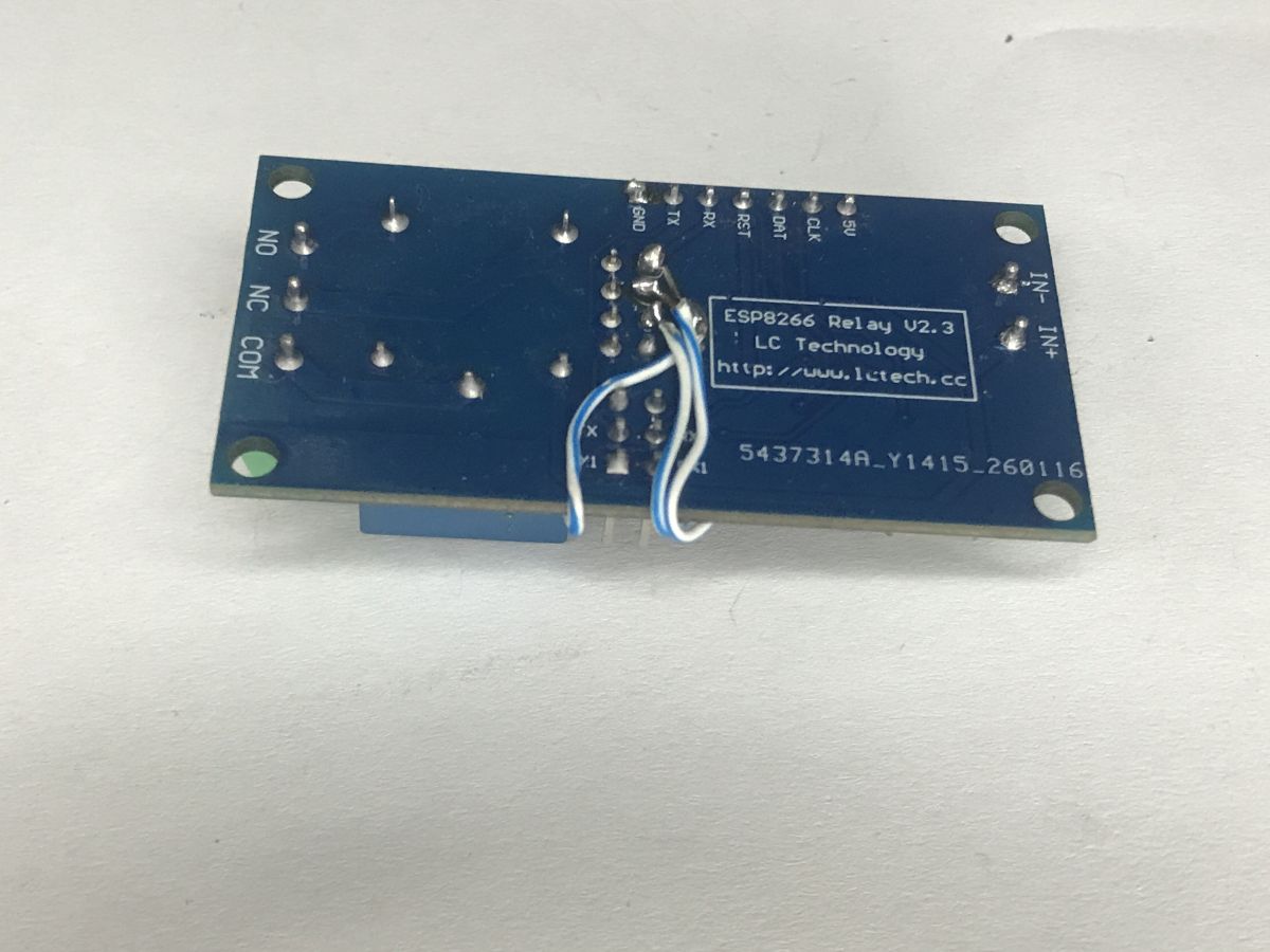

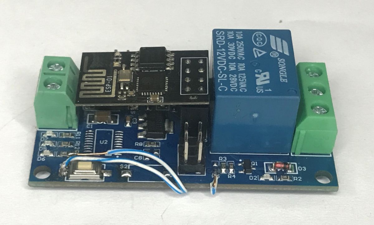

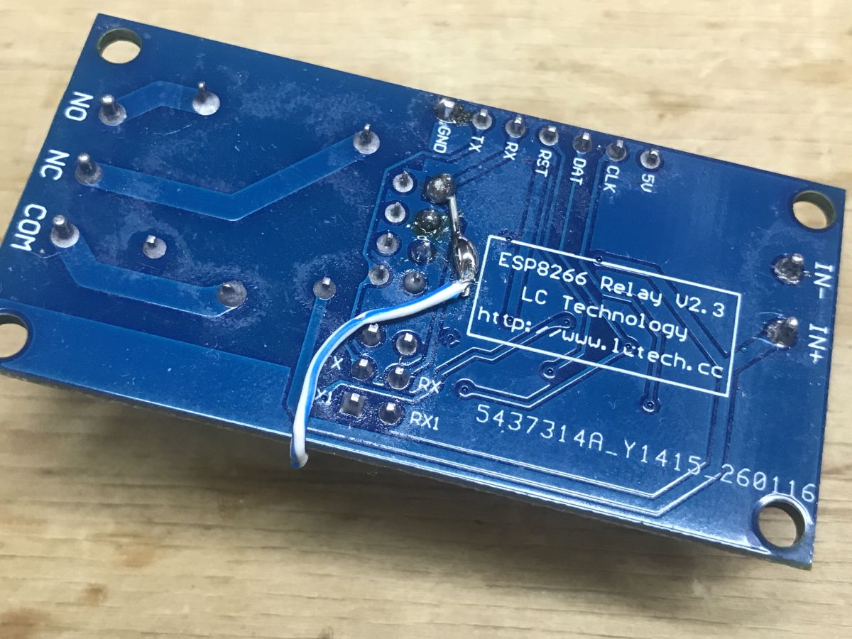

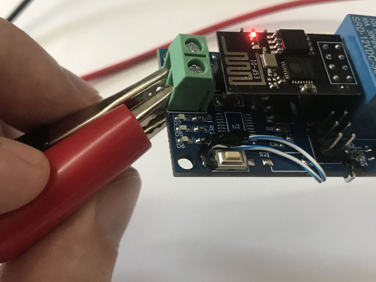

    Next, you need to make the jumpers. The ESP8266-01 only has a 2x4 connector, which carries power, ground, UART and a few GPIO pins, including GPIO0 for programming. You need to be careful with these pins; for example, you mustn’t short GPIO0 to ground during boot-up, as the module will enter flash mode instead of starting up normally.

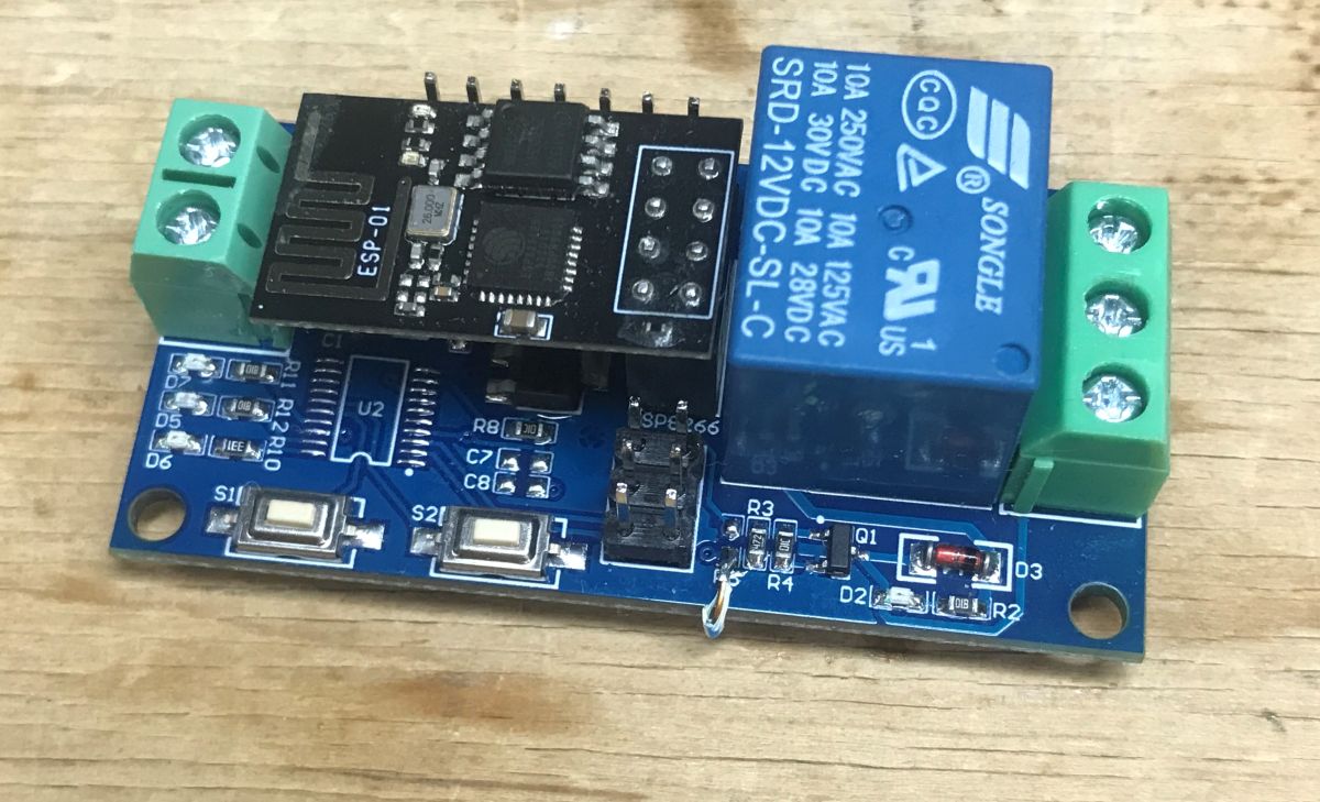

    This is how the relay connection turned out. The entire board requires a 12V DC power supply – this voltage powers the Songle relay coil directly, whilst the board features a 7805 regulator and a separate 3.3V LDO for the ESP8266. The ESP itself, with its 3.3V logic, cannot control the coil directly; therefore, I routed the control signal from the ESP pin via a single wire stripped from an Ethernet cable on the underside of the board to the base resistor R5 (4.7 kΩ, marked 472). This resistor limits the current from the ESP pin and drives transistor Q1 into saturation, connecting the relay coil to earth. Diode D3 is connected in parallel with the coil to suppress voltage spikes when the coil is switched off.
    We are modifying the relay controller so that it works without a microcontroller – ESP8266 Relay V2. We are modifying the relay controller so that it works without a microcontroller – ESP8266 Relay V2.

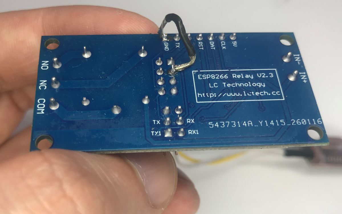

    I disconnected the button and LED in a similar way. The button is shorted to ground, so it’s ideal for use with GPIO0, just as is done in IoT devices, so that pressing it when power is applied activates programming mode.

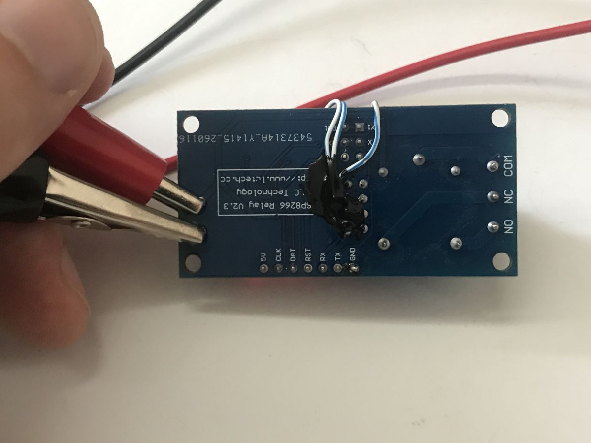

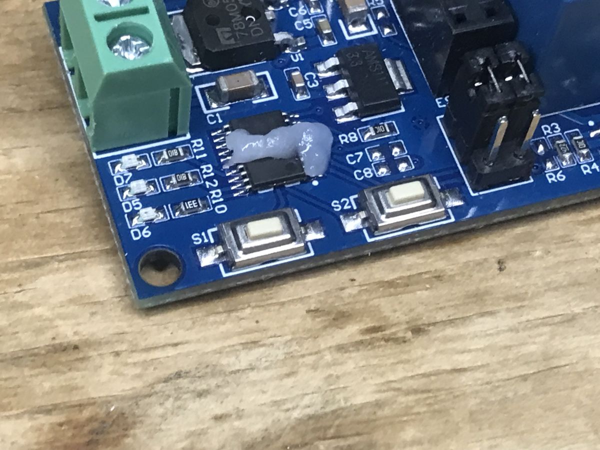

    Finally, I protected the more sensitive areas with a UV-curable solder mask:

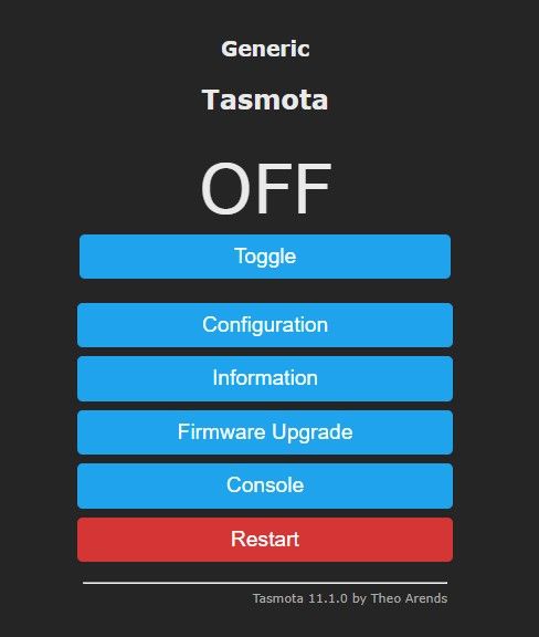

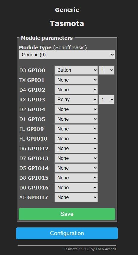

    Final test – the relay control works, both from the Tasmota panel and via the button. Tasmota also detects state changes triggered by the button:
    Settings:
