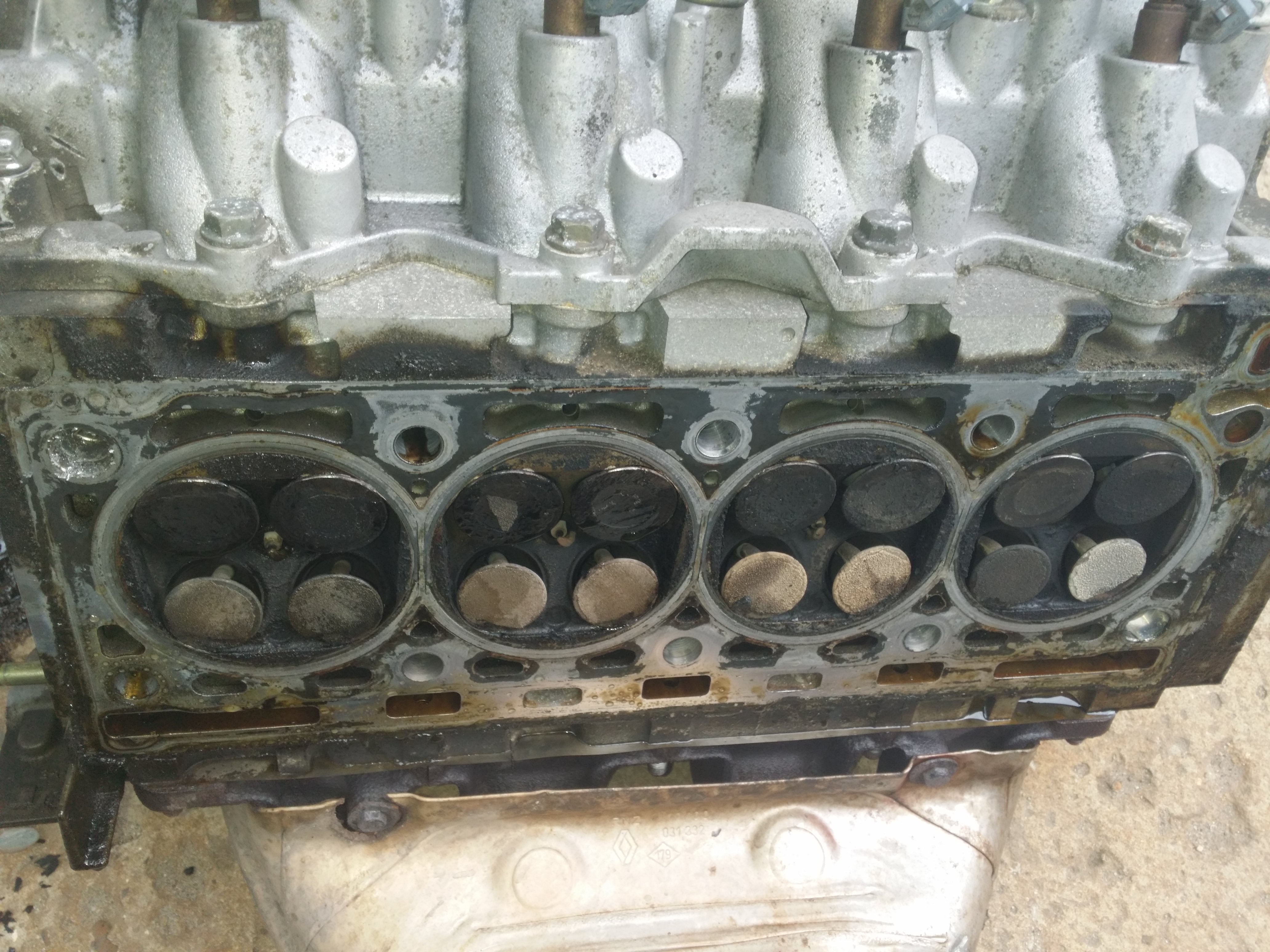

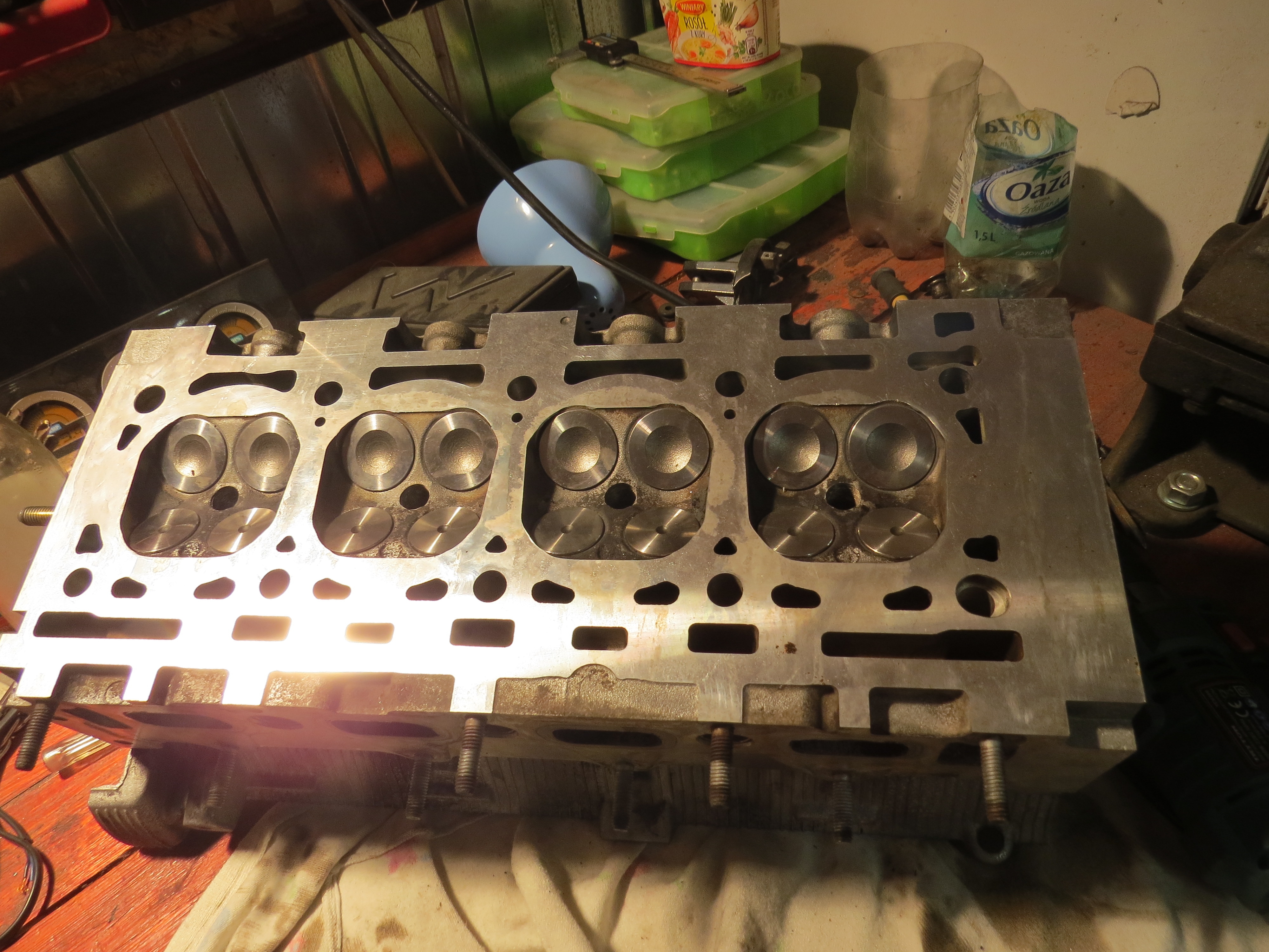

    Welcome back . And that's why I have been trying to do it personally for some time. Actually, I think since I drove a mondeo to replace the brake discs. They hammered 5 kg into these shields until they crumbled. And I stood by them. And if I wasn't there, what would they do? As for the described problem is: In that year, in June, a month before I went on holiday, the V-belt broke during the ride (the second in two years) and of course pulled it into the timing. The timing did not stop, but had to jump and as a result the engine to work. My engine is 2.0 16V F4R780 (very good, powerful and flexible). I removed the head and all 16 valves to be replaced. Scratches on the cams of the rollers, scratches on the bearings in the head. Because this age car (2000) I decided to do it only to go on vacation. And so I did. I replaced valves, seals, simmering on camshafts, ZFR wheel, head bolts, head gasket. I folded and drove until last week. Somewhere two weeks ago, I was stuck in traffic for 45 minutes and the leak started. I described the rest in the previous post. As for the Lagoon, I don't care about her anymore :D May she go a few more months, and then either for scrap metal or if I manage to sell it for 1000 zlotys. You praise the driving comfort here. I can't say anything good about it. I do not like the adjustment of the seat, if I set the distance between the seat and the steering wheel, it comes out tight. When it's good, I can't reach my feet with my feet. Hopeless clutch, very hard. Driving in the city is a chore with this clutch. There are still some knocks on the bumps despite the replacement of all rubbers. Going to the sea 650 km I come very tired and sore. Previously, I had a Mondeo MKI and driving comfort was incomparably better than a lagoon. However, I can not say anything bad about the engine. The engine is very flexible and powerful 140 horses. When I was traveling with a friend, he thought I had an automat, because I was in 5th gear throughout the city. Even at a speed of 45-50 km it was possible to drive in fifth gear and even the car accelerated when gas was added. If it wasn't for this clutch would have finished me long ago. Greetings .

    The head after removing from the car (after the timing belt has jumped)
    Renault / laguna1-2 - Laguna F4R engine leak around the wheel of variable phases
    Valves removed from the head
    Engine block
    Renault / laguna1-2 - Laguna F4R engine leak around the wheel of variable phases Renault / laguna1-2 - Laguna F4R engine leak around the wheel of variable phases Renault / laguna1-2 - Laguna F4R engine leak around the wheel of variable phases
    Planned head with new valves
