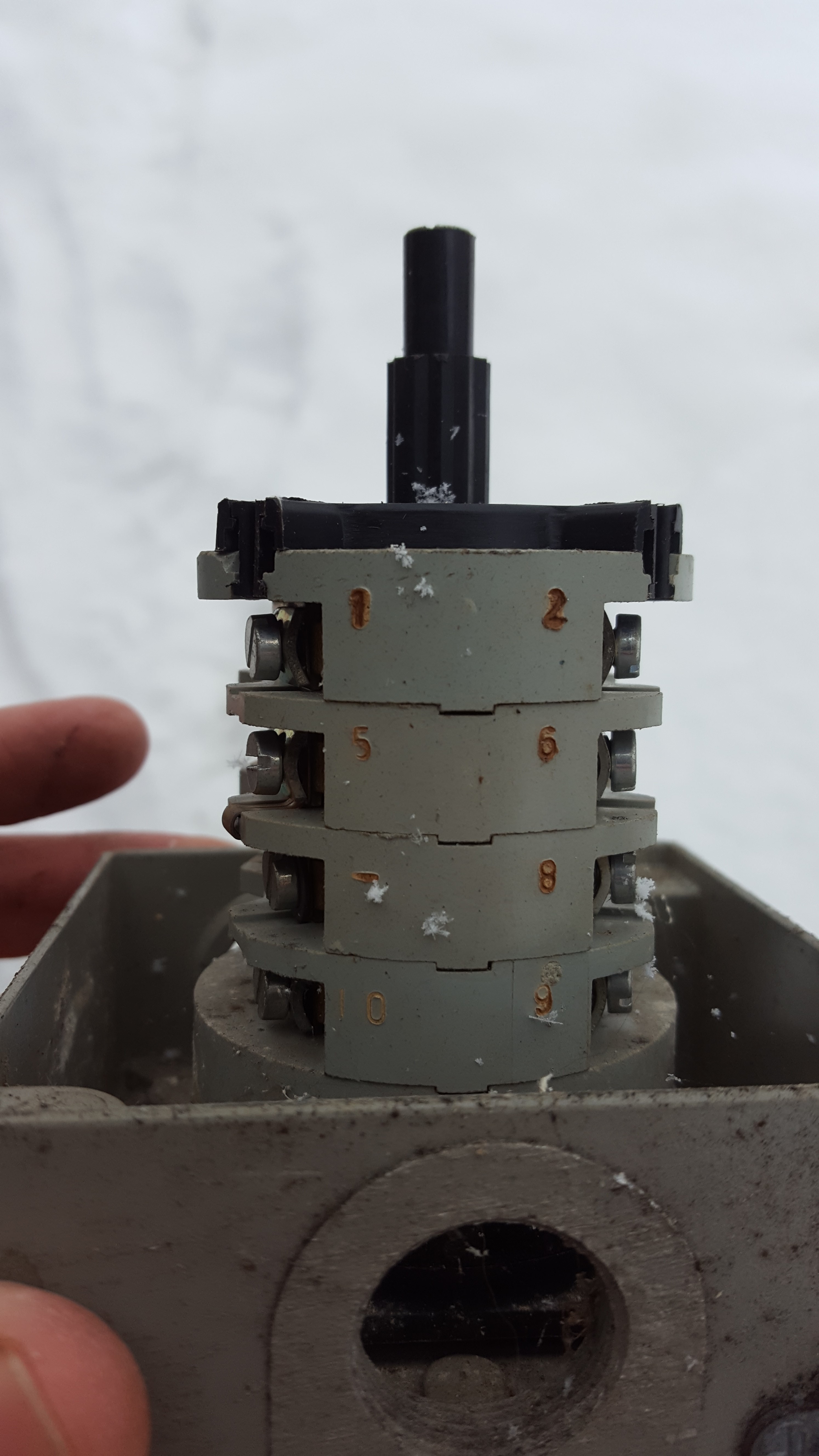

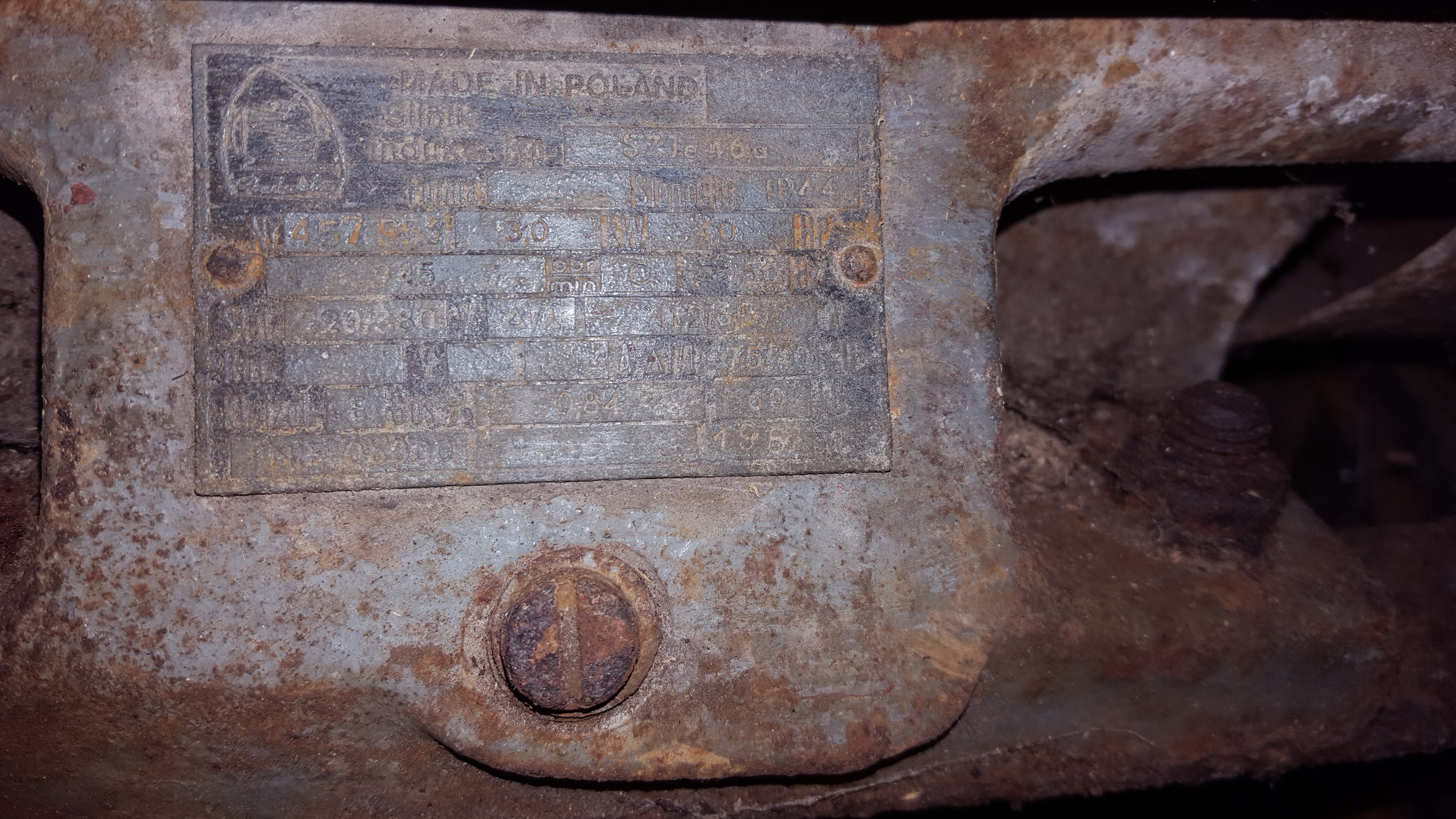

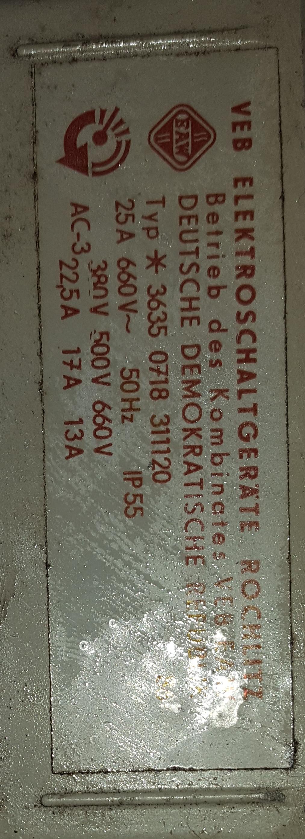

    I am a lucky buyer of 3-phase 3-phase motor.
    I also have a star triangle switch.

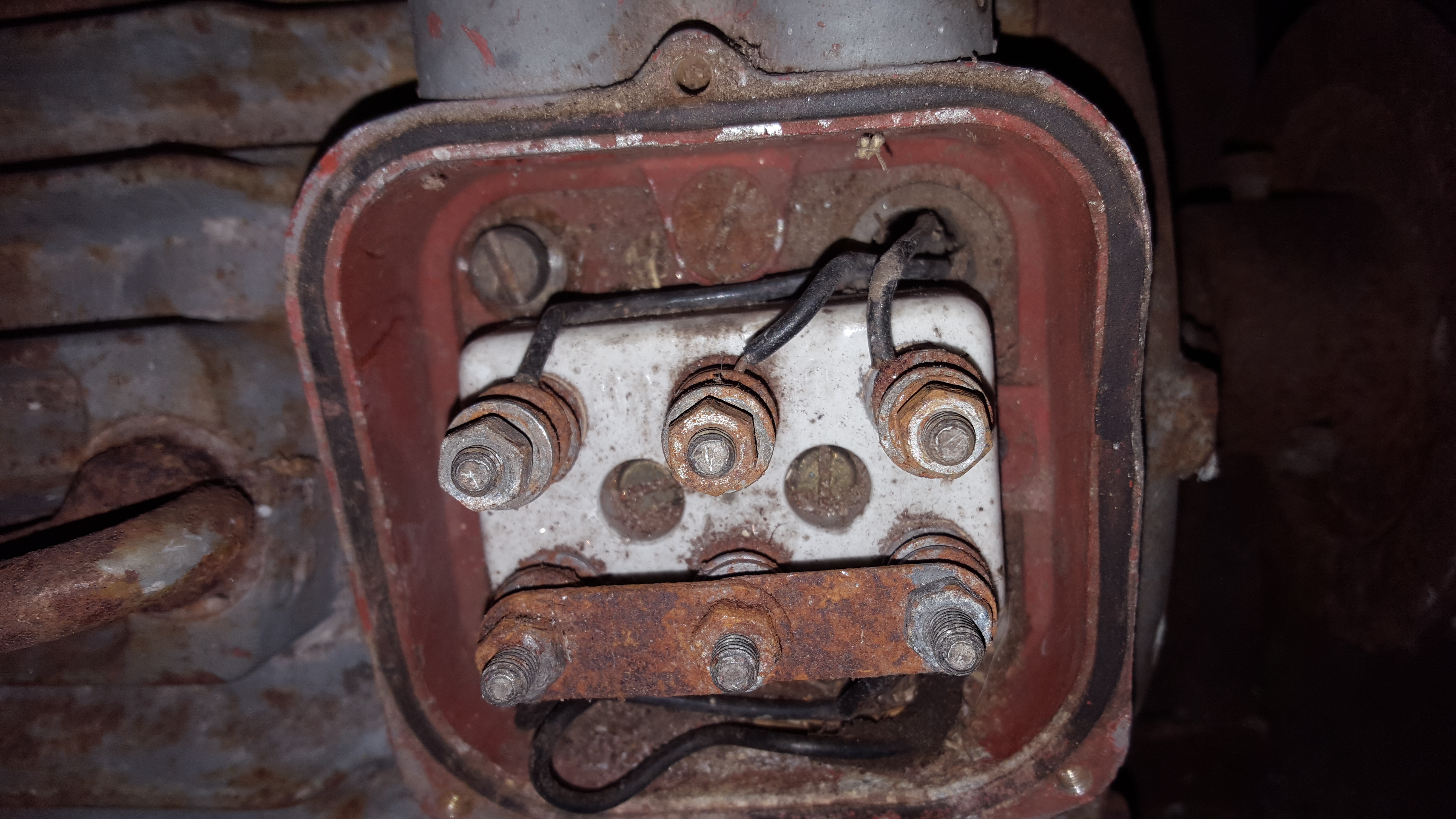

    Now I have a problem how to put it all together. Unfortunately, I can not find the diagrams for this engine or the circuit breaker. It looks like someone has already bridged the star on the engine. Is there any less power then?
    Paramters 3kW, 4HP 220/380, Y / ?
    I am enclosing one by one.
    Engine nameplate 3kW 3-Phase Motor Connection: Star-Delta Switch, Wiring Diagram, 220/380 Voltage, 4HP20170117_1..627.jpg (3.58 MB)You must be logged in to download this attachment.
    Connector on the engine - looks like bridging under the star 3kW 3-Phase Motor Connection: Star-Delta Switch, Wiring Diagram, 220/380 Voltage, 4HP20170117_1..728.jpg (7.24 MB)You must be logged in to download this attachment.

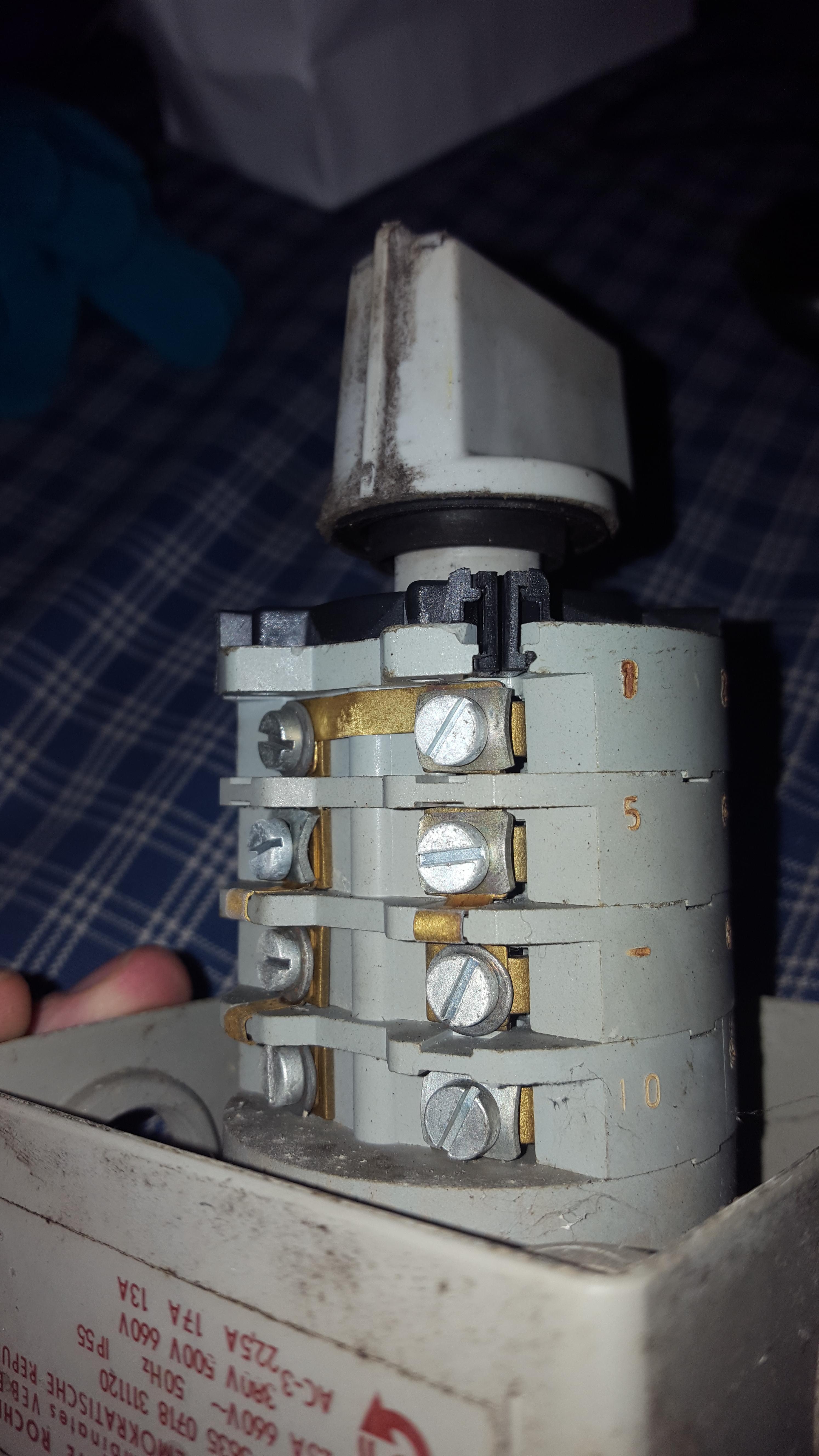

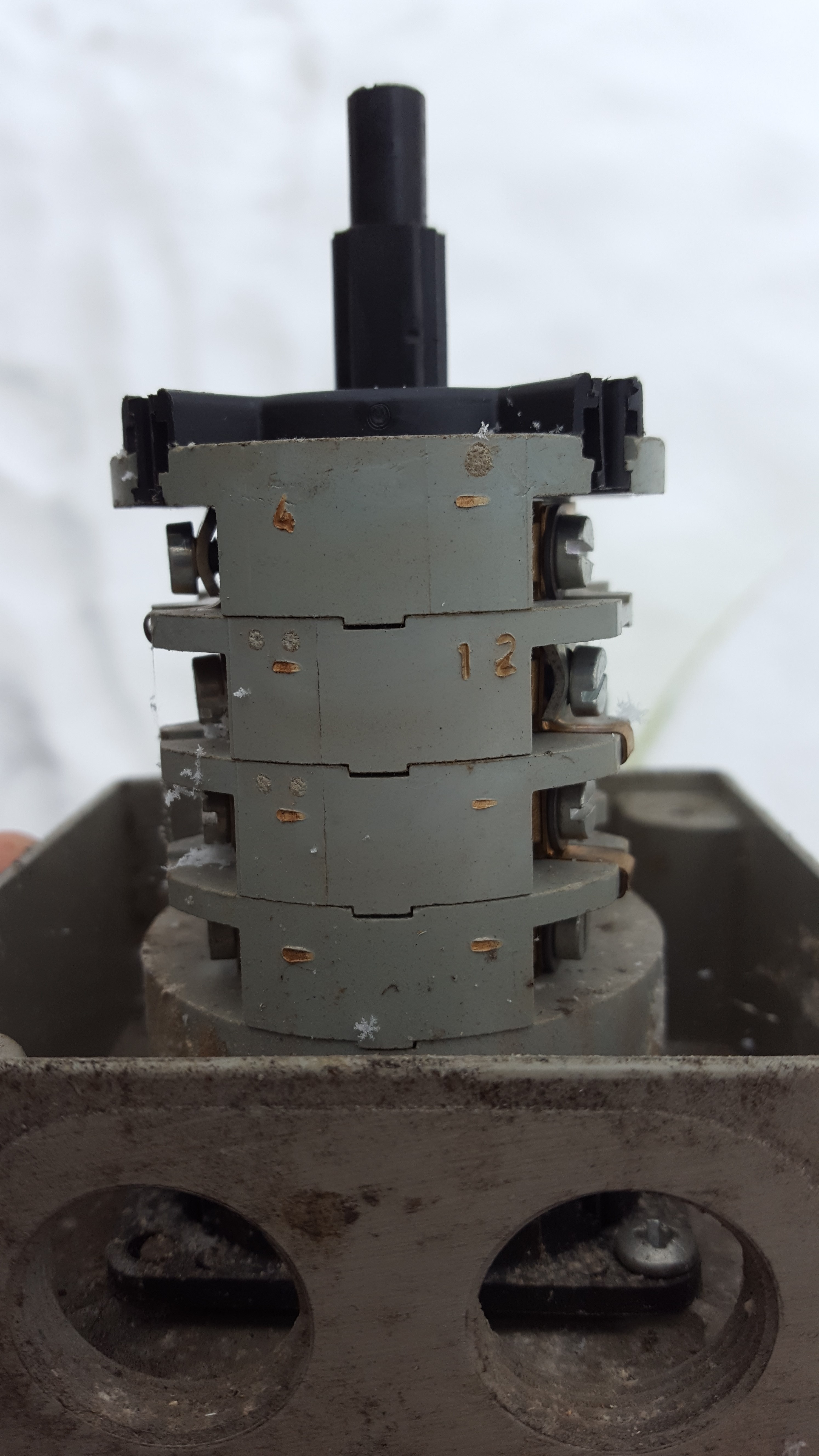

    Switch with 4 pages
    1. 3kW 3-Phase Motor Connection: Star-Delta Switch, Wiring Diagram, 220/380 Voltage, 4HP20170117_1..117.jpg (1.47 MB)You must be logged in to download this attachment.
    2. 3kW 3-Phase Motor Connection: Star-Delta Switch, Wiring Diagram, 220/380 Voltage, 4HP20170117_1..127.jpg (1.66 MB)You must be logged in to download this attachment.
    3. 3kW 3-Phase Motor Connection: Star-Delta Switch, Wiring Diagram, 220/380 Voltage, 4HP20170117_2..333.jpg (1.1 MB)You must be logged in to download this attachment.
    4. 3kW 3-Phase Motor Connection: Star-Delta Switch, Wiring Diagram, 220/380 Voltage, 4HP20170117_2..344.jpg (1.06 MB)You must be logged in to download this attachment.
    5. 3kW 3-Phase Motor Connection: Star-Delta Switch, Wiring Diagram, 220/380 Voltage, 4HP20170119_0..140.jpg (1.25 MB)You must be logged in to download this attachment.
    and a plate 3kW 3-Phase Motor Connection: Star-Delta Switch, Wiring Diagram, 220/380 Voltage, 4HP20170117_2..448.jpg (453.66 kB)You must be logged in to download this attachment.

    This motor is not suitable for operation with the Y / ? switch.
    As you have noticed, the order of switching on is Y and ?, and on the motor plate you have the opposite, i.e. ? / Y.
    Do you have such a poor installation that you can start the 3KW engine with start up?

    Buddy, this engine can not work in delta connection because you get it.
    In connecting to a triangle, the network layout would have to be 3 X 220V and you probably do not have one.

    There is a good chance that it will. But you would need to test this switch a bit - the description and appearance does not say anything.

    Just an ohmmeter or a battery with a bulb, and an analysis of which contacts are closed.
    I have a meter with a pipe ;) and I just measured the switch.
    On Y
    1 contains 2
    4 -> 8.12
    9 -> 10
    Na ?
    1-> 2.4
    5-> 8
    9-> 10.12
    I do not know where to connect L1, L2 and L3 now and where the engine ...
    Good night. Only ? (star :D ) Do you live in the US? As colleagues wrote, there is no possibility of this type of start-up (? / ?) in the classic European network (except perhaps Norway)
    Kurtka na wacia wrote:
    The switching order is determined by the star / delta switch and not the motor nameplate. I have never seen the triangle / star switch. This engine can not work in our Polish network connected in a triangle. It can work only on a star. The switch probably can be connected so that it serves as an on / off switch. Just an ohmmeter or a battery with a bulb, and an analysis of which contacts are closed.

    It's best if you take down all the bridges and measure again.
    Put a photo of the switch's top, please, because I'm still not telling me anything.
    If you want to use this switch only as 0-1 then I suggest: L1 to 1, L2 to 4, L3 to 9; and the motor: U1 to 2, V1 to 8, W1 to 10. It is necessary to block the possibility of switching to the third position because it will be short-circuited.

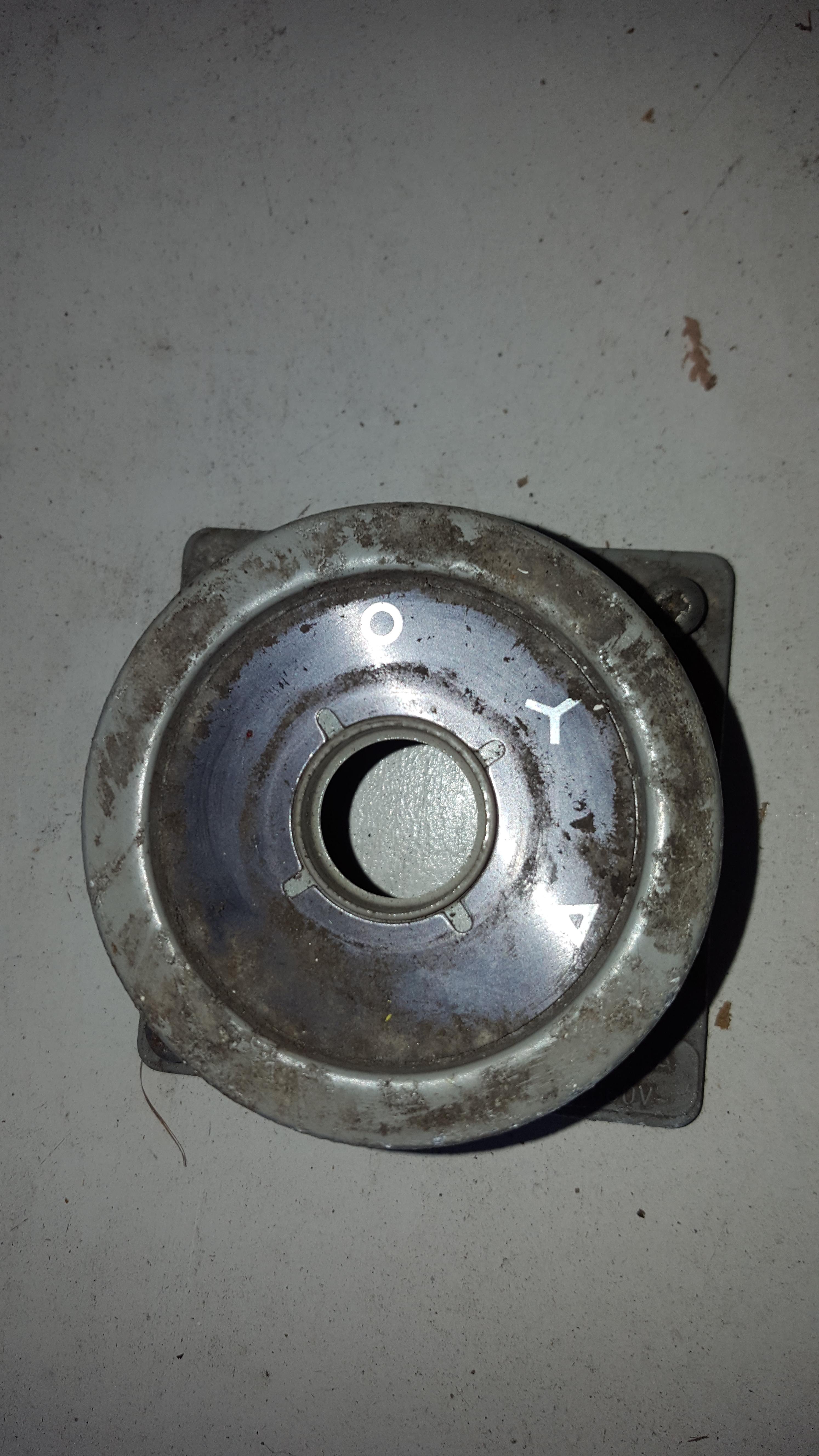

    Added - number 5 in the original post.

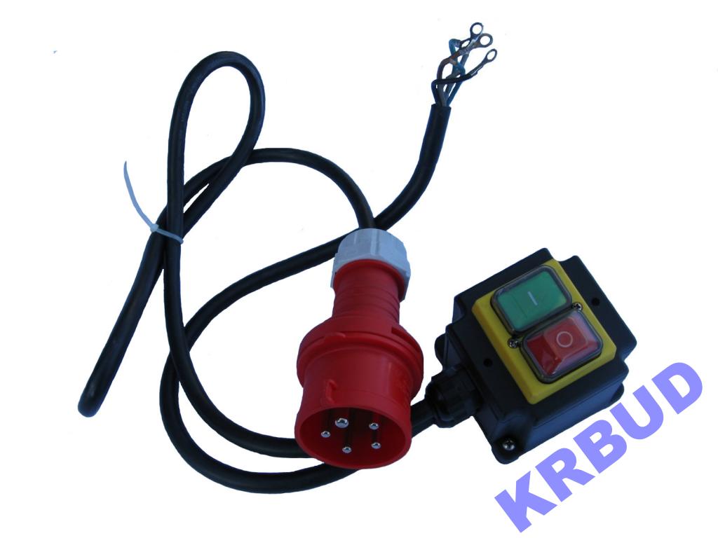

    If everything works well, maybe it will invest in something like:
    3kW 3-Phase Motor Connection: Star-Delta Switch, Wiring Diagram, 220/380 Voltage, 4HP6d382cc54f...a3249c.jpg (51.78 kB)You must be logged in to download this attachment.

    Just as the Colleagues wrote. This is not a switch to such an engine and you should not make any combinations, but buy a normal 0-I motor switch
    I close the subject.
