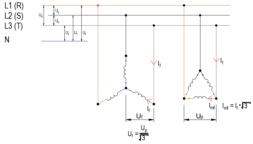

    So what does star-delta switching involve?
    It bindsit is, however, that the motor coil will work first in the star, which means that the voltage will be "given" one root of three lower than the rated voltage. This is done to start the motor "with a lower current" - to reduce the starting current. The delta switching (after starting) already supplies the rated voltage to the motor and allows for full power.
    Thus, the motor suitable for operation in a star-delta switch system, for a 230 / 400V network system will be a motor with the following parameters:
    400 (D) / 690 (Y)
    What is the current and voltage situation?
    Oh yes:
    Motor Power Supply: Star-Delta Connection - Voltage, Switching & Proper Usage (230/400/690 V)
    As you can see, in the case of star connection, the current and voltage are less by a root of three than the rated values for which the device is built.
    This will not cause the engine to overheat or burn the coils, it can only cause the "power shortage" effect and, consequently, the engine will not start.

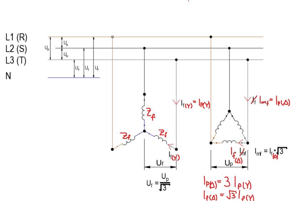

  • Correcting delta and star current relationships
    #2 19614806
    qrnick
    Posts: 33
    Rate: 13
    Overall a very useful analysis, especially for beginners.
    There was, however, a mistake in the last picture. I do not know what the subscripts of current I in the formula shown on the right should mean (whether mf means the machine phase or the phase-to-phase current), but for sure in a three-phase receiver connected in a triangle, the currents inside the triangle's circuit are root 3 times lower than the current wired (the one flowing from the source to the receiver).
    It is also worth noting that for the same supply voltage, the line current supplying the receiver for a system of the same impedance connected in a delta is 3 times greater than for a system of the same impedance values connected in a star, and in the case of the current flowing in individual phases, it is the root of 3 times larger in a triangular system in relation to the stellar system. Perhaps this was what the original drawing was about, but due to the fact that the markings were left in the layout on the left, some distinction would have been useful.

  • Delta line current is √3 times star current
    #3 19615810
    Aleksander_01
    Posts: 12832
    Help: 1167
    Rate: 3428
    What is this gibberish, the line current is never 3 times more, always by ?3.
    Maybe the sentence is poorly worded and it was about power.
  • Line current calculation for different motor connections
    #4 19617803
    qrnick
    Posts: 33
    Rate: 13
    Maybe instead of offending interlocutors, it is worth counting something.
    I am talking about the line current, not flowing through the motor phase with unchanged power supply and unchanged impedance of a single motor phase for different receiver phase connection systems.
    If a few simple calculations are too much effort, I refer you to "Collection of tasks on the basics of electric drive" Chodnikiewicz K., Moszczyński L., Oficyna Wydawnicza Politechniki Warszawskiej, Warsaw 2014 p. 127.

  • Star-delta connection reduces current by a factor of three
    #5 19617993
    Aleksander_01
    Posts: 12832
    Help: 1167
    Rate: 3428
    We misunderstood each other. If we treat the motor as a "black box" where the power supply is always 400 V (wire) and we only change the connection arrangement inside the "box", the current will decrease 3 times as much as possible.
    No calculations are needed here, it is known that when changing ? to ?, the power changes three times, and since the power supply of the box is of the same value, the current must change three times.
    I "figured it out" too much. :D
    Sorry and not angry, after all, the one who does nothing is wrong.
