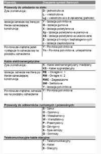

    kassans wrote:
    American measure of wires ;) I have not seen anyone using LGY in modeling, for example :)
    You are confusing the concept, buddy - LgY (or LggY or LggS) is the description of the type of wire (strand), and AWG is the size.
    kkknc wrote:
    currents from 136mW to 220mW
    Even less, the specific resistance for AWG20 is 34.6 ? / 1000m.
