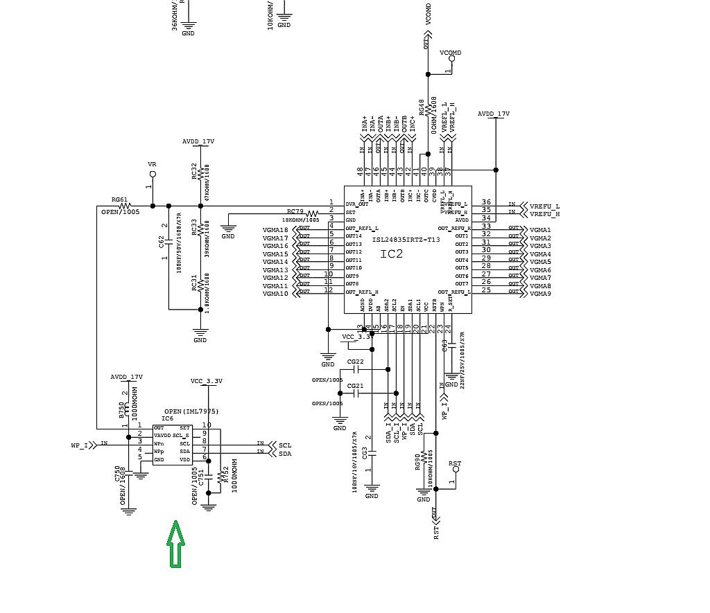

    Someone will provide some materials or I only have to use the descriptions of individual elements.

    I can't get anything on
    i7975, i7822, BKX.

    ( BKP , BKX)
    - BKX to MAX9650
    - BKP to MAX15032ATA
    iML7822 Link
    i7822 = iML7822 2-ch VCOM; Supply Voltage: 5V~20V; Ipeak= 400mA, Irms=45mA, SR=20V/us
    czyli dwa operacyjne
    i7822 = LM8262 =HX8902 = EL5211
    iML7975 (iML7975 7bit DVR with I2C interface; logic voltage: 2.25V(R)/2.6V(W)~4V; Analog voltage: 4.5V~18V; 10-TDFN)

    T-CON Samsung S100FAPC2LV0-3 (BN98-03131A )
    IC590 S524A40X20-RC70
    IC1 LPFC041T0A-Q1
    IC2 INAISL24835IRTZ-T13
    IC4 SM4109
    IC6 IML7975
    ICD2 FDC658AP
    Samsung LE32C530 - F60MB4C2LV0.6 Logic Diagram & Descriptions of Individual Elements
    SM T-con t370xw02-vf-bn07-00642a Link

    Thanks a lot, you have brought me a little closer and I will not wander in the dark.
