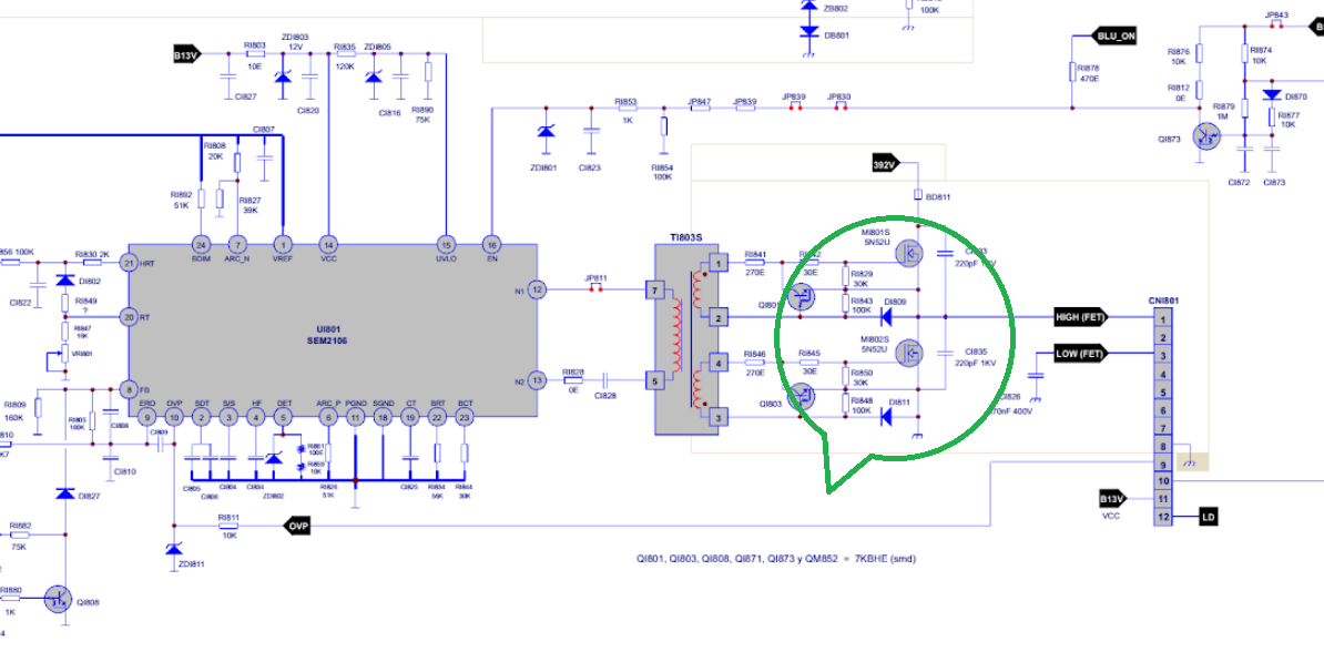

    Specifically, I'm interested in what works in controlling the MI801S and MI802S transistors. Exactly QQ1848 and Q1801 marked 7KCPY, D1809 marked MU, the rest illegible. I also don't know what the value of R1842 is. That's why I'm asking for a diagram, although as I read, it's probably unattainable...

    BN44-00468A
    • CIRCUITO BN44-00438A - 00468A F77U.pdf (380.1 KB) You must be logged in to download this attachment.

    Thanks for the diagram. Now I know what are transistors but still don't know about D1809. May I use 1N4148? I'm going to replace also SEM2106. Best regards.

    PSU IC801S (6?10N40 ) i.e. =SPC7011F+ field KF10N60NF
    MUR460 diode
    [Solved] Samsung LE32E420 - BN44-00468A element values (or diagram)
    :idea: or option
    BN44 00438A / BN44 00468A almost the same

    While doing the inventory, such a board came across and because I had a problem with getting these transistors on the stock market (there were other digital ones, but what kind of resistors do mine have?) I put on the one I found...
