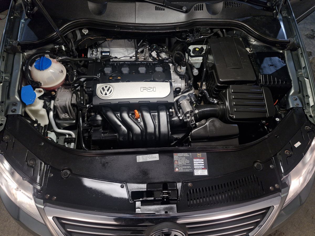

    #16 21399278
    PIMP_MY_RIDE-P1
    Posts: 149
    Rate: 38
    Fellow Sullivan and fellow mrn92, I see that real professionals are in short supply and the rest are throwing diagnoses out of a hat , "engine overhaul" "wiping the guides" , "timing gear", and the exchangers know, coil, plugs, cables, battery, alternator....
    In case someone has such a problem I am happy to help, please feel free to :) FSI with the problem of uneven operation at idle as if it does not work on 2 cylinders come to me a few units in a month and everyone leaves the next day a working car, shocked that it cost so cheap in comparison to what other "professionals" predicted.
    In order to exhaust and close the topic, I will also say what is the cause of the fault (additional air mass in the intake, and poorly controlled camshaft phasing - wash the engine thoroughly, remove these two problems and the FSI works like new.
    FSI car engine in the engine bay of a Volkswagen vehicle. from the showroom :)
    Greetings from sunny Boruja Kościelna
