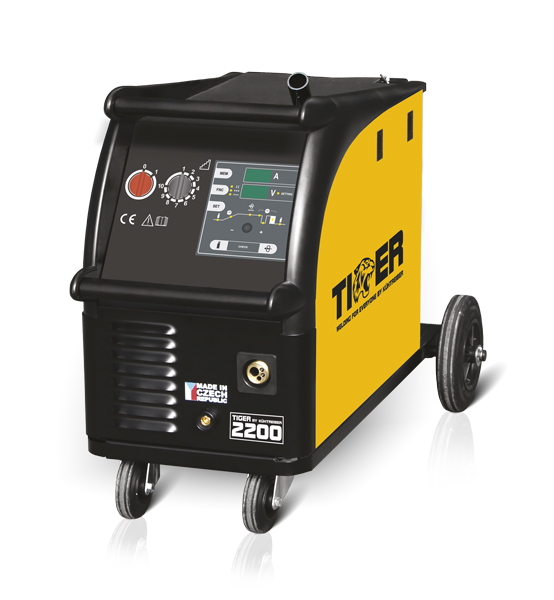

    TIGER 2200 4x4 is already available in the PROCESSOR version with display.

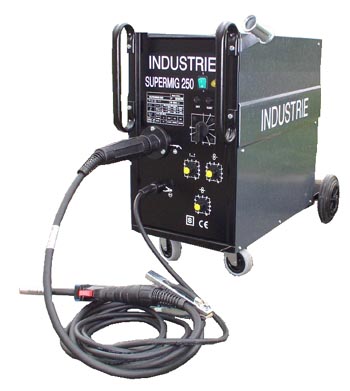

    I have an Industrie Supermig 250, such as in the picture for 10 years or so (yesterday I spilled his 10th summer: p) and I'm not happy with this equipment, and I'm not using it amateurly. Even for max. the current can be welded for a long time. My dad at work had Industrie 350 and welded it every day from morning to evening and for seven years there was no breakdown, I still do not know because my dad changed his job. The disadvantage of this migomatu are the slightly faint circles (after an even floor in the hall will be ok, but on potholes can be damaged) and that it has 2 rollers, not 4.
    The big advantage is that there is 3 phase in it. MIG Welder Comparison: Magnum Supermig 250S 4x4 vs Tiger 2200 Standard 4x4 for PLN 3,000 Budget

    #6 16275894
    supchem
    Level 21  
    Posts: 1070
    Help: 31
    Rate: 211
    I have this older version, like the one I added. The one from your link is probably newer, I see that it has some displays, etc. With this model I did not deal so I will not talk about durability but I am of the opinion that it is rather unnecessary, in addition, this migoma has a gradual regulation of current and there is no regulation voltage so that the display shows something is not very useful since you can not change it anyway. If there was a smooth regulation of the current it's different. Take also into account that they are not like looking at some of the cheaper migomatów, which means the most important elements such as transformer, feeder can be made reliably, and on "bajery" they could save so they can be emergency. Rather, I would take this older one, although in a newer version it is 4x4. It is better to weld on a longer or bent cord.
