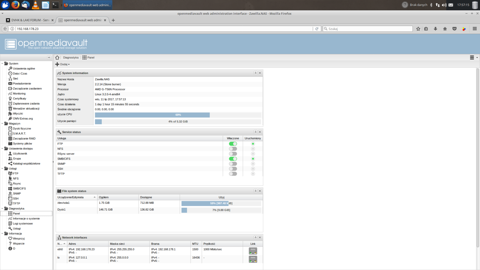

  • #3 16581763
    trent_z
    Posts: 74
    HP T610 more info in the picture - it works as a disk server - watching, recording from a sat-lan decoder. File transfer at 50 - 60 Mbit / s via lan 1 Gbit / s.
    Home US - Banana Pi vs Dell FX160 Terminal for NAS, Energy Efficiency, DLNA, HDMI, RAID, Domoticz
    I plan to insert 2 x 1 TB sata disk, i.e. 2 TB in total.
    System uploaded on IDE SSD 2 GB drive
