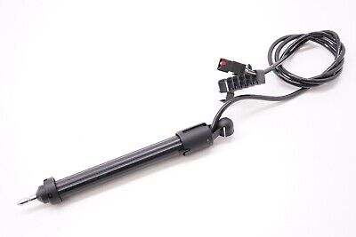

    #18 20398767
    Marcin_ca1
    Level 22  
    Posts: 702
    Help: 14
    Rate: 278
    Hello, I have a problem in a Mercedes r class 251, the hatch opens but does not close. I fixed the safety seals, but the SD shows the error of the position sensor, hatch tilt, where is this sensor? I looked on the net it looks like an actuator with a cable. At the top, at the hinges, on the left, there is a spring and a hydraulic cylinder, and on the right, only a spring, but I noticed that one ball is free, should this sensor be there? In sd parameters, the position of the flap remains at 6, it does not change
    • Mercedes W164 ML420 Tailgate Opening Functions, Issue with Closing: Position Sensors & Diagnostics s-l400.jpg (8.36 KB) You must be logged in to download this attachment.
  • #19 20402297
    _Megamax_
    Posts: 236
    Help: 29
    Rate: 131
    Right hinge, under the ceiling.
