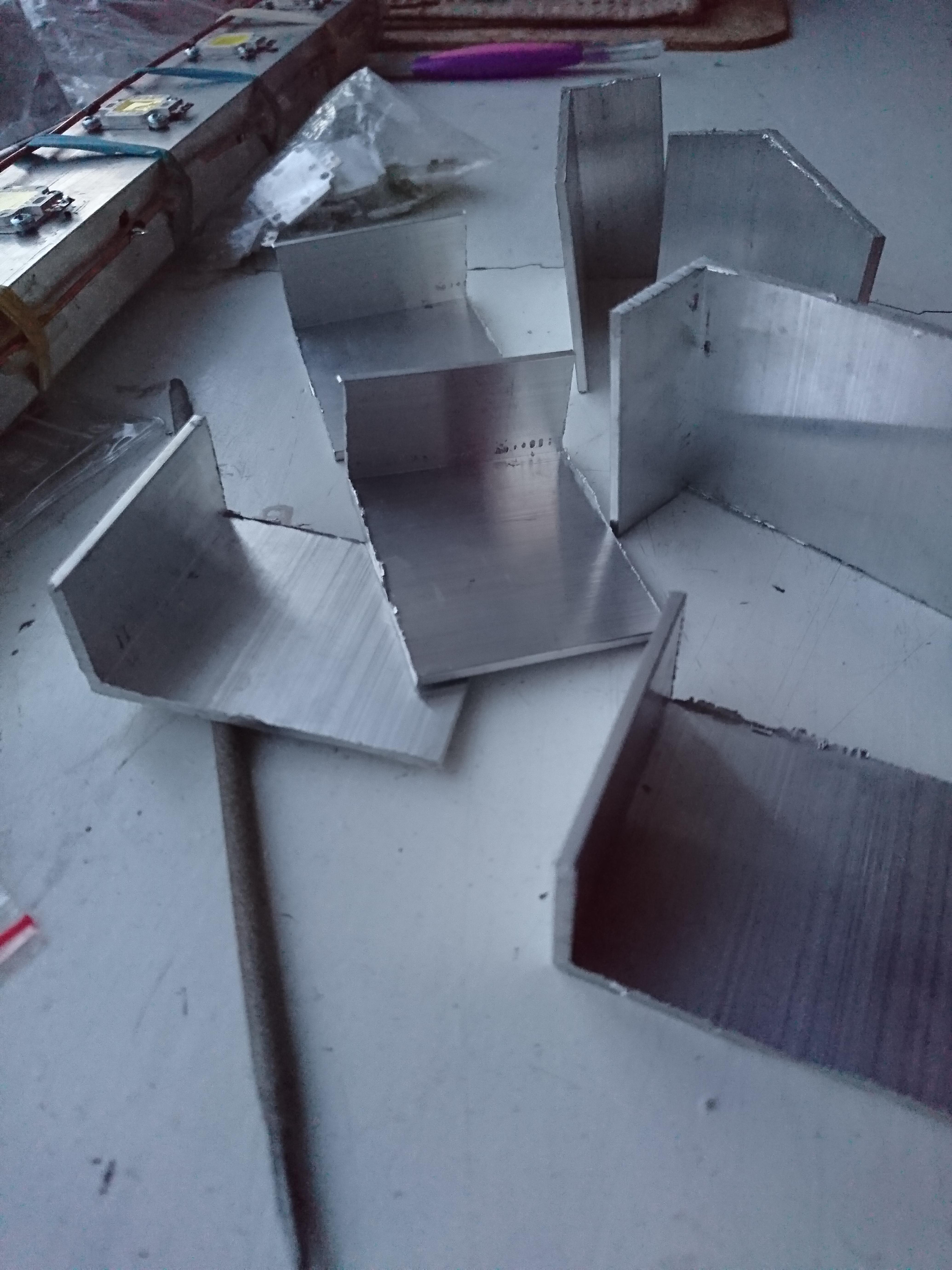

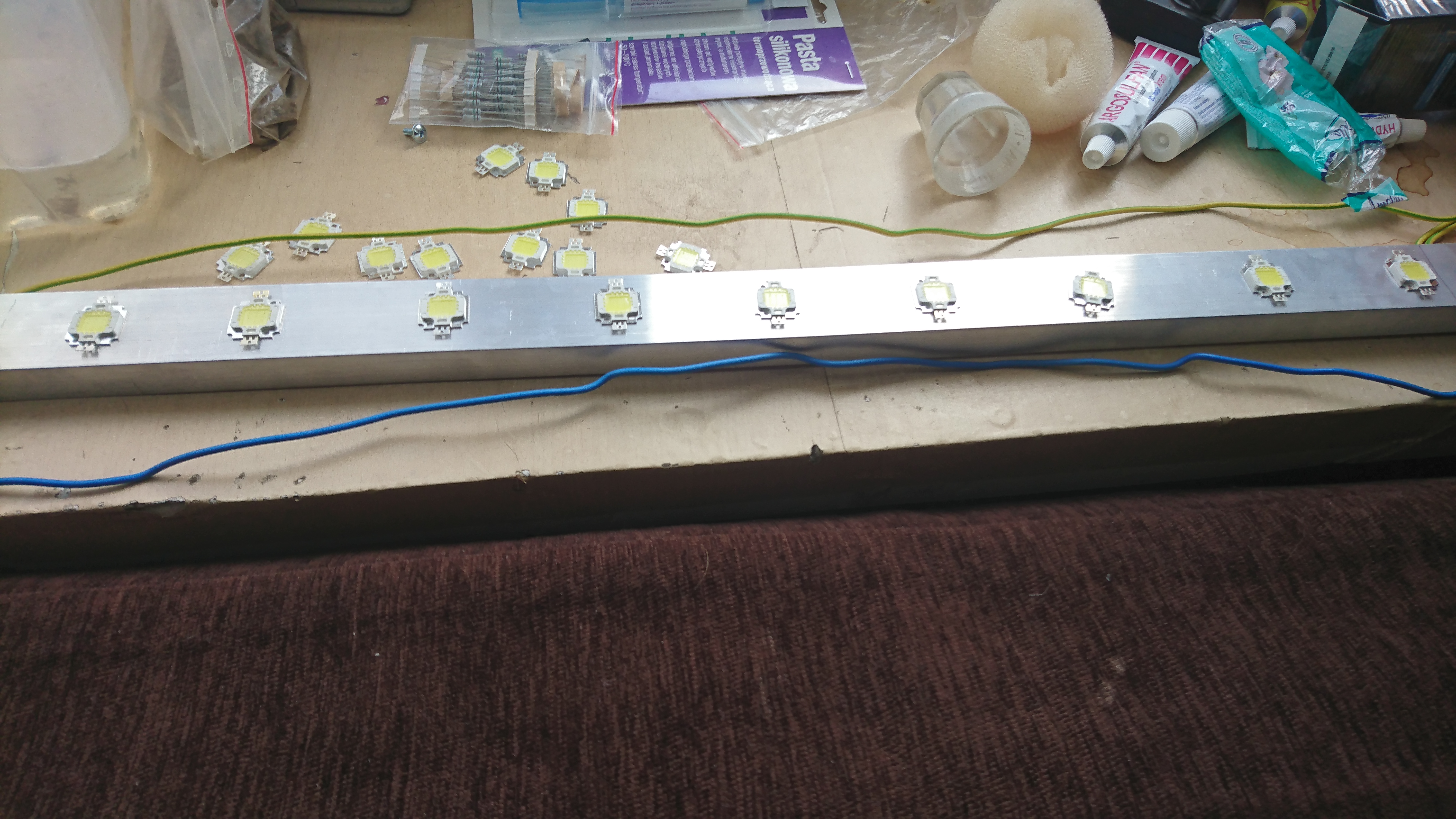

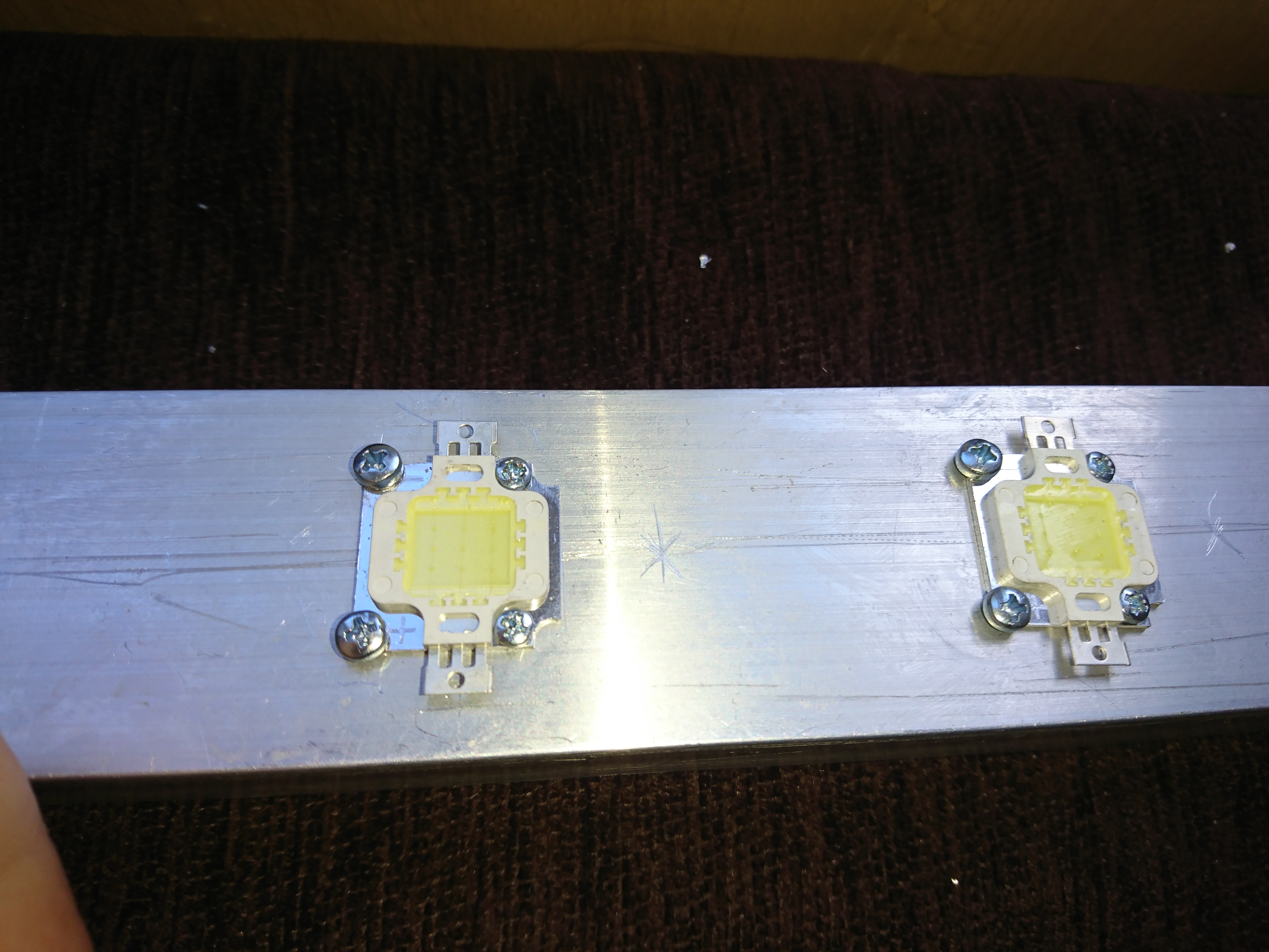

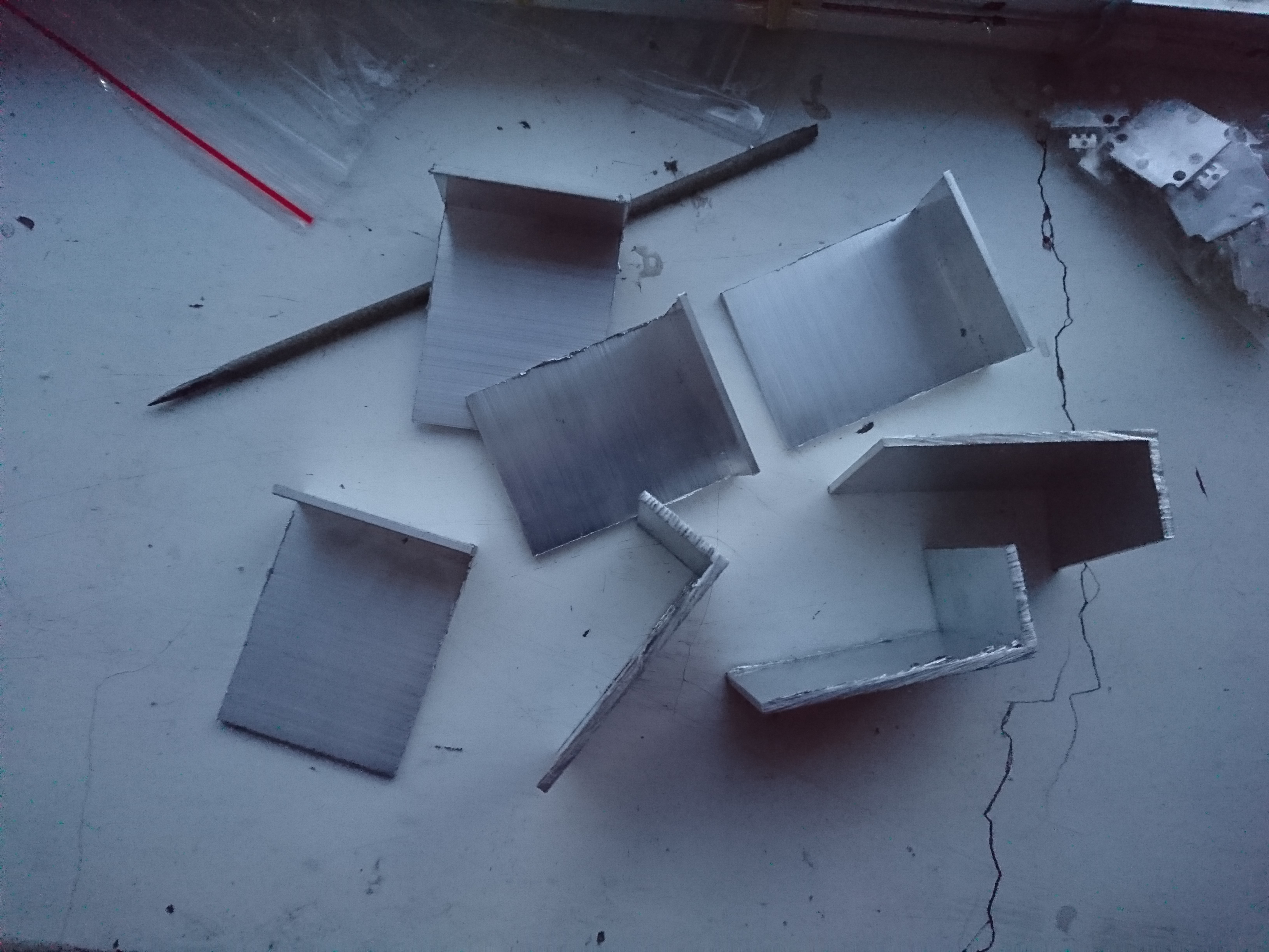

    Hello. For some time I have been struggling with the problem of applying cooling to the COB diode. I am in the process of designing a 10x10w LED strip, i.e. 100W one strip. The problem is that it warms up mercilessly, and I don't know how to choose a heat sink. I have a 3mm profiled aluminum strip, 4cm wide.
    How to choose a heat sink and which one? Greetings Piotr.
    • 10W COB Diodes: Choosing the Right Heat Sink for 100W LED Strip - Aluminum Profile Options DSC_0177.JPG (1.14 MB) You must be logged in to download this attachment.
    • 10W COB Diodes: Choosing the Right Heat Sink for 100W LED Strip - Aluminum Profile Options DSC_0189.JPG (1.05 MB) You must be logged in to download this attachment.
    • 10W COB Diodes: Choosing the Right Heat Sink for 100W LED Strip - Aluminum Profile Options DSC_0181.JPG (825.9 KB) You must be logged in to download this attachment.
    • 10W COB Diodes: Choosing the Right Heat Sink for 100W LED Strip - Aluminum Profile Options DSC_0191.JPG (5.85 MB) You must be logged in to download this attachment.
    Do not exceed the rated current of the diodes?
    "Strip" is a channel bar? Because a 40mm flat bar for a zicher is not enough. I advise you to look for typical radiator profiles.

    I have 4 pieces of 3W on a similar length C-profile - I think it is just for them. You want to give it 10x10W ... Definitely not enough.

    Radiator profiles with a larger surface - with ribs, you can buy by the meter, you only need to know the length at which you want to fit these diodes.
    The more LEDs on a smaller surface, the better the heat sink must be (more ribs, and therefore the lower the thermal resistance).

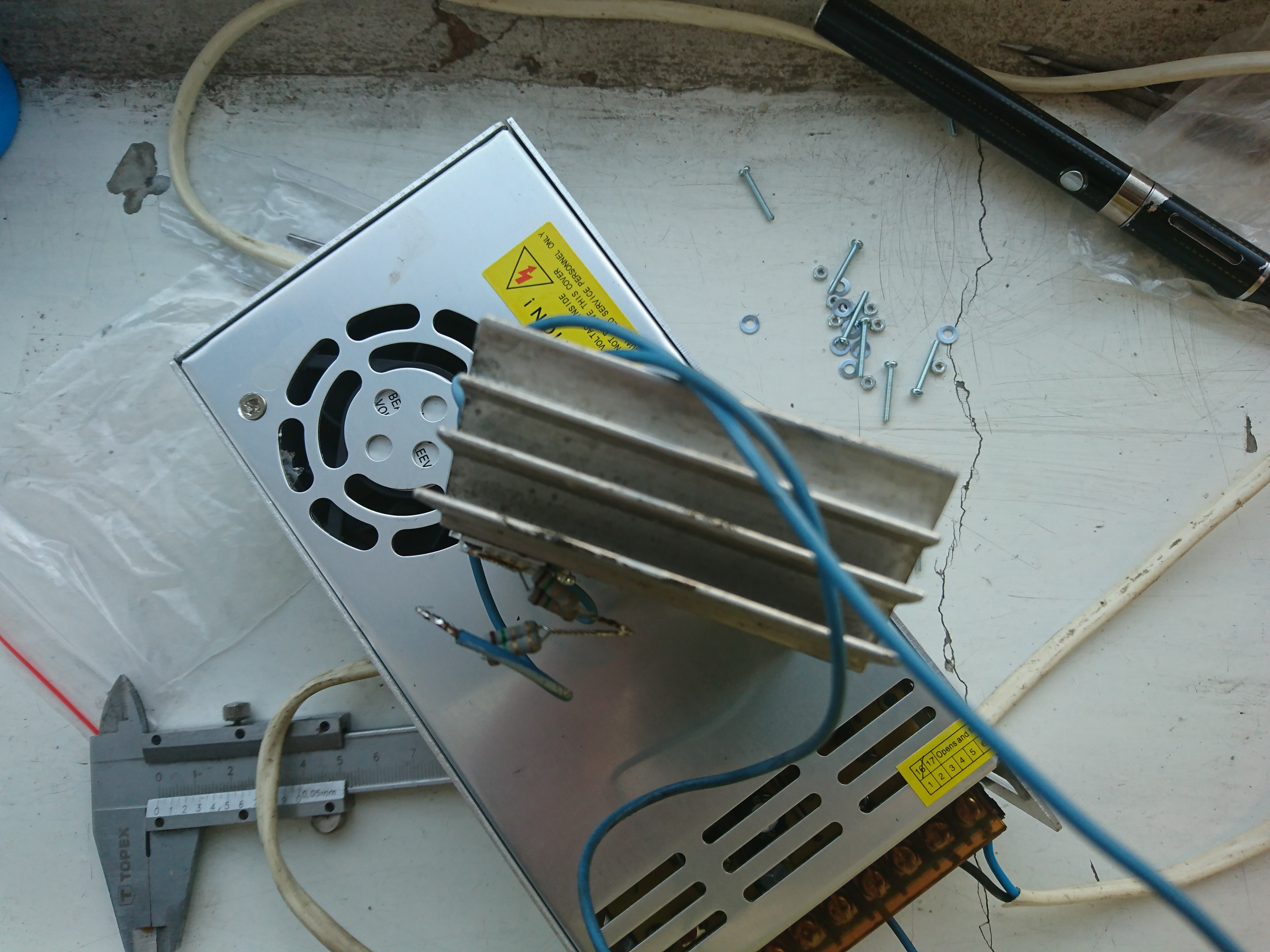

    smigas wrote:
    You will recommend a typical heat sink for cob 10w I have in the plan as I gave, I just don't know where and what heat sink to look for
    On Allegro, look for "ALUMINUM RADIATOR 100X100 MM 10X10 CM FOR LED". Try 2xCOB10W there and check if you can add a third one.

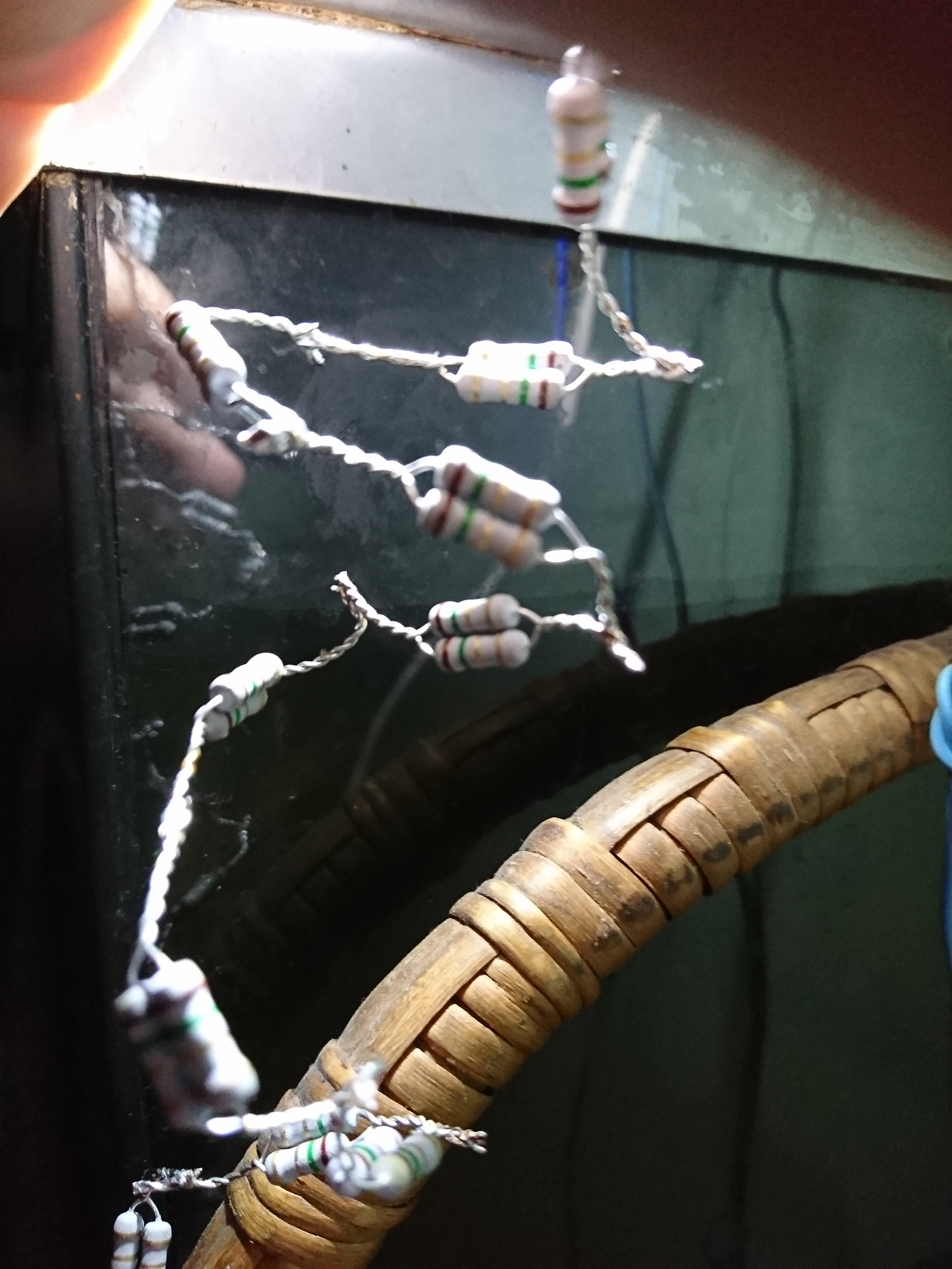

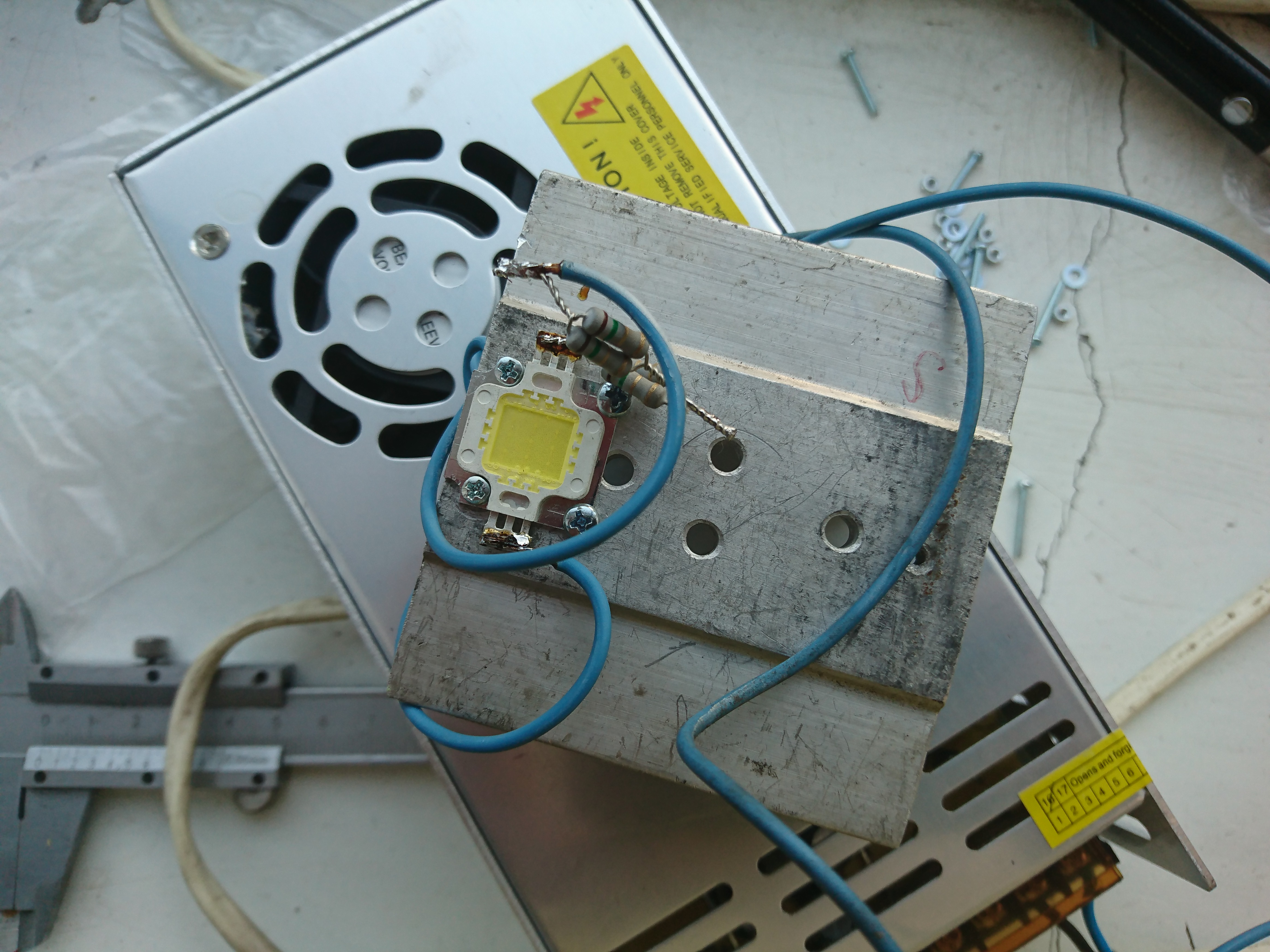

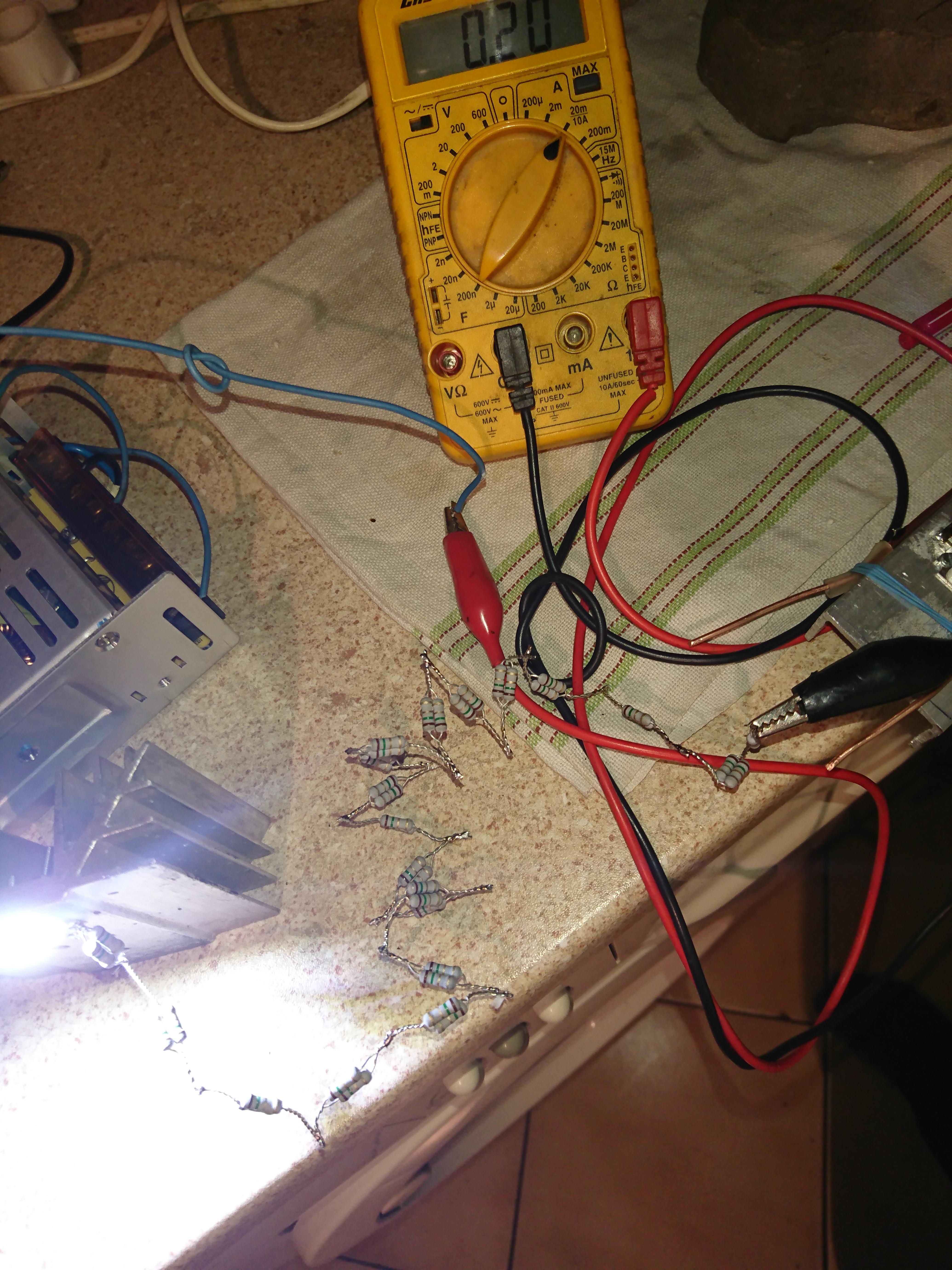

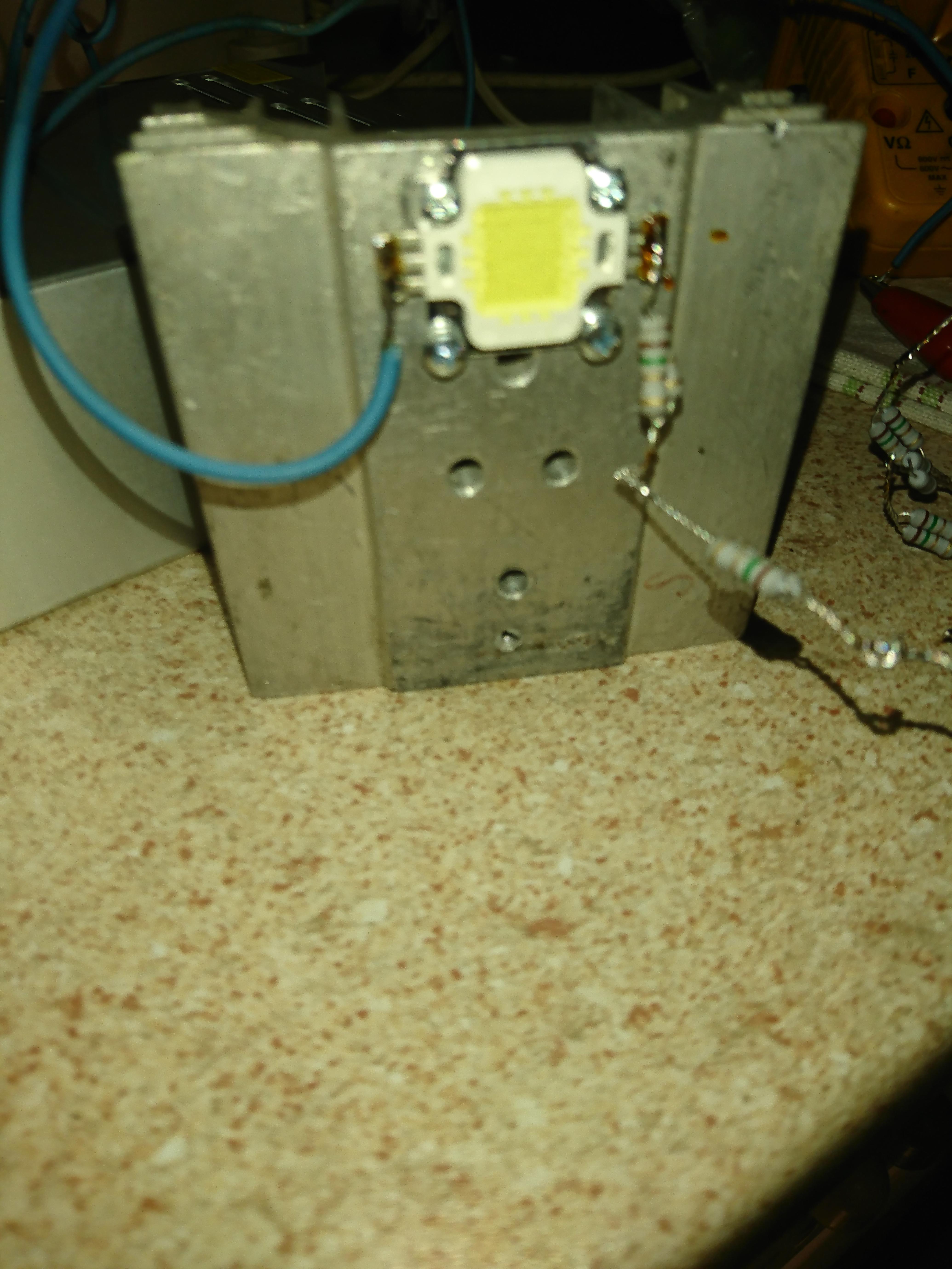

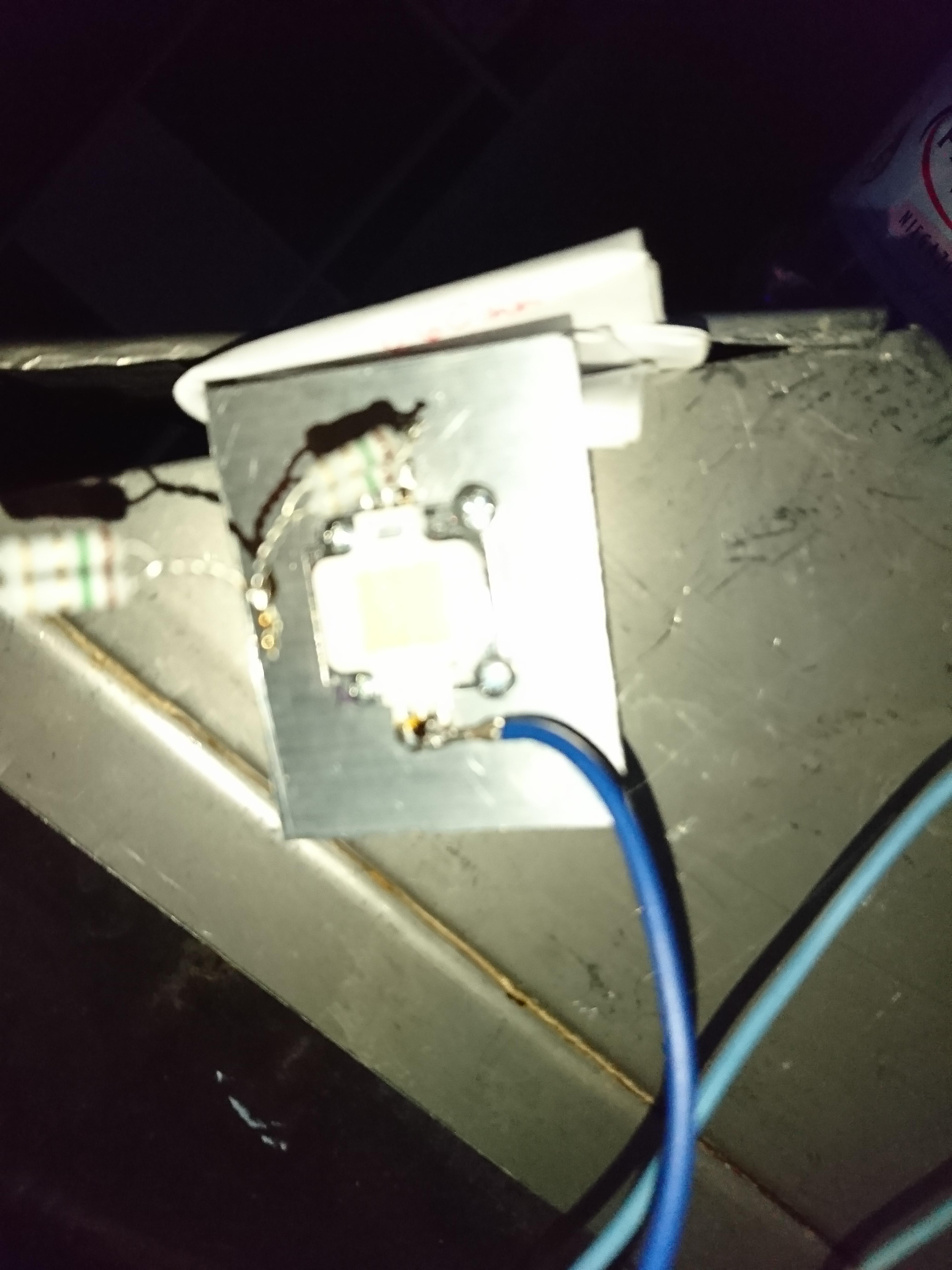

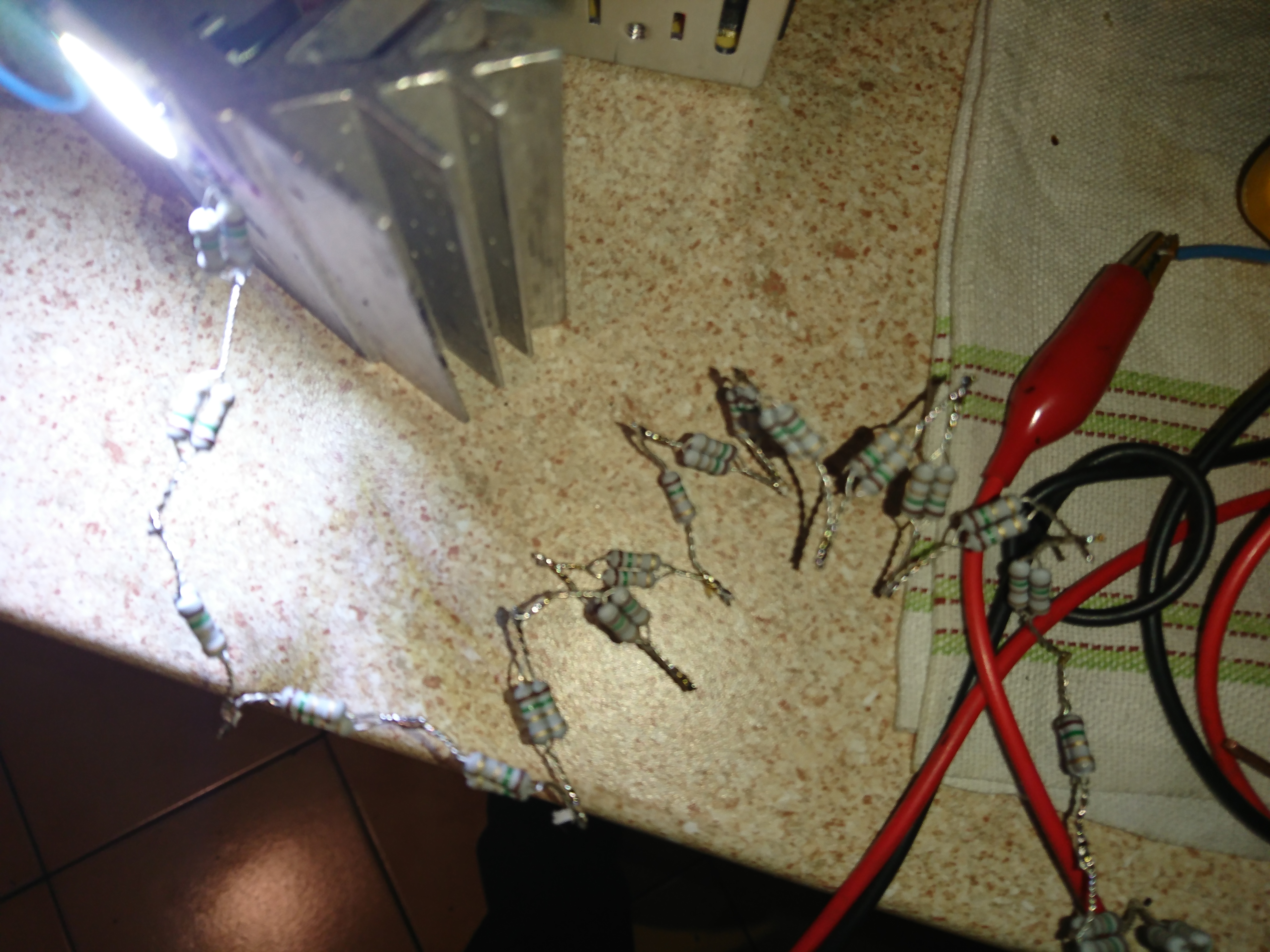

    Is it normal that the cob diode heats up about 70
    Degrees from the ordination side. The back part of the heat sink radiates nice heat and the heat sink's heat constant is 40 degrees
    The cob diode is a type like the picture on the diode I limit 4ohm 4w
    Please help
    • 10W COB Diodes: Choosing the Right Heat Sink for 100W LED Strip - Aluminum Profile Options DSC_0397.JPG (10.91 MB) You must be logged in to download this attachment.

    smigas wrote:
    from the side of ordination
    LED is not an Easter egg.
    70 * C is a bit much. The higher the temperature, the shorter the service life. Besides - you can't connect diodes in series? You can't use a DC power supply instead of resistors?
    You've probably chosen the least favorable combination.

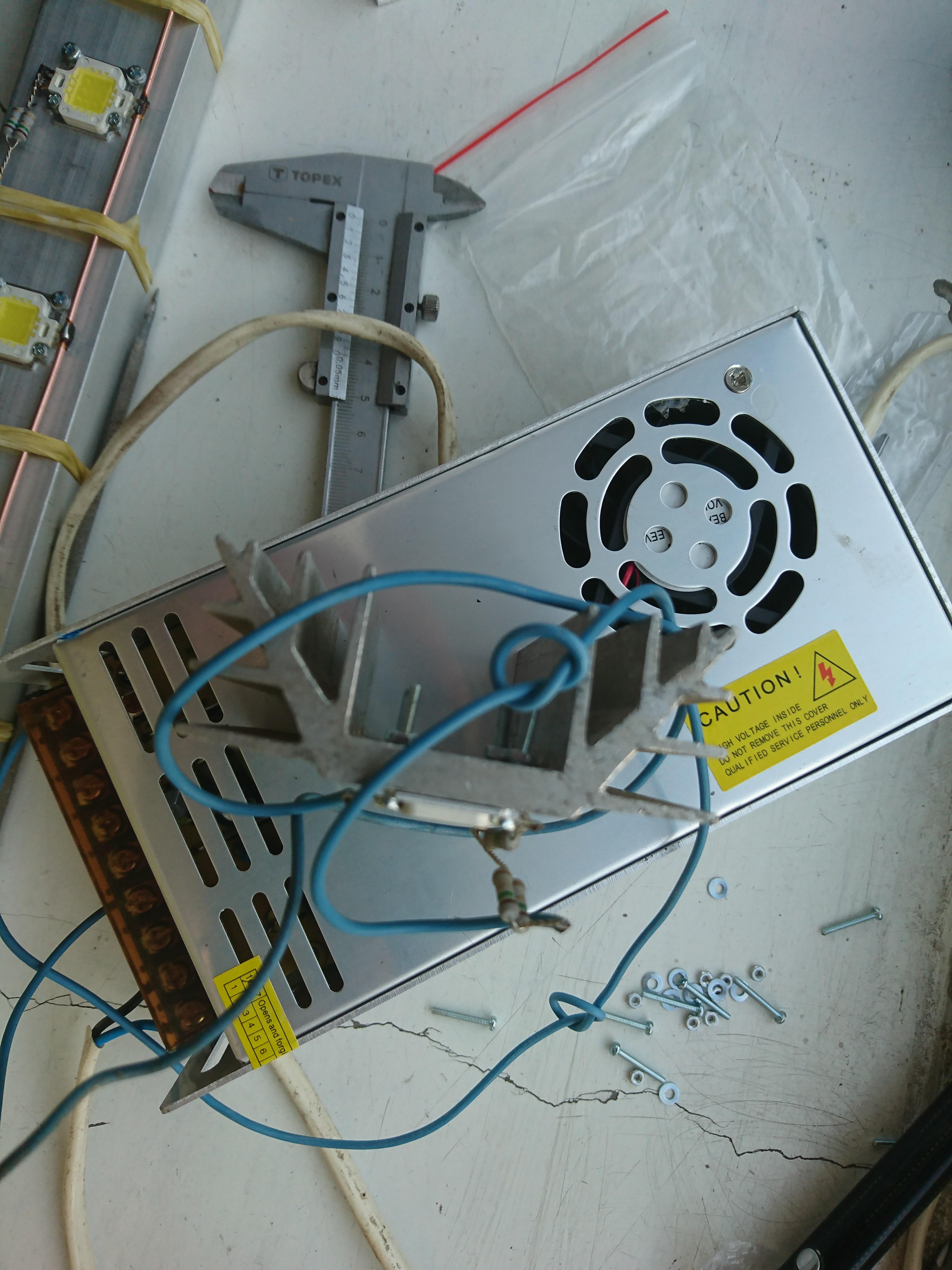

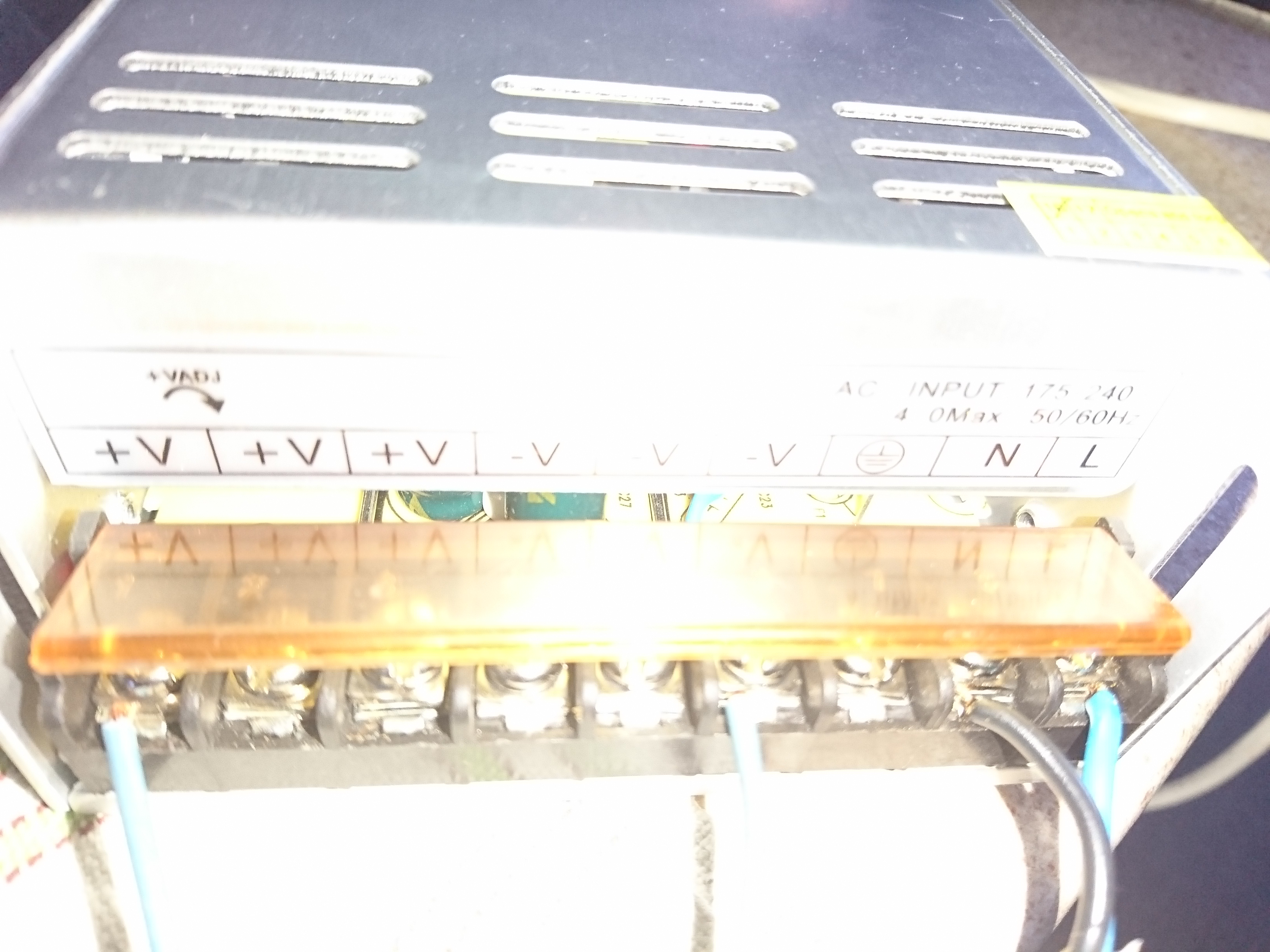

    I have the power supply as in the first post, it was 12 V impulse. And the LEDs in each combination are very warm, there is an option to reduce the heat sink heat because the condition is unbearable. IN

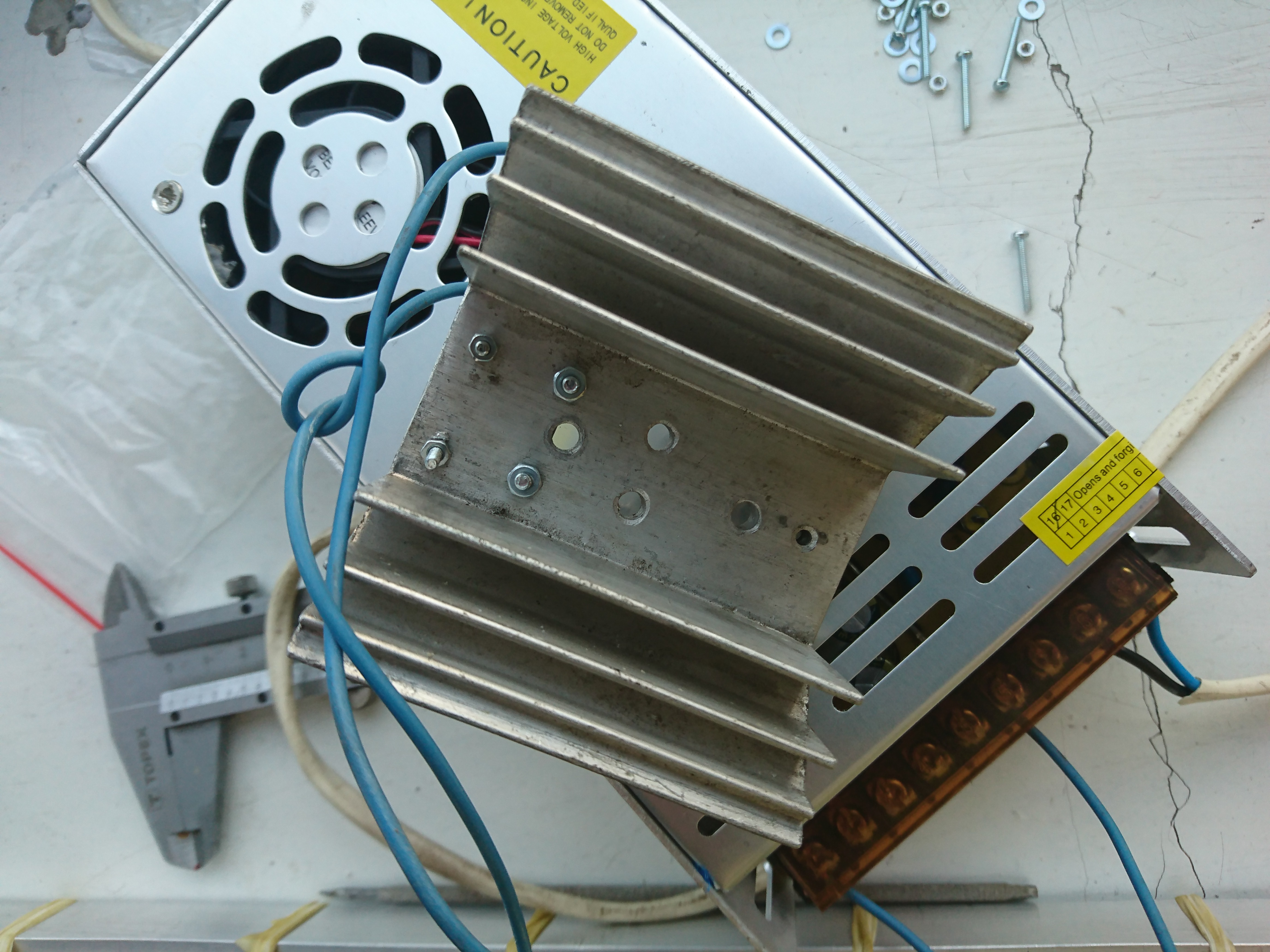

    smigas
    Posts: 97
    Even with a cube type heat sink, the diode gives 10 minutes, the diode is on the heatsink as in the attachment. Maybe the current flowing through the diode is too high, how to limit the currents in my case.? Where to find and how to choose a current limiting driver.
    This is a normal 12V power supply, not a LED power source.

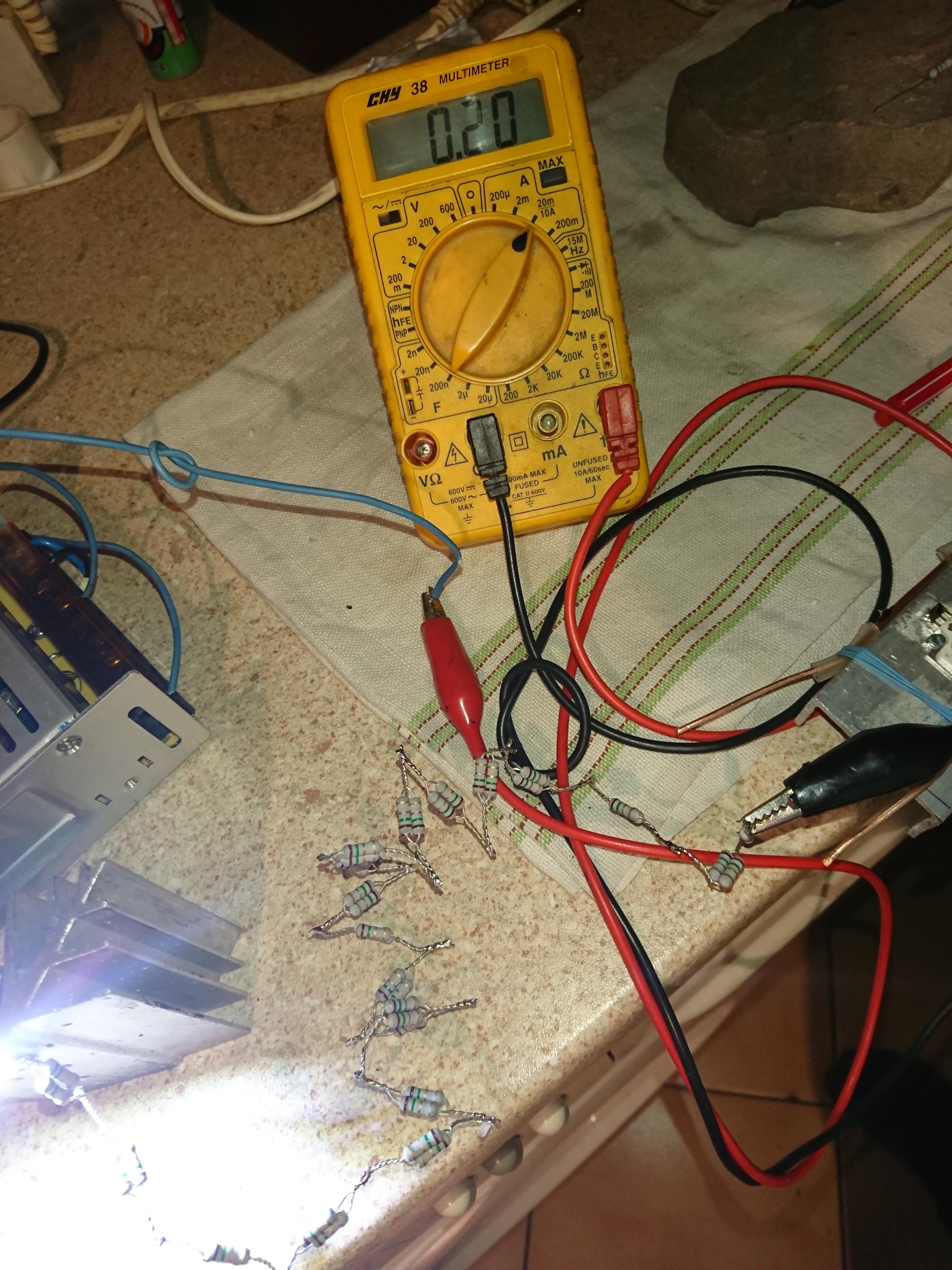

    smigas wrote:
    Maybe the current through the diode is too big
    Measure the voltage at the diode and the current that flows through it. The power that comes out of the calculation must be separated and somehow it should be discharged from the LED structure into the environment. It's so simplified. It is not possible that the LEDs do not heat up at such power ...

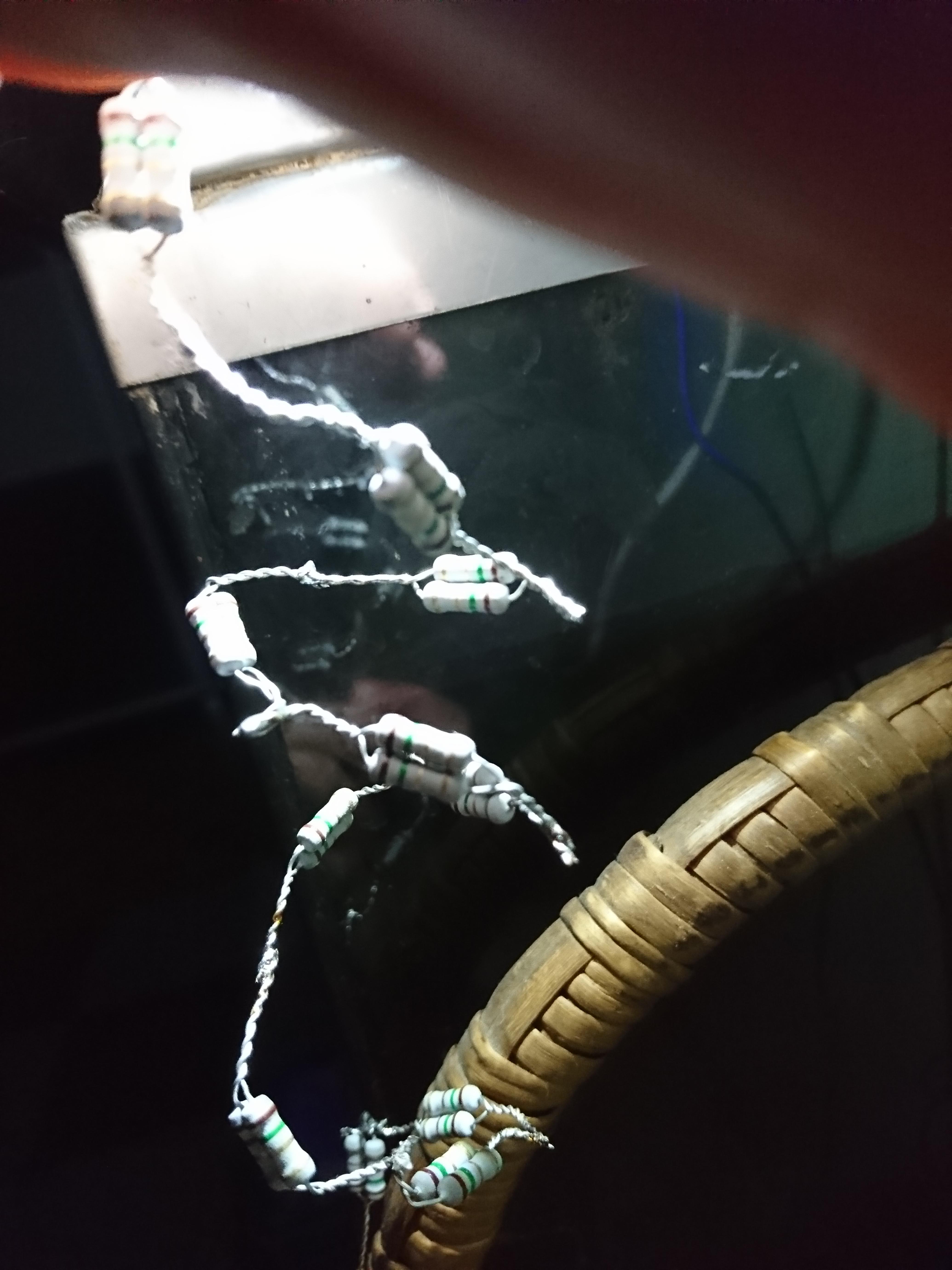

  • #14 16374012
    smigas
    Posts: 97

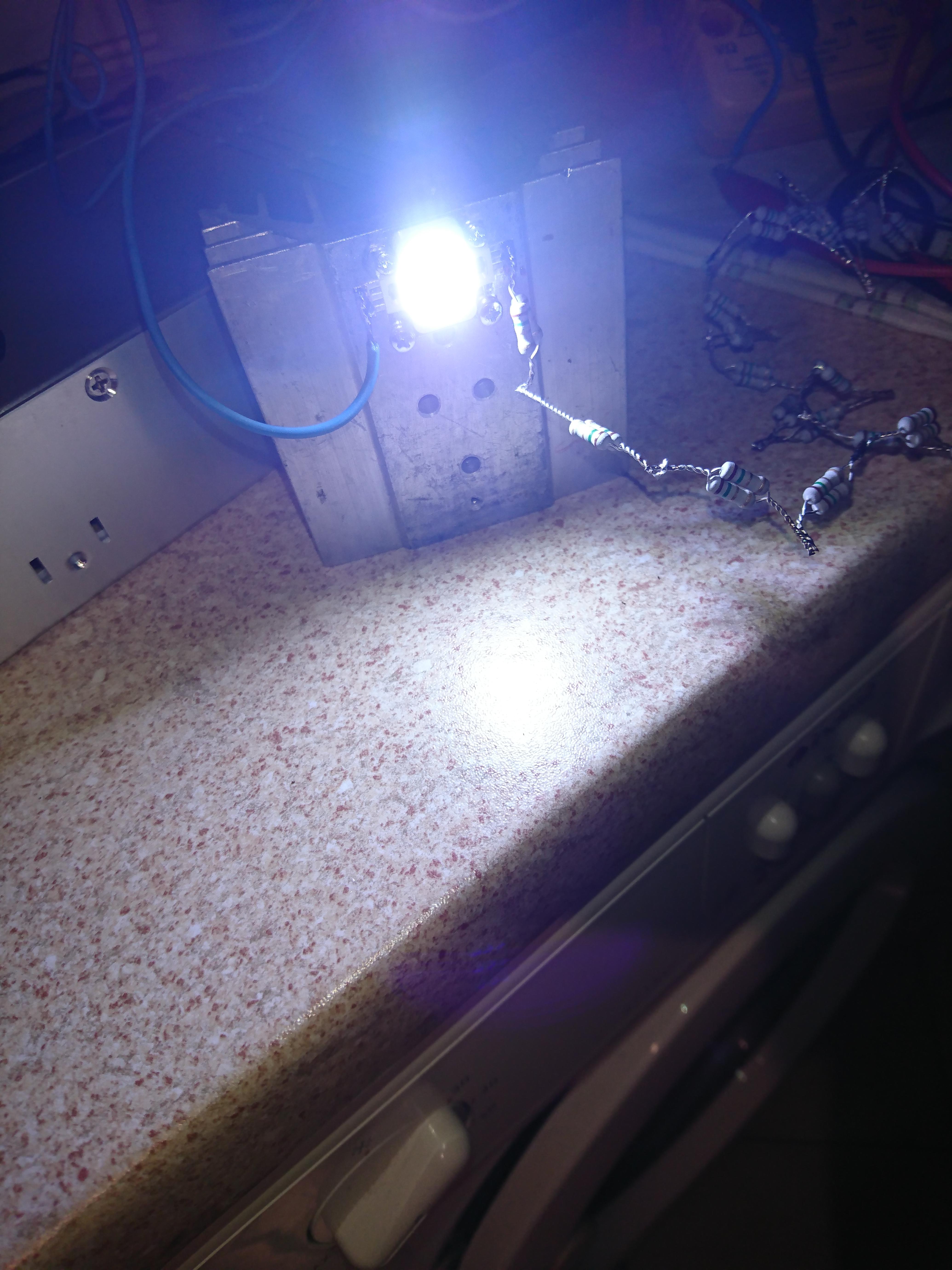

    The diode draws 1.16a current at 12.24v. The 0.59v voltage drop diode heats at this voltage maximum high until it fears after about 35s. How will I give a 2 Ohm 2w resistor the diode gets 0.76a. As the heat sink and surface are calculated, I admit that I am green in this topic
    At 20 Ohm and 2w and 11.34 voltage the diode heats up much less so that after 30 min it is slightly warm. The decrease in brightness is small. The current flowing through the diode is 150 ma, please help me choose the right resistors and power, if a calculator is available or should I choose the experimental one
    12.24V measured on the diode?
    1.16A * 12.24V = 14.2W
    You overload the diode by more than 40%. Increase the series resistor.
    smigas wrote:
    Voltage drop 0.59v
    Is the drop on the resistor?
    And what is the tension on it in this case? Assuming that in the worst case the same as before, it emits on it 9.3W - safe value.
    At 11.34V and 150mA, 1.7W is separated from the diode. If the drop in light flux is small, then either you are wrong in its subjective assessment (activate for comparison two diodes next to each other) or the diode has already been masked with high currents.
    This diode requires a power source, not resistors. The current consumed by the diode changes significantly as the structure heats up.

    What is the difference between the current source and the resistors that limit the diode operating current?
    When using 21 Ohm 2w, the voltage dropped to 11.21v at the moment after 3 hours of diode operation, the diode has 45 degrees constant temperature on the size plate in the attachment. And i draws 140mA which causes an acceptable decrease in brightness.

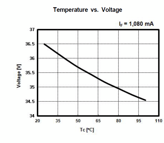

    The current source maintains the current at a set value.
    Resistors do not provide this at all. The LED during operation heats up, and the flowing current is strongly dependent on the temperature. Indirectly, because Uf changes.

    Do you give paste on the diode and heatsink interface?
  • #20 16378635
    smigas
    Posts: 97
    Yes, I used the paste as in the attachment and today I will make the whole 10 led strip 10w and 1.16a each and I will lower the voltage until a satisfactory effect is obtained.
