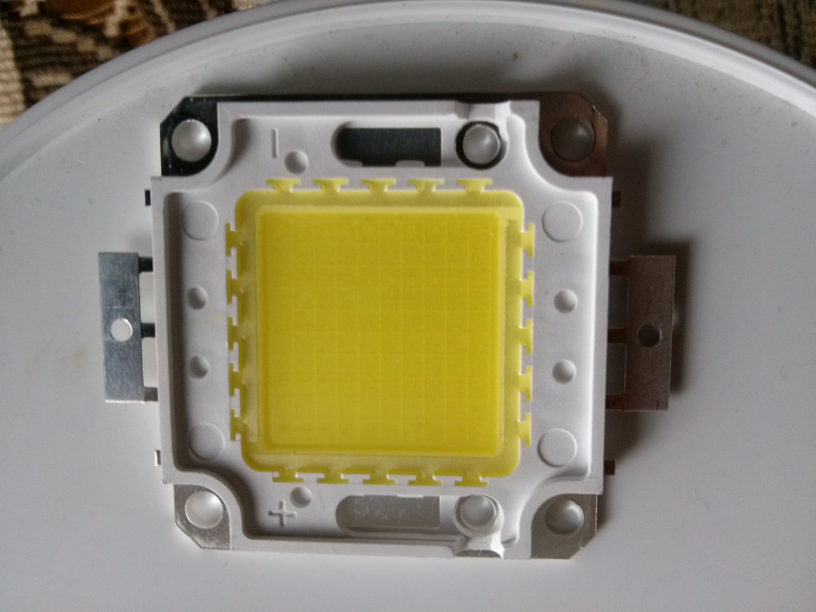

    I bought a Diode Led 50W cob how to check, how to check if it works? and how to check the polarity? where + and where -, there are signs on it but it has nothing to do with these soldering plates. yes, please.

    Hello. Polarities you have marked minus at the top and plus at the bottom, everything can be seen in the picture :wink: Checking Diode 50W COB LED Functionality: Testing Polarity & Ensuring Proper Soldering

    The picture clearly shows the +/- markings. Now, through the current limiting system, e.g. to 10 -100 mA (without a heat sink, it is easy to overheat the diode), connect the regulated power supply and slowly increase the voltage until the diode lights up (36 V or more depending on the diode structure).

    But the cables are soldered to these plates on the left and on the right of this diode on my attachment, where is this plus?

    and another friend @ joda08 He explained to you that it must have cooling. And, like all diodes, it has one forward direction.
    And now so blatantly that it is clear where plus and where minus. Checking Diode 50W COB LED Functionality: Testing Polarity & Ensuring Proper Soldering

    PITERRR and did you even look at my picture? mark on my photo + on the shields where I should solder

    Here you are. Checking Diode 50W COB LED Functionality: Testing Polarity & Ensuring Proper Soldering

    Everything OK. I understood
