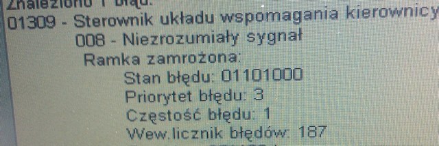

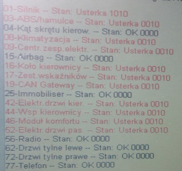

    Just where to look for them. Today it is a massacre with this meter on a distance of 20 km began to go crazy 10 times. He went to a mechanic's friend and we plugged the computer and it showed errors as in the attached photos. All managed to delete except one from the power steering.

    I only have the data as in the attached photos. I will try to drive up again and check these errors. After reading the errors, it wrote - "temporary voltage loss" at each error.

  • #8 16406690
    juhas77
    Posts: 32
    They follow the relays, I started replacing them one by one and testing what would happen. I have already replaced the 5th turn and I drove the whole week without any problems, I did about 600 km and everything was fine until today, where after about an hour and a half of continuous driving the problem returned.
    I was on the computer and there is an error with the terminal 30 supply voltage - he writes a sudden voltage loss error number 00668 and two more error in the alarm siren and shaft position sensor. However, these errors can be cleared. There is only one error 01309 power steering system controller and this error cannot be deleted.

  • #9 16406752
    bobikxxl
    Posts: 139
    Help: 7
    Rate: 31
    terminal 30 is a constant plus from the battery, you need to check the entire power lines, in what modules are these errors?
