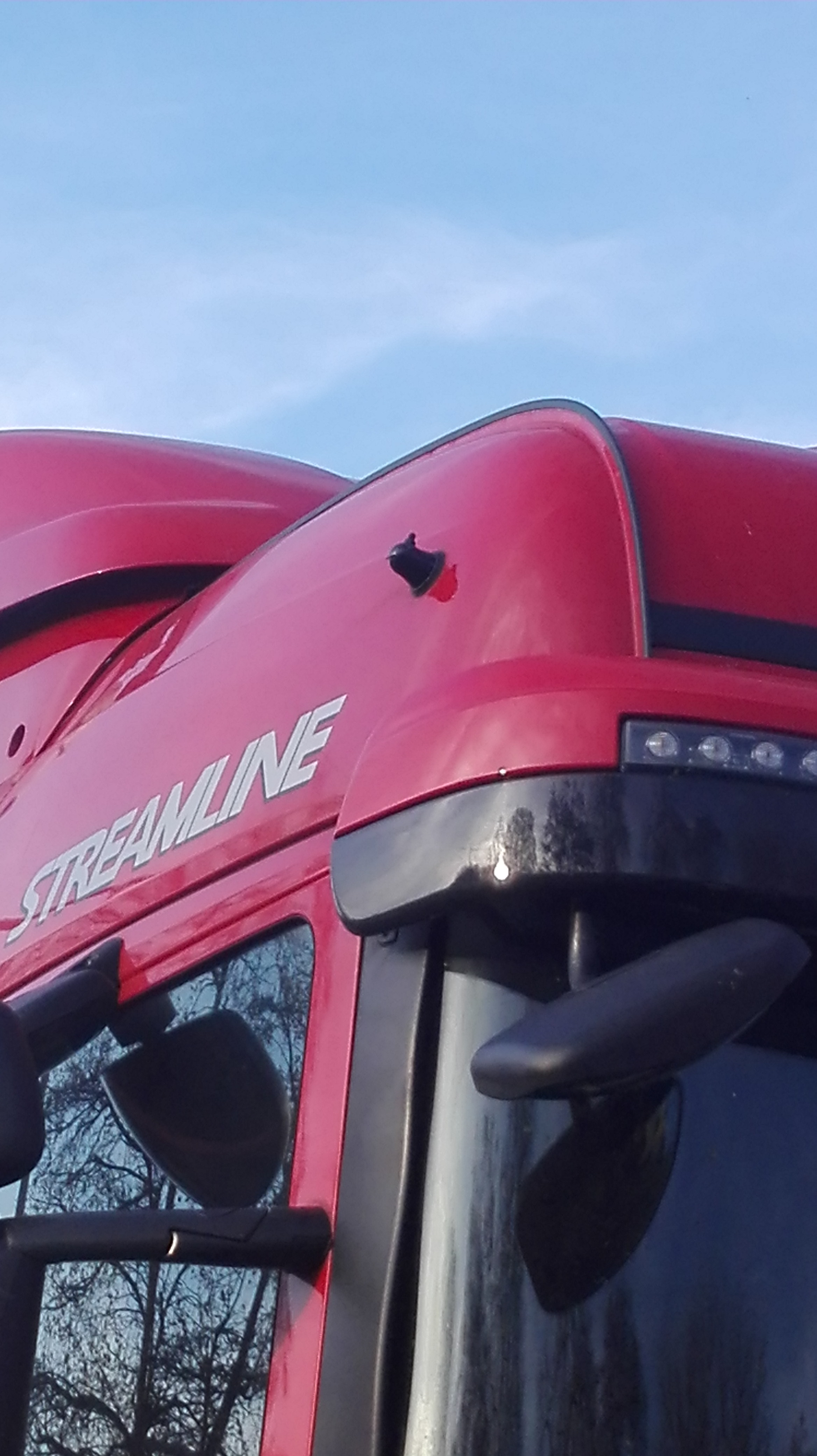

    • Scania 430 2015 - Where can I find the cable for the CB antenna 14909585493453453655.jpg (1.66 MB) You must be logged in to download this attachment.
    #7 16383721
    gumisie
    Posts: 17906
    Help: 1667
    Rate: 2482
    It looks like heads, but I haven't seen one like this yet, it may not necessarily be from CB_radia. My next question is: is the roof of this car made of metal or some kind of material? As long as the metal, drill a hole on the other side and install a new antenna (set the optimal WFS with the reflectometer and enjoy the connection).
    Regards, good luck.

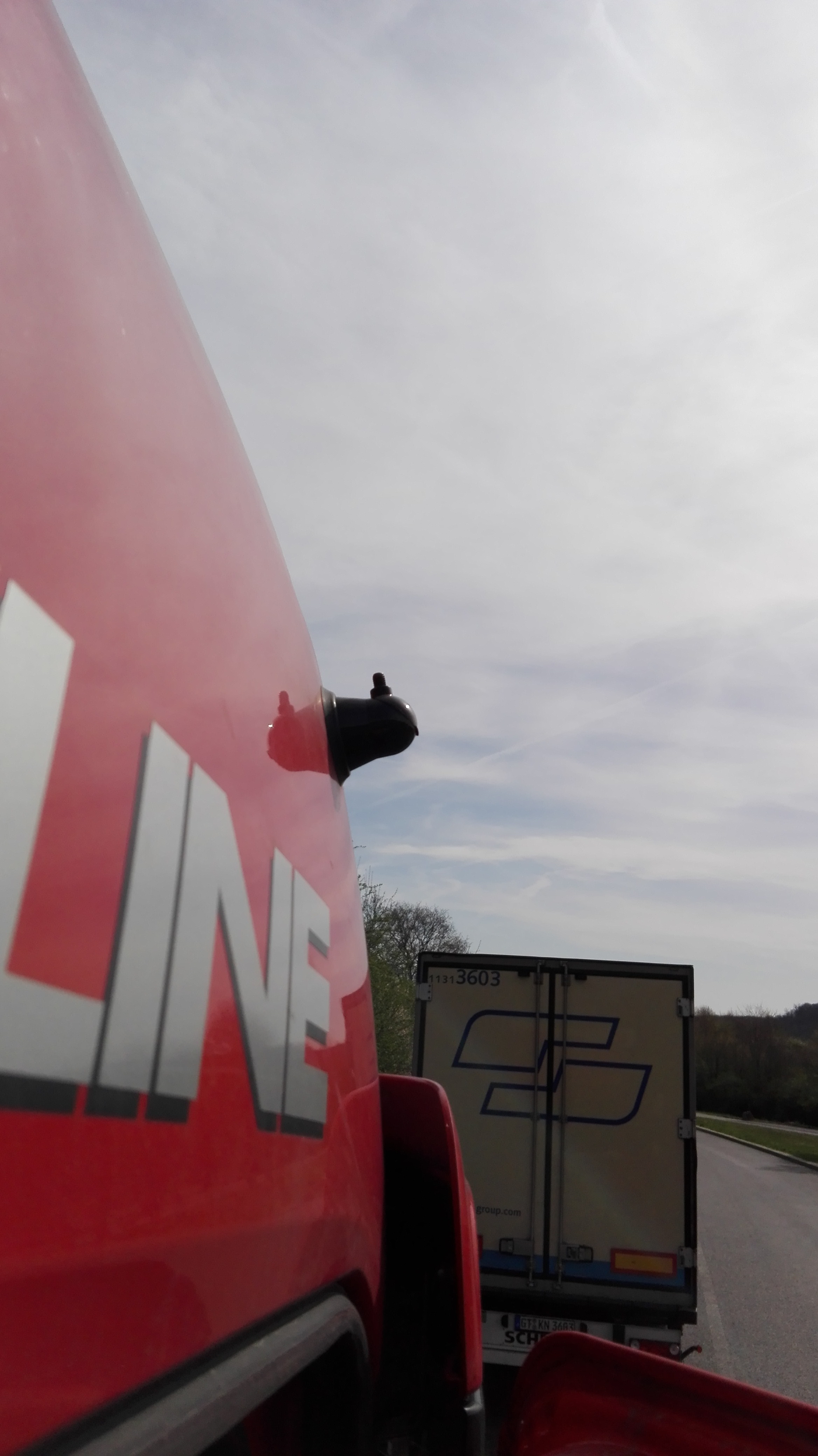

  • #8 16384133
    Janusz00700
    Posts: 7
    Regards, good luck.

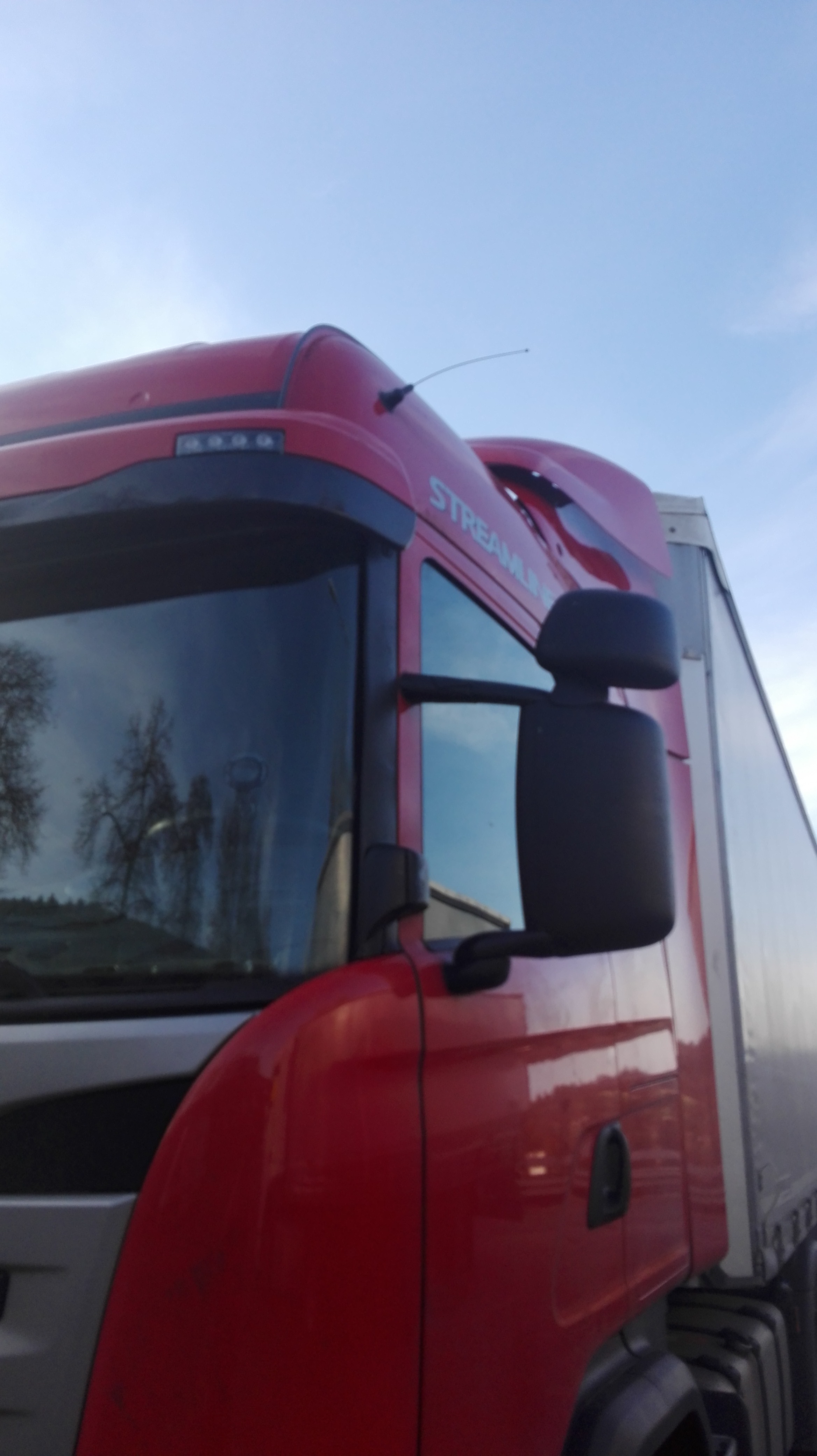

    The roof is metal, unfortunately, I can't drill anything because the cars are in lising
    Maybe such a photo will help something
    On the other hand, there is a regular antenna
    • Scania 430 2015 - Where can I find the cable for the CB antenna 1490977058655-1818838677.jpg (1.84 MB) You must be logged in to download this attachment.
    • Scania 430 2015 - Where can I find the cable for the CB antenna 1490977019425486173586.jpg (1.8 MB) You must be logged in to download this attachment.
  • #9 16384415
    Hektar Zahler
    Posts: 2333
    Help: 230
    Rate: 527
    These antennas fall off and are dangerous on the road - that's the only thing they do.
    Janusz00700 wrote:
    normally there should also be a cable from the antenna, but where can I find it, if there is one?
    The UC1 to CB terminal is behind the tachograph, next to which there was a Stabo XM3082 in the Stabo cassette pocket.
    + 12V is already there.
    In an era, to make a CB you need two things, actually three:
    - move the radio antenna from the left to the right, but carefully, because these aluminum "imitation" brackets break very easily
    - buy a CB antenna and attach it on the left in the hole on the radio
    - additional speaker rather required
    Ory fastener flies out and to unscrew it:
    The visible rubber band is pulled out and unscrewed as a screwdriver shows, supporting them from the inside.
    The only difficulty is to get this thin wire to make it be done as befits Scania - it's only about an ordinary radio.
    (to put on the radio, because it will not be enough)
    Under the mount, the paint must be peeled off to the bare metal plate (no need to the right) - it's about SWR.
    Access is very good.
    In order not to break the brackets, you need to feel the screws tightening in the aluminum.
    They are screwed up completely, in a word they are useless and the one from CB (i.e. on the right) I advise you to throw away without thinking it, along with the entire antenna and cable.
    The radio antenna is, as it were, forced, although its proper place is also at the waste collection point.
    The new antenna is retuning relatively.
    At the end:
    - tilt the radio antenna so that it is flush with the roof, because tree branches
    - the CB antenna as vertically as possible
    The same is to advise friends and forget about the problem.
