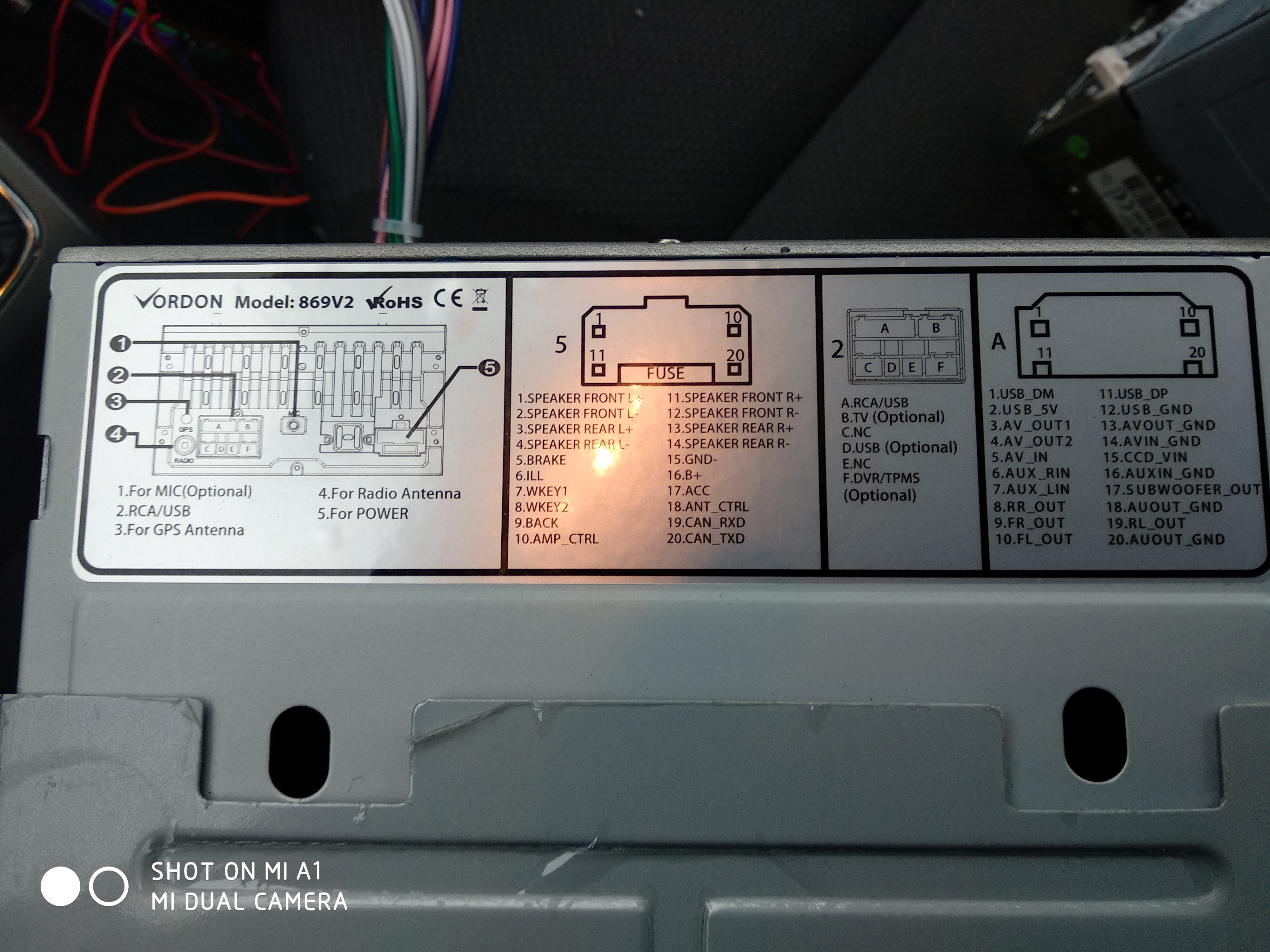

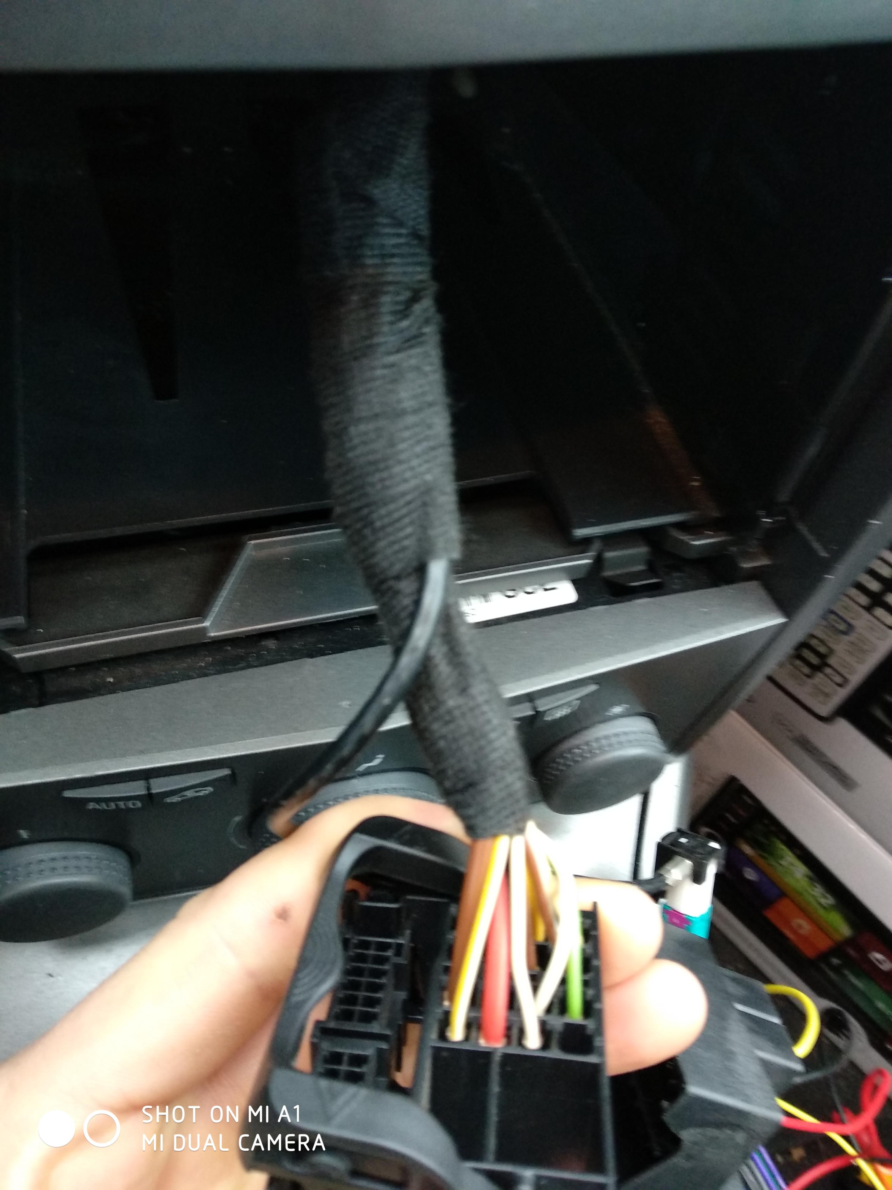

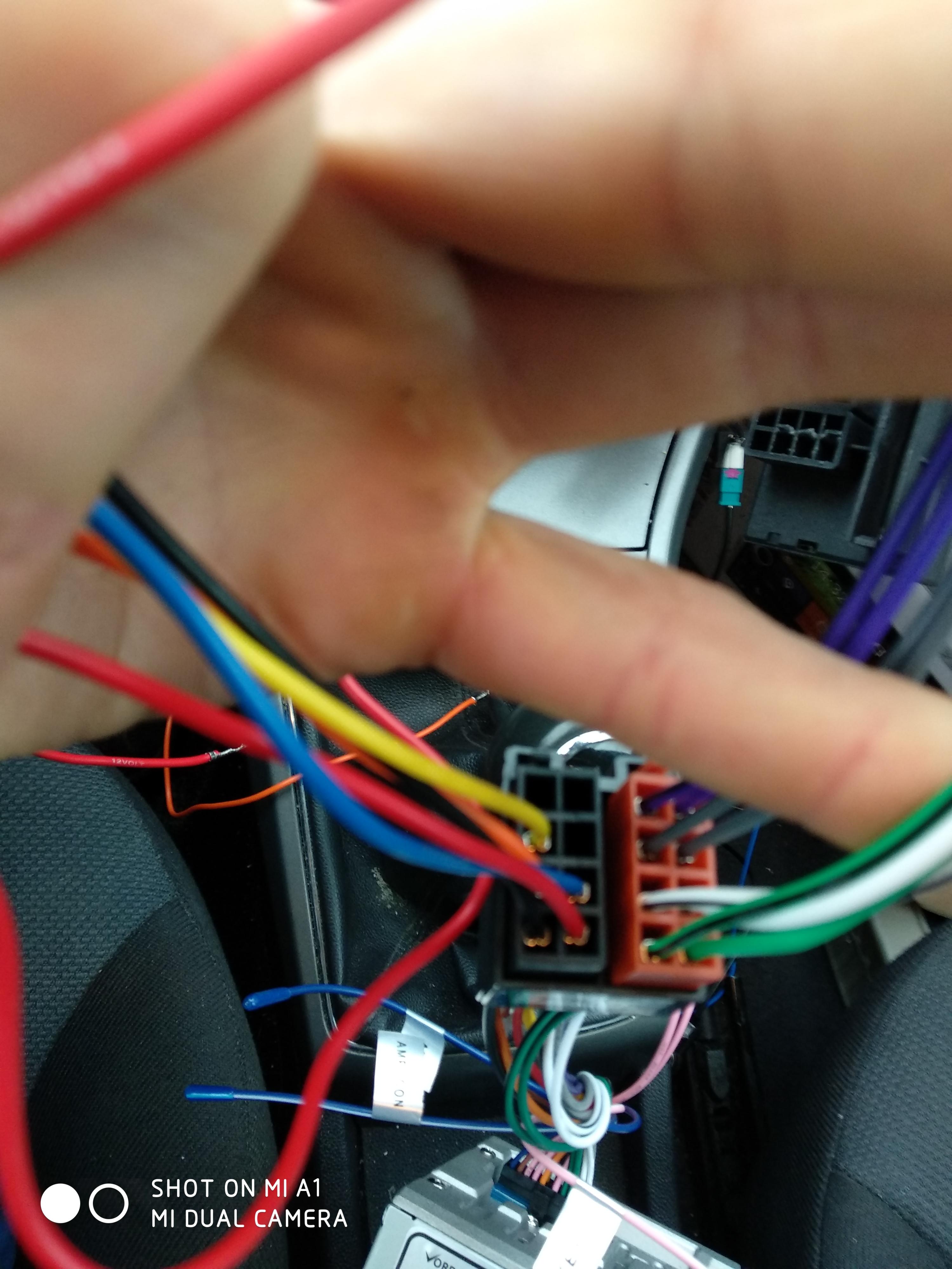

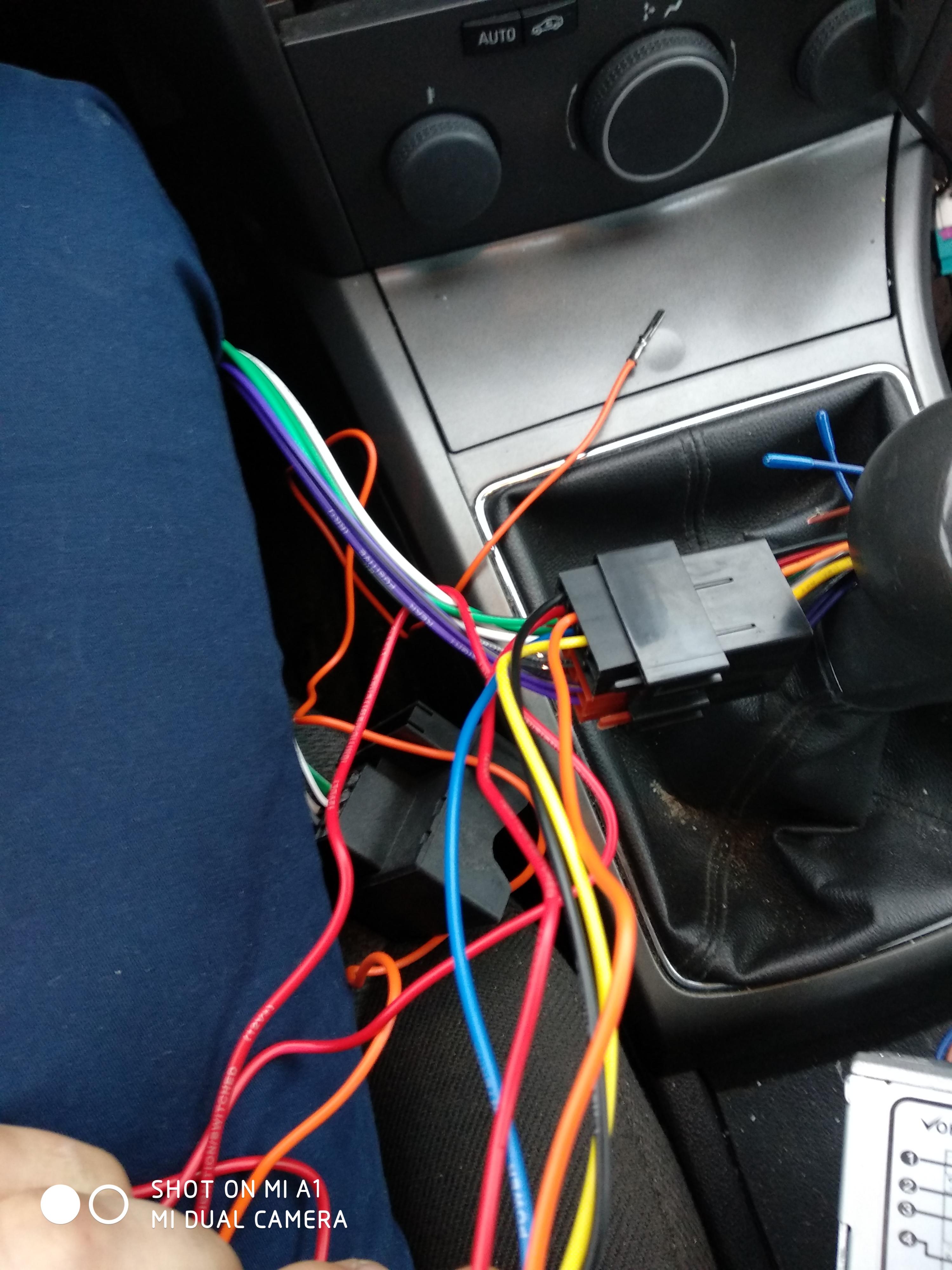

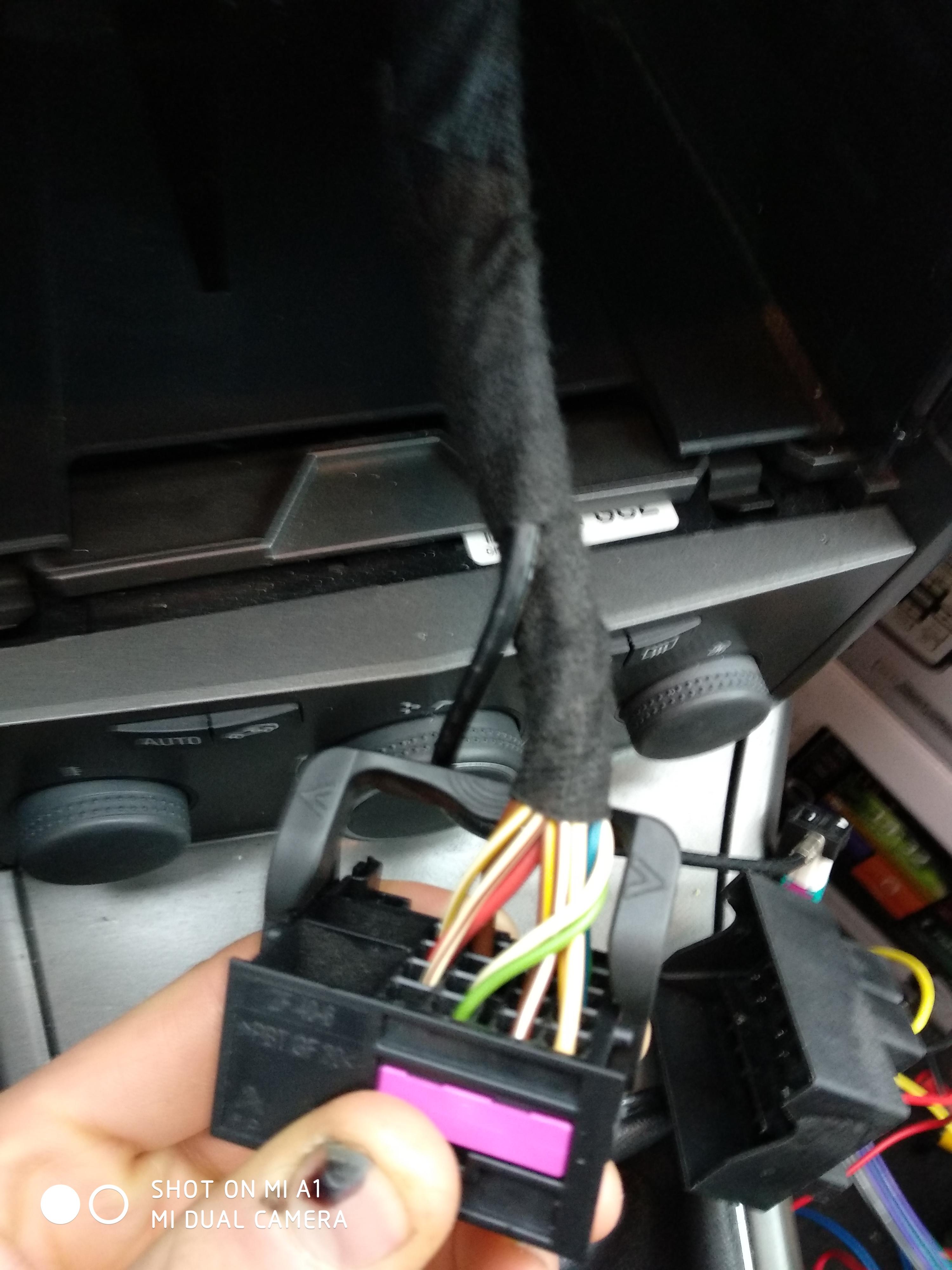

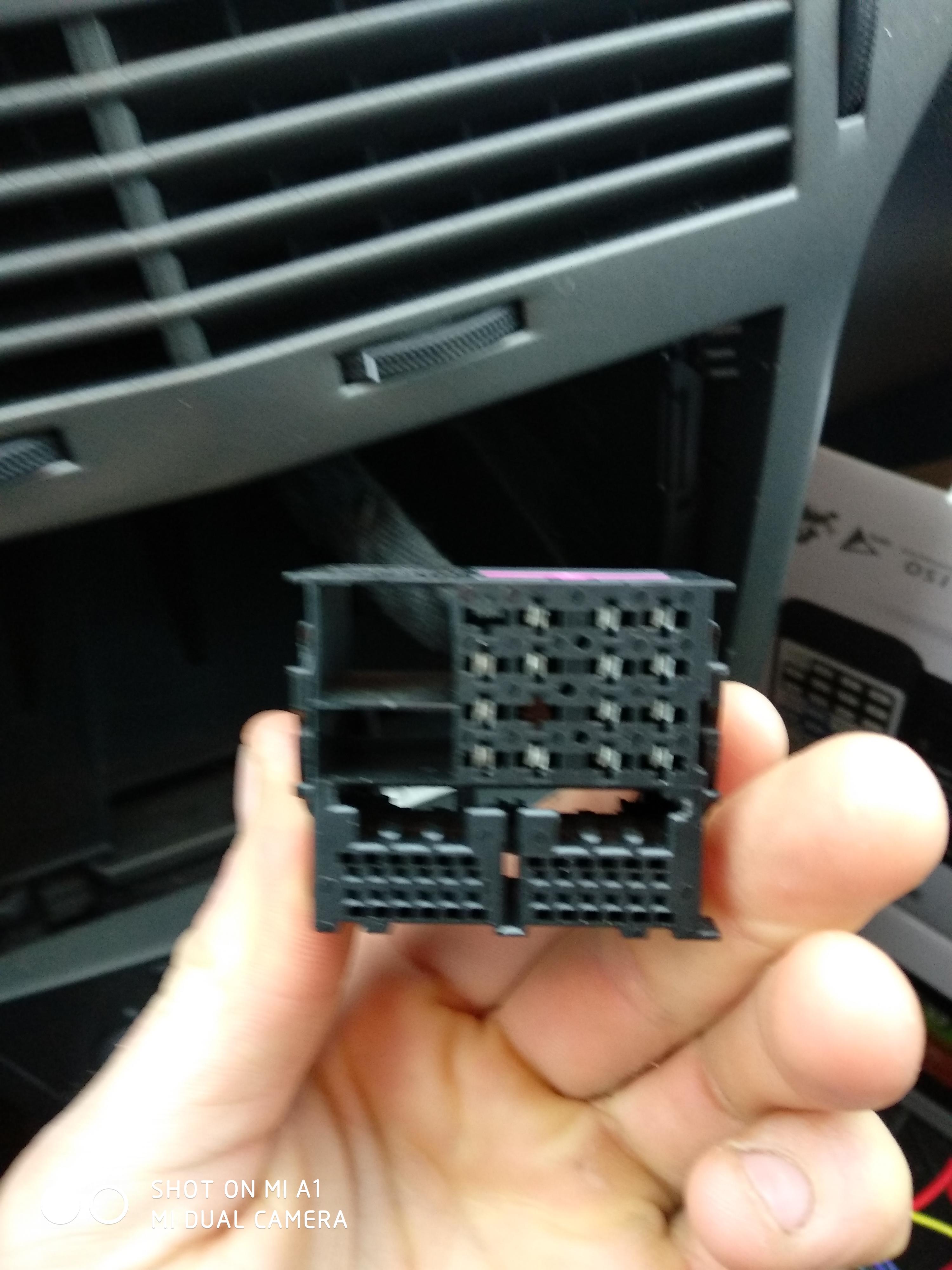

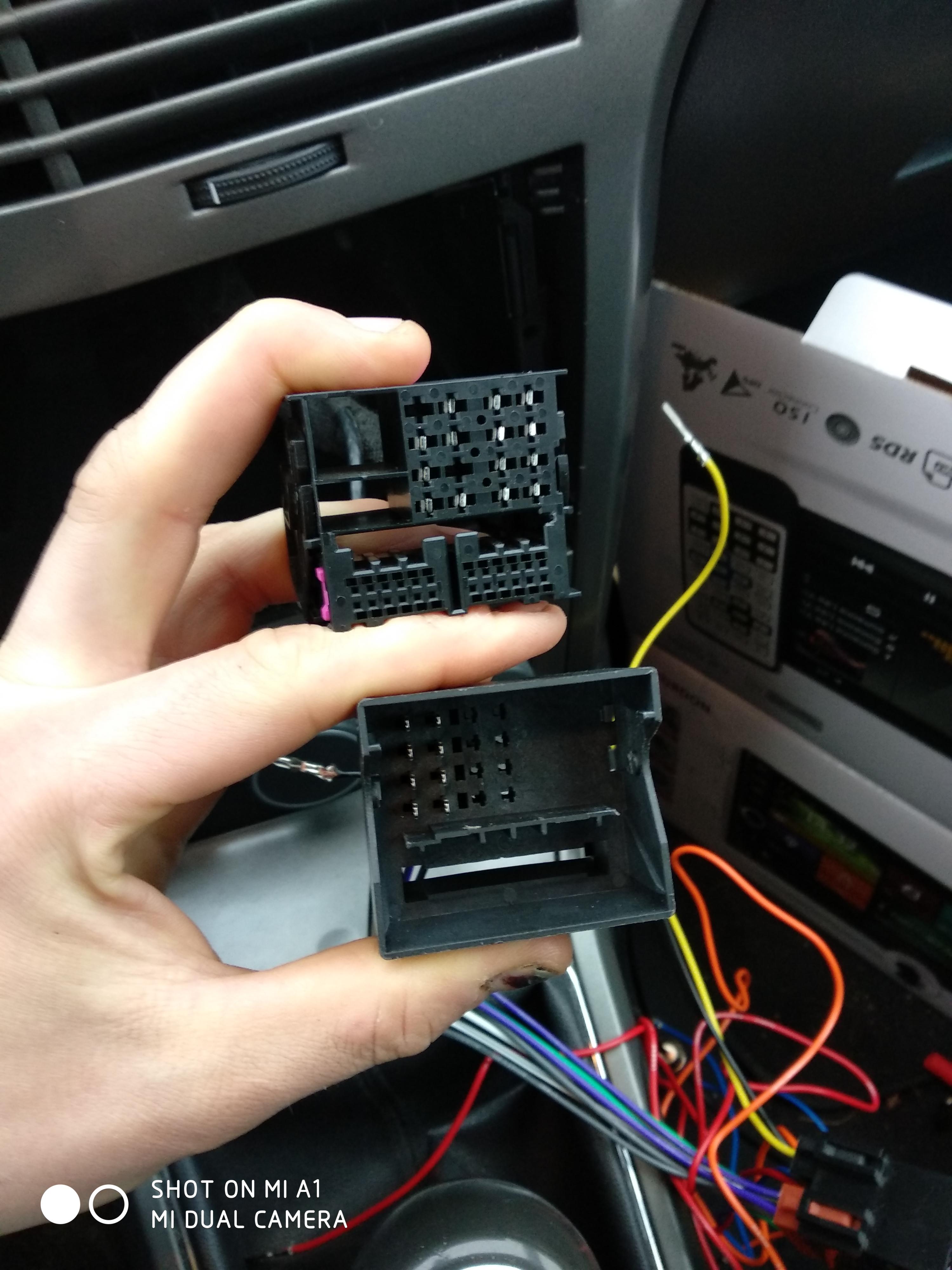

    Hello. I need help connecting the radio to my astra. I have all adapters with 2 loose cables (red and orange). When connected, the wql radio does not respond. Does anyone have a ready diagram or knows how to connect it? I am completely green in these matters: /
    Where do these cables come from?

    marcinos122 wrote:
    with them 2 loose cables (red and orange)
    ACC and ILL.

    ACC is the power supply behind the ignition switch, and ILL plugs into the low beam.
