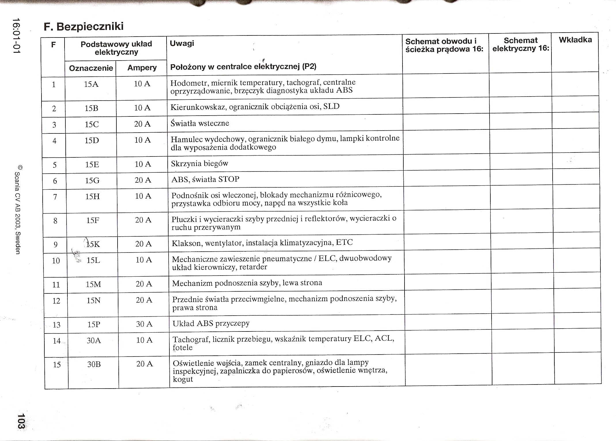

    I need a fuse description for Scani 114L 380.
    A few things like the direction and the lighter do not work, I suspect blown fuses, and the board is unfortunately in German.

    I send a description of fuses.
    • Scania 114L 380km Fuse Description: Troubleshooting Direction & Lighter Issues (German) skanuj0001.jpg (810.38 KB) You must be logged in to download this attachment.
    • Scania 114L 380km Fuse Description: Troubleshooting Direction & Lighter Issues (German) skanuj0003.jpg (770.65 KB) You must be logged in to download this attachment.
    • Scania 114L 380km Fuse Description: Troubleshooting Direction & Lighter Issues (German) skanuj0002.jpg (774.55 KB) You must be logged in to download this attachment.
