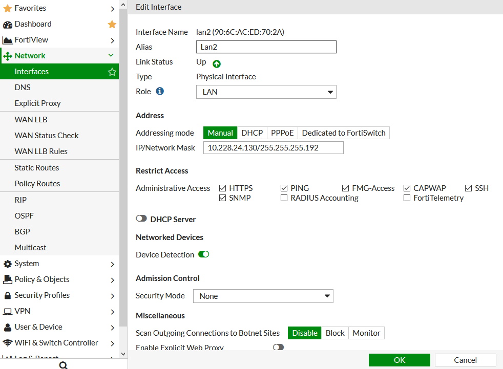

    Fortigate 50E and Forti OS 5.4. I want to connect the second building to LAN2 (separate addressing), give them access only to the Internet (via WAN1) and the file server in LAN1. I know I have to create a new interface on LAN2, you can choose from LAN or WAN. Anyone have experience with this device?

    Thanks for the answers. I have searched on foreign sites and the recommendations to disable port forwarding and NAT are repeated, but it still does not work for me.
    The ports are "disconnected", so Lan1 is listed as "Hardware switch", Lan2 as "Physical interface".

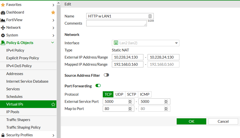

    I have created Virtual IP (computer with XAMPP server in LAN1):
    Fortigate 50E: Connecting Second Building to LAN2 for Internet Access & File Server on Forti OS 5.4virtual...png (38.05 kB)You must be logged in to download this attachment.

    Theoretically, a computer with IP 10.228.24.135 from LAN2 should ping 192.168.0.160 from LAN1 - it does not ping, nor does it load HTTP.

    A bit meaningless to me. You definitely have NAT between LAN 1 and LAN 2.
    Where is 192.168.0.160.
    External IP Address - entire subnet ?? and the one with the LAN2 interface address?
    I guess you need to familiarize yourself with the general ideas of NAT and implementation details on FG.

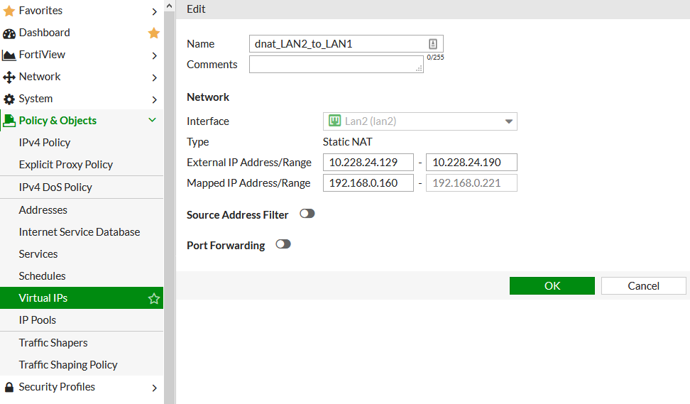

    You're right, I did "God's way" and it worked:
    Fortigate 50E: Connecting Second Building to LAN2 for Internet Access & File Server on Forti OS 5.4virtual_..2.png (42.16 kB)You must be logged in to download this attachment.

    This NAT between LAN1 and LAN2 is not needed at all.
    Just adding a rule in Policy, just like you just have a server address instead of a natu rule name in destination address, and this should work as long as there are valid routes in the routing table.
    In the Adresses tab, you probably have the option to just define a name for the server address in LAN1, so as not to manually pat the rules (I'm not sure because I have a slightly older version of FortiOS)

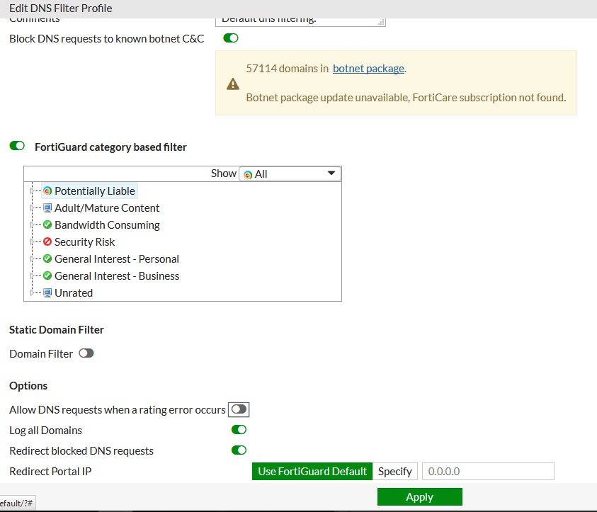

    Perhaps I have a lower model and that's why. I am still struggling with WEB filtering. As far as it filters by category, if I add a domain to block or allow it below, it does nothing. The DNS filter behaves the same. Even disabling filtering by category, and leaving manual entries will do nothing: /
    http://cookbook.fortinet.com/blocking-facebook-54/

    DNS Filter (when enabled in IPv4 Policy, no page loads):
    Fortigate 50E: Connecting Second Building to LAN2 for Internet Access & File Server on Forti OS 5.4DNS Fil...jpg (97.22 kB)You must be logged in to download this attachment.

    As for the DNS filter not working, it is possible you have something wrongly set up in the configuration of the system itself and eg DNS fortiguarda are unreachable.
