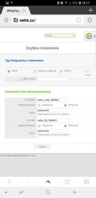

    Hello. I have Netisa as in the description. I would like the router to receive the net from the main router on the 5GHz band but then forward it to the LAN sockets. Is such a setting possible at all? If so, how to set it up?

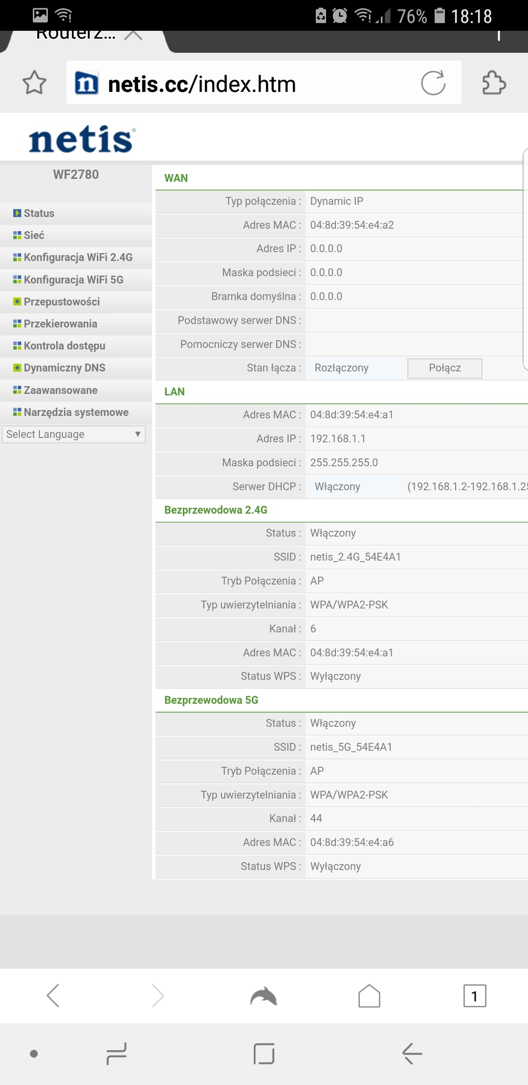

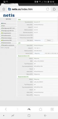

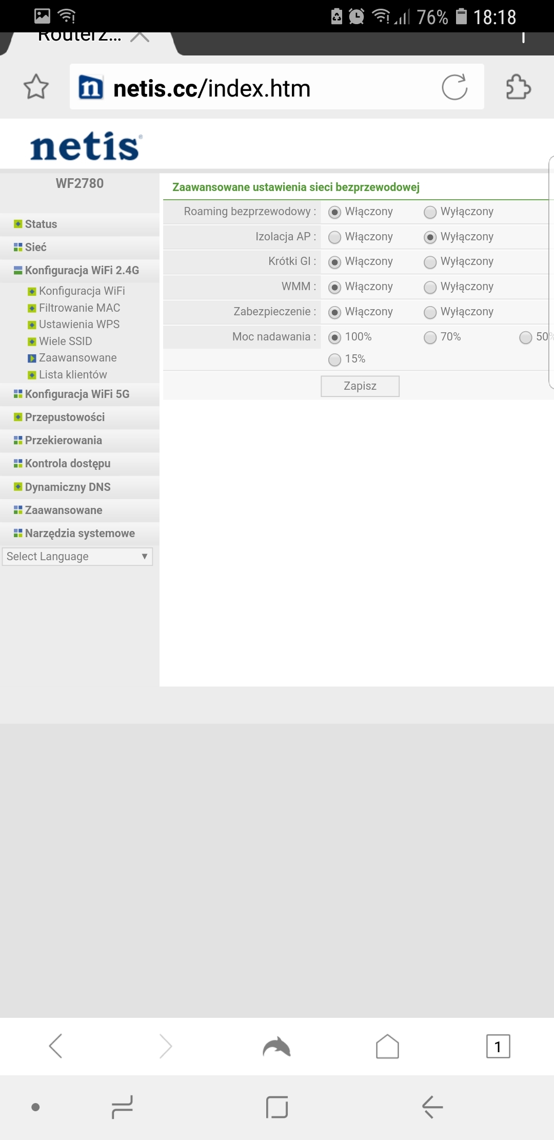

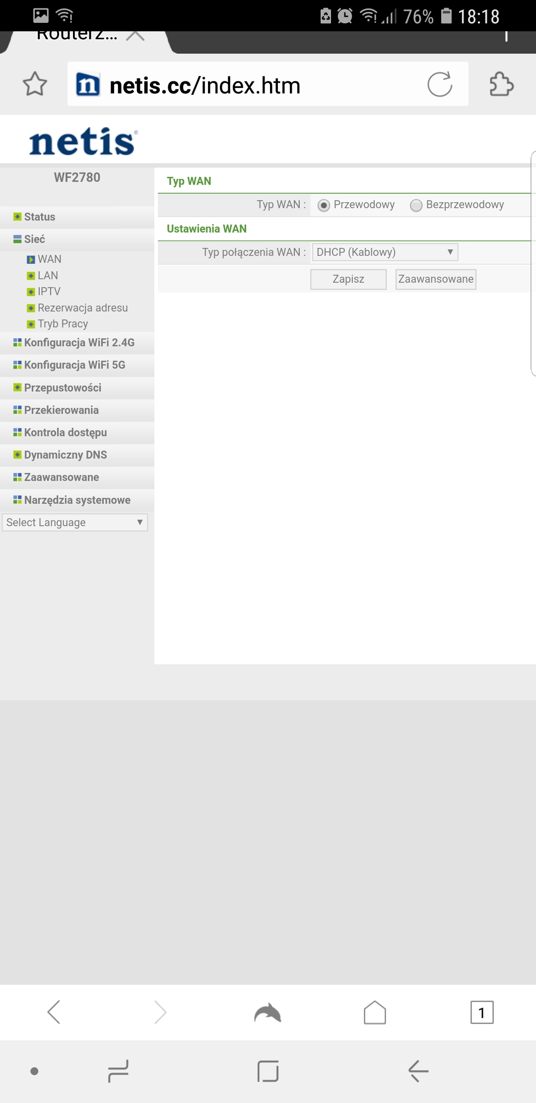

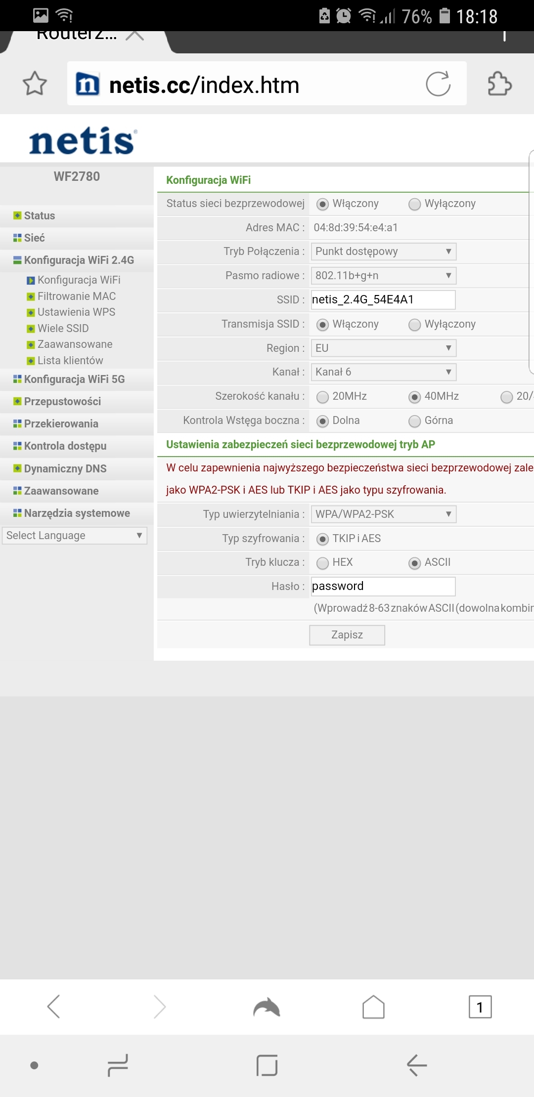

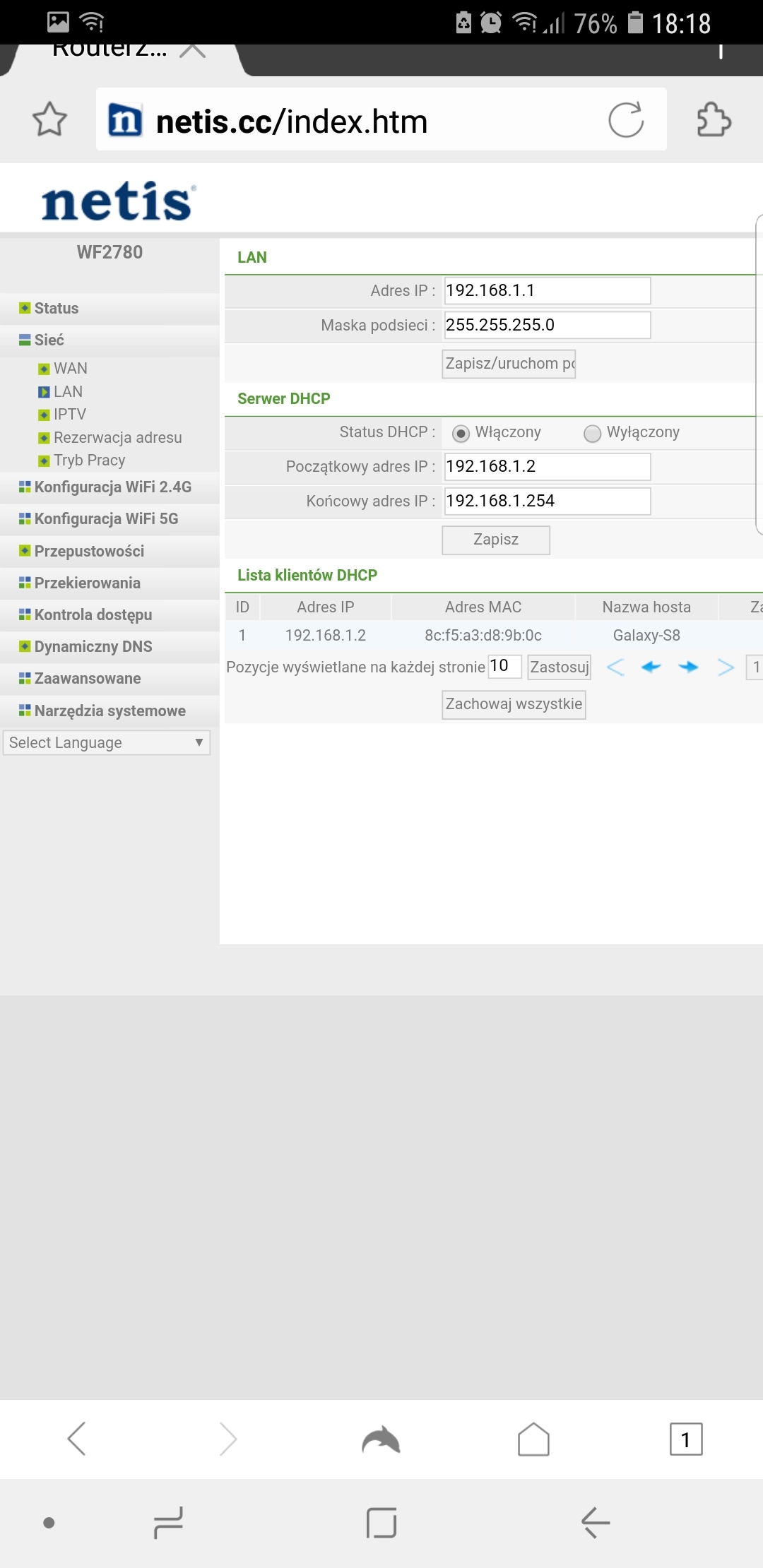

    Approx. These are some screenshots. If that wasn't enough, I will do more, I have no idea what might be needed.
    Netis WF2780: Configuring 5GHz Band Repeater to Forward to LAN Sockets - Setup Guide Netis WF2780: Configuring 5GHz Band Repeater to Forward to LAN Sockets - Setup Guide Netis WF2780: Configuring 5GHz Band Repeater to Forward to LAN Sockets - Setup Guide Netis WF2780: Configuring 5GHz Band Repeater to Forward to LAN Sockets - Setup Guide Netis WF2780: Configuring 5GHz Band Repeater to Forward to LAN Sockets - Setup Guide Netis WF2780: Configuring 5GHz Band Repeater to Forward to LAN Sockets - Setup Guide Netis WF2780: Configuring 5GHz Band Repeater to Forward to LAN Sockets - Setup Guide Netis WF2780: Configuring 5GHz Band Repeater to Forward to LAN Sockets - Setup Guide

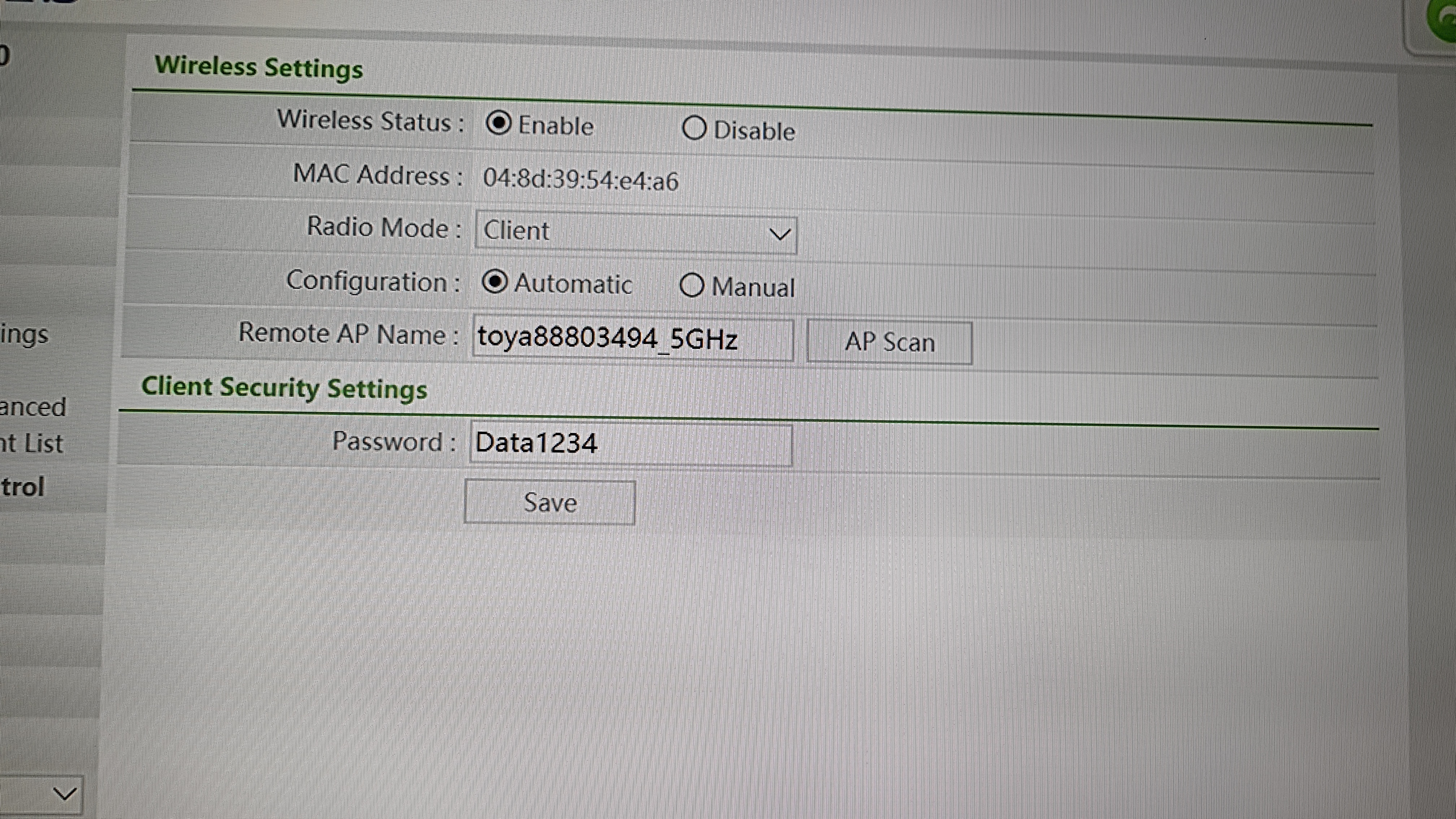

    I set these settings in 2.4 GHz and 5GHz settings. But it does nothing. After connecting the router to the laptop with a cable I have a yellow padlock and no net at each of these settings. What else can you change (move) to force the router to work?
    Here is a router menu emulator.
    http://www.netis-systems.com/Uploads/Support/Emulators/WF2780_EN/index.htm
  • #9 17092272
    rafish
    Posts: 54
    wireless -> wireless settings-> radio mode - Client, then AP Scan, select the network, enter the password and the router should connect

    I did according to advice and lime. Still a yellow padlock and no net. Netis WF2780: Configuring 5GHz Band Repeater to Forward to LAN Sockets - Setup Guide

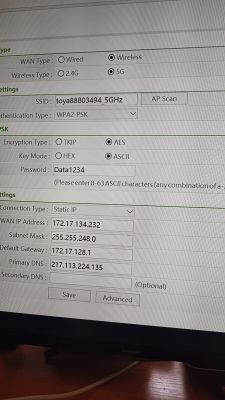

    ehhh, 2 years ago I played with this netis and I don't remember everything, maybe try it again - Network -> WAN -> WAN Type select Wireless then fill in everything on this card, and on the LAN tab set the address from a different network than on this one access router - just change the number in the third octet

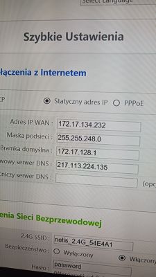

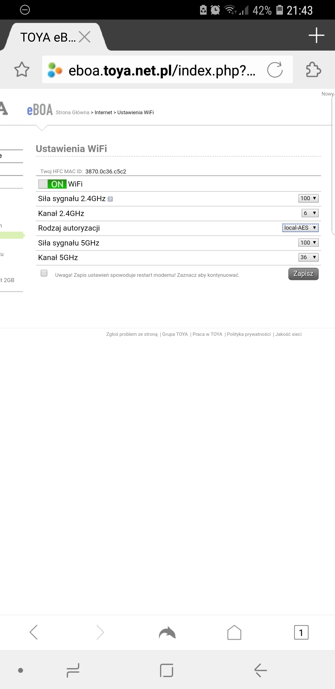

    And how can I check which LAN address on the main router? Everything was visible on netis. And in this new is only this:
    I still tried to enter the router by entering the address in the browser but it does not connect. Probably it was blocked by Toy.

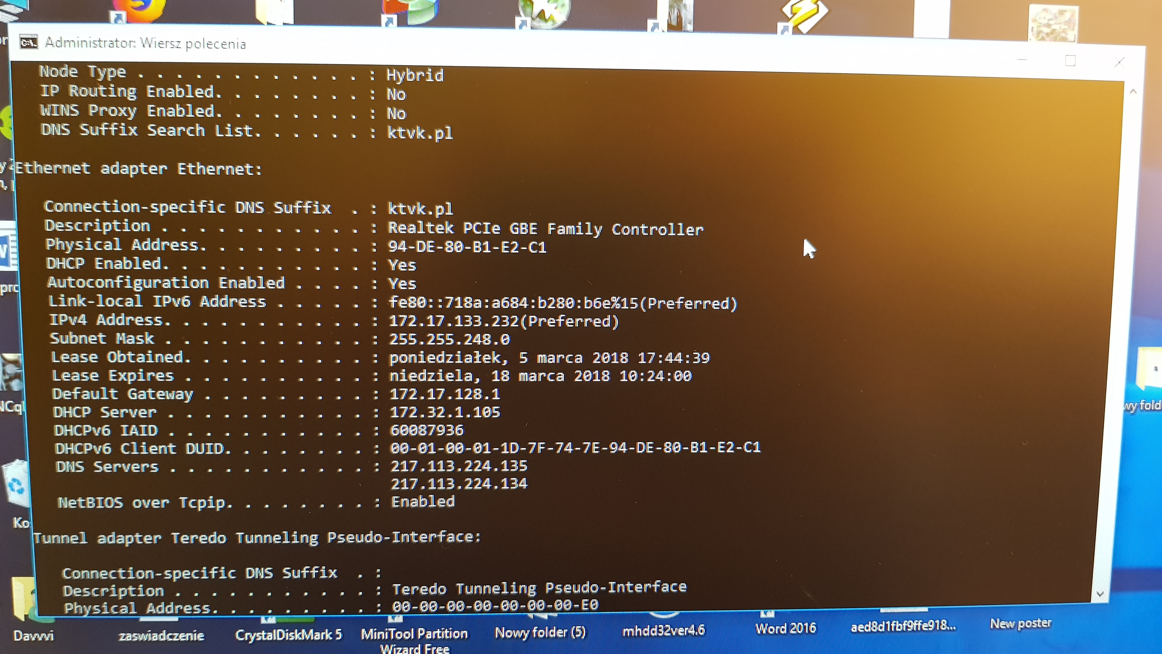

    rafish
    Posts: 54
    connect to this router from the operator, then on the command line enter ipconfig / all, in the results of the command you will receive an address, gate and mask

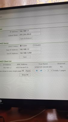

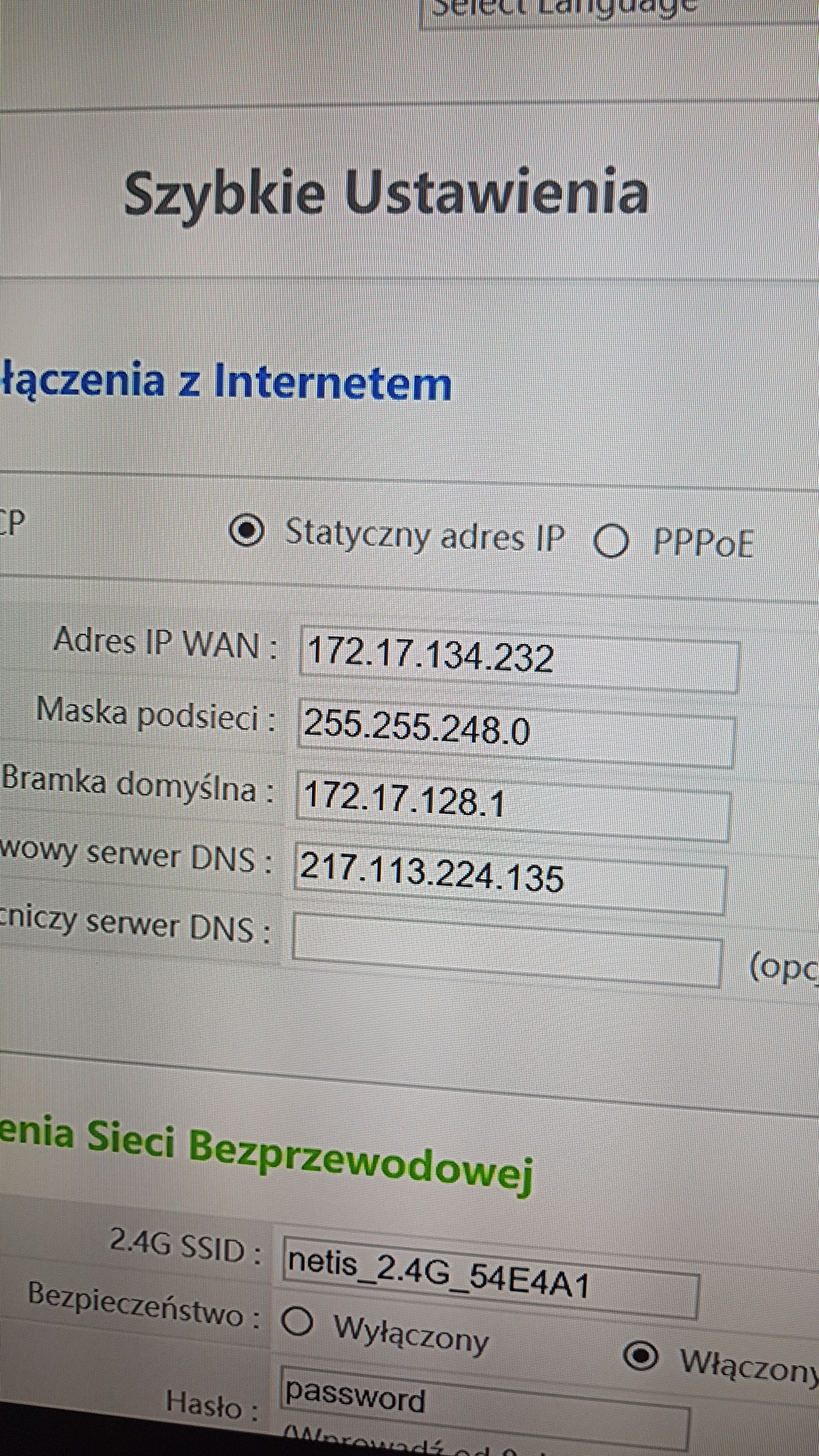

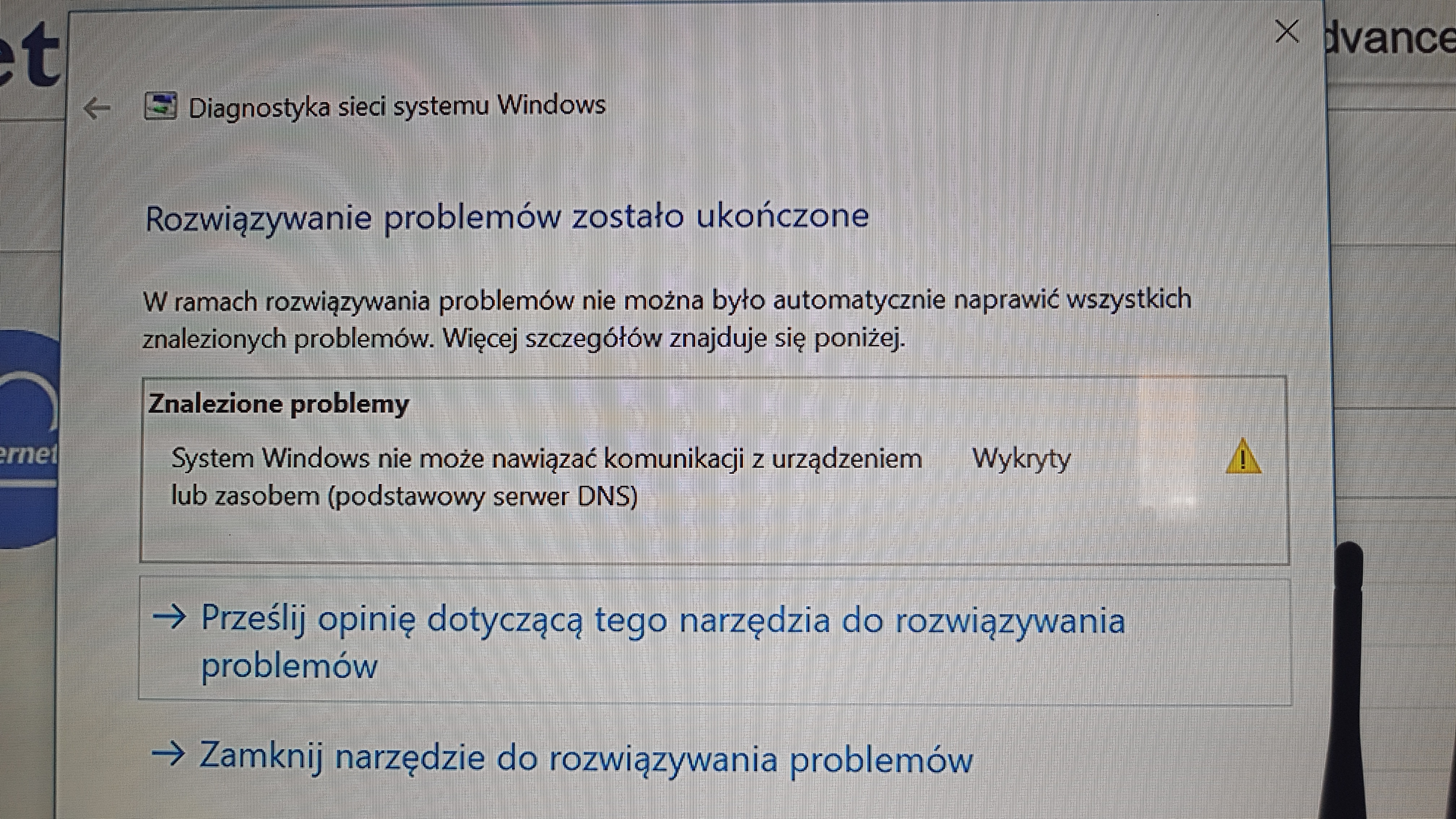

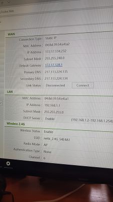

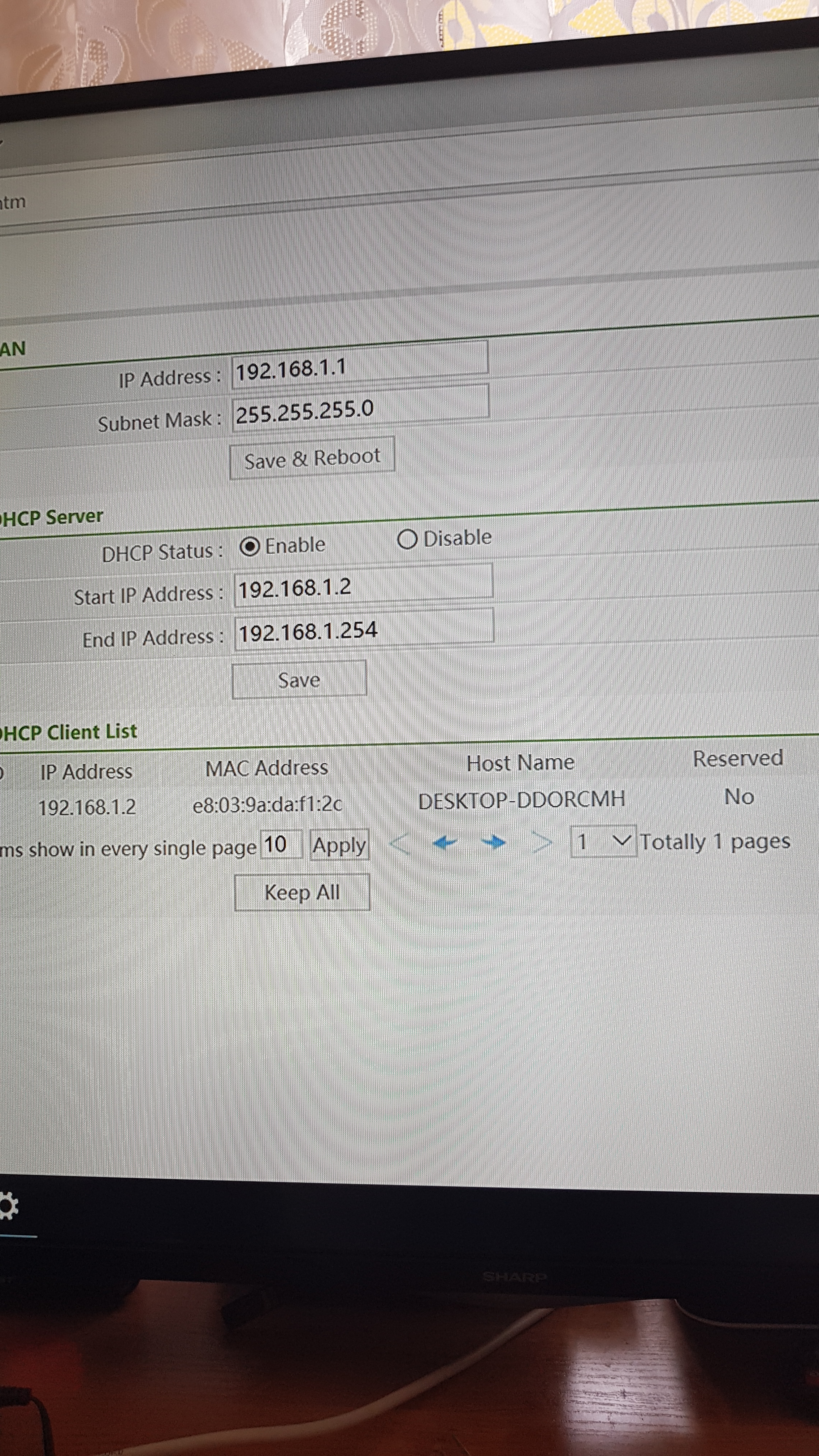

    Unfortunately, nothing helps. When I entered the LAN address then I couldn't get to Netis anymore. I took some pics.
    It's from the command line it's from the main router.
    Edit.

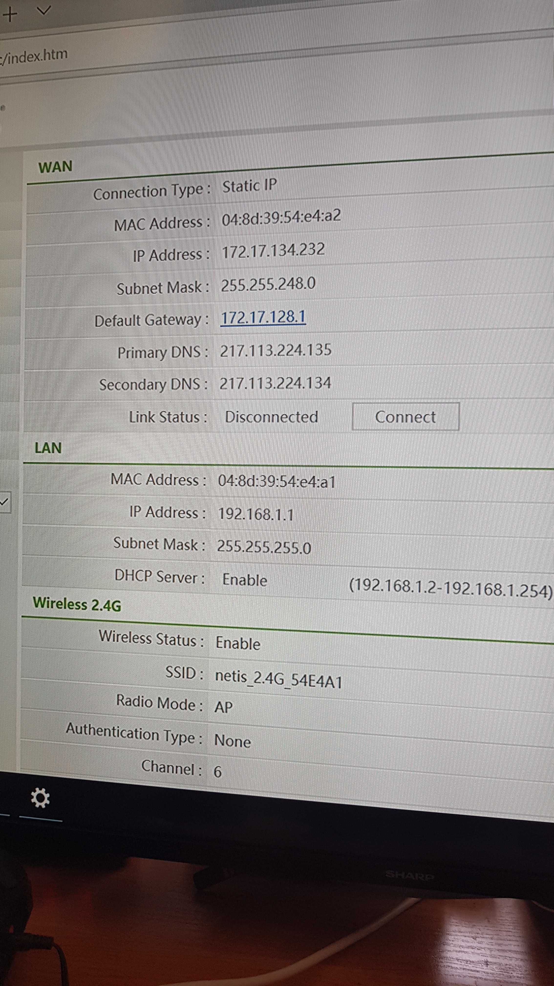

    I played a little and the computer to which Netis is connected recognized it. But there is no internet access. Just as if Netis would not capture the net. I entered the IP settings and no effect. And this is how it looks.
  • #15 17109904
    Davvvi
    Posts: 2647
    Help: 6
    Rate: 183
    Gentlemen, Netis cannot be configured with Router from Toya. Even a specialist in such matters could not cope. Toya probably blocked this possibility not to amplify the signal and not share it with neighbors. Therefore, it is probably impossible to enter the main router, and change the type turn off Wifi etc. can be made only through the user's account. Well nothing Netis will go on sale. Regards.
