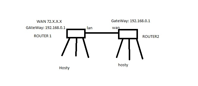

    Hello all,
    I have a question, is it possible to connect such routers, namely router no. 1 (main with external IP) is connected to your LAN under router no. 2 through its WAN port. I want to do this because the hosts of the second router have the same default gateway and IP addresses as in the router no. 1. - I would like to avoid configuring settings in the hosts of router No. 2. How do you see them?

    Lighten up a bit more. Currently how is it connected? Devices are connected to ROUTER1 and you want to add one router between them and ROUTER1 as in the diagram?
    If so, you must either set WAN on router 192.168.0.0/24 with gate 192.168.0.1 on LAN Router 2, set address other than 192.168.0.0/24 on LAN Router 2 (eg 192.168.1.1) and change the addressing of all devices with ROUTER1 to ROUTER2 (unless they have DHCP it pulled the addresses themselves).
    The second option is change to ROUTER1 LAN address, for example 192.168.1.1, WAN on Router 2, then you set from the 192.168.1.0/24 pool with 192.168.1.1 gateway and LAN on Router 2 set 192.168.0.1 and addresses of devices overwrapped from ROUTER1 to ROUTER2 they will not change.
    Otherwise it will not give because on ROUTER 2 you can not set WAN from the pool 192.168.0.0/24 and LAN in the same pool because there will be a conflict.
    Previously, it looked like Hosts with router no. 1 (main) were and are connected to the main router, while hosts with router no. 2 had a different internet provider and were connected to the router no. 2. It worked independently. Now I want to pass Hosts from router No. 2 as quickly as possible to router no. 1, that's why I thought about adding a router.

    Router 2 connect to the LAN port and nei WAN. Wsio will be in one network then. On router 2, disable DHCP, hosted hosts to router 2 will be downstream from DHCP router 1.
    Router 2 will be doing switch + access point (if it also has WiFi).

    I do not know if it is the worst. Zalezzy what you want to achieve . You can connect to WAN but then hosts from router 1 will not see hosts from router 2 (NAT). Router 1 will be "ISP" for router 2.

    How do you connect via WAN:
    1. the hosts from router 2 will see the hosts from router 1, and what is behind the router 1, that is, the entire internet.
    But not the reverse. Those from router 1 will not see those from router 2, because they will be hidden with NAT. So that hosts1 and hosts 2 can not see you, you need to use a more advanced router, or if you have to use VLANs.
    2. In the host / DHCP configuration of the 2 NIC router, you do not change from the LAN side. The only thing you set, its WAN address 192.168.0.X and gate, probably 192.168.0.1. Or, to put it differently, the router's WAN port 2 becomes a host on the router's network 1. It's nothing different than a computer on the network 1.

    I tested the connection of two routers between LAN and WAN - I can not have LAN in the same subnet as WAN - that's what Vytautas_YT mentioned - thank you. Recalling what's going on so that you do not have to read everything from the beginning ;) Hosts from Router 1 and 2 have the same subnet - 192.168.0.0, there is also the same default gateway. So the easiest way would be to connect everything to one router and count on static addresses do not bite. There is also a problem of this type, so that both groups of computers connected only to one router can not see each other. Here, I thank my colleague m.jastrzebski for a hint to use the VLAN for this purpose. I guess we will not think of anything anymore so as not to change the configuration of hosts from both routers?

    Well, there is no other solution. By changing the address you will have to change the user addresses for one or the other router. Put everything into one subnet and possibly change the configuration of those users who are conflicting. Or scan the network with one and the other router and see any conflicts.
