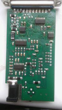

    Hello forum users, I bought a carprog from China and no testimonies on the test with the adapter pops up
    UART0 - OK
    UART1 - OK
    PIN 1 - OK
    PIN 2 - OK
    PIN 3 - OK
    PIN 4 - OK
    PIN 8 - ERROR (short to + 5V)
    PIN 5 - OK
    PIN 7 - OK
    PIN 6 - OK
    POWER - OK
    did anyone have such a problem and solved it? I bought a repair kit and exchanged all hc125 in carprog and unfortunately still crashes pin 8 error. Thank you for your reply and Regards.

    Upload photos of the adapter and mainboard cp, but 90% damaged processor.

    I checked most of the elements around the fourth hc 125 because all the time shows its damage, I desoldered in turn the capacitors, diodes, thyristors, even the circuit itself, which is supposedly damaged, I changed the quartz, each time I did the test with the adapter a9 and then there is a short circuit to + 5V, I compared my cp disc with photos of other cp's, there is nothing missing, as for operation, it certainly doesn't read any memory, unless the clip is damaged but I checked on two of the set, works after can check on astra h 1.6 and on k-line on vektra b 1.8. Below are photos of the cp Carprog 8.21 Clone: Pin 8 Error Shorted to +5V, User Experience with Repair Kit & HC125 Replacement

    This example is not entirely jert, like if you checked that the connection of the common ground with the stabilizer causes a decrease in voltage relative to the usb port and the inability to read souvenirs. Upload more pics A9

    I checked the voltage on the stabilizer on the first from the additional power plug is on both legs 4.80v on the next one to which the capacitor on the right leg is soldered 4.80va on the left 3.30v, and the memory on the power supply all within 4.78v. I am slowly losing my patience, A9 undressed twice and checked all connections according to the scheme, as well as I measured resistance on each connection and everything is 100% fine. Maybe anyone has any idea what the problem is?

    I bet on a broken processor.

    hello again I solved the problem of pin 8, after desoldering the jumper next to relay number 000, the error disappeared and the test passed carprog reads 24 and 93, but I was tempted to replace the 2r2 resistor near this relay for 1kohm and since then I have error uart1, error or someone knows what it involves and can know how to fix it. best regards
