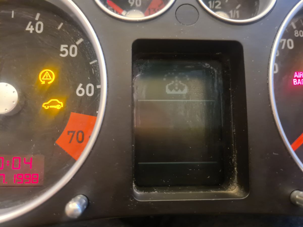

    Has anyone encountered the problem of no backlight on the fischer? As in the attached photo, it glows white. Unfortunately, replacing the display did not help. Everything else works fine.
    Record this video again without the desk lamp, preferably in a darkroom, or at least post a photo while fuel or any other warning is displayed at the top. You write that it glows white, but to my eye it doesn`t shine at all. To help you, I need to know if it doesn`t light up at all/it lights up white/it lights up yellow and not red. I know you can`t check the red one at the top without a car because:
    And what was she supposed to give...?
  • #25 20932657

    It doesn`t light up at all. None of the diodes under the display are lit. Close-up of car gauges and indicators, with one of the LEDs under the display not lit.

    This is a very strange thing, because the only thing that connects the backlight of the lower part of the display and the upper part of the yellow display and the upper part of the red display is - NOTHING, except the MCU, which works.
    Just check if someone accidentally ran a chisel through the center of the board or soldered the display with acid, etching all the vias in the MCU area. Ask the customer if all the backlight stopped working at the same time, or if he drove for a year without the upper backlight and then the lower one failed.
    Send it information from the radio via CAN or check in the car whether the red backlight in the upper part of the display is not working.
  • Backlighting issue may be caused by bad LCD joints or dump

    Hello from USA!!! I recently got one of these clusters for repair. Apparently it is common for this dash to not go to sleep and at random wake up and cause battery draw. It looks like fault is with software within mcu 2J74Y needs to be repaired can anyone confirm or has had a similar issue?
    In regards to your no backlighting issue. Have you tried to resolder all the joints for the lcd display? Also was software rewritten to this dash? In some instance where a different dump is written it will cause this behavior.
