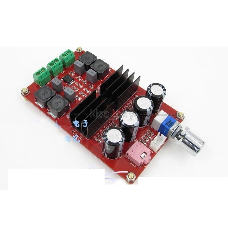

    I have such a small problem, I have just received a PCB amplifier based on two TPA3116 2x100w dice from China, something on the principle of dual mono. The problem is that the amplifier has a lot of noise, but only when the potentiometer is turned to half of the scale, the noise disappears. It's a bit strange literally at the beginning of the scale the noise is negligible when I get to the middle of the scale it is already significant when I get close to the max in the sweat it is minimal as at the beginning of the scale. Apart from that, the amplifier itself sounds really decent. I supply it with 20V, while the speakers have 4R impedance. Could it be the fault of the potentiometer itself? Is anything else causing these symptoms? The tile is exactly like in the photo.

    If it is noise, you can assume that for some reason the amplifier is excited at high frequencies - you would have to check it with an oscilloscope.

    Pure white noise is nothing else. I changed the potentiometer to another without a switch, the same thing :( I'm running out of ideas :P Everything is correct on the board :D
    Added after 14 [minutes]:
    See the movie on YT to which I gave the link, the noise is exactly the same so the guy had a brum, I don't have it. This is the first time I have seen something like this :D
    Added after 48 [minutes]:
    I just lowered the default PCB GAIN from 26dB to 20dB. Unfortunately, that didn't help either :(

    The chinols, on the other hand, spit what they could. It just hums when there is nothing on the line. Even when I have a very low level of noise, I have the speakers on my desk. Even if I pull out the cable, it sounds the same. I have better cables. I gave another power supply - the same.
    EDIT : this amplifier is set too high for me GAIN (see TPA3116 GAIN FIX on Youtube). Mine is 36dB. I desoldered the resistors R3, R4, R9, R10 and instead of R4 and R10 I gave 5.6kOhm.
    First success.
    The second thing according to the internet is potentiometer . Nobody understands why 50k B is there.
    Everyone suggests 10k A (logarithmic).
    According to the measurements with an oscilloscope, this finally eliminates hissy from the background (I just ordered one like on the board).
    Second success (yet to be done).
    I tried on a 12V LED power supply. GAIN alone did a lot. I will see the potentiometer.
    Ultimately it wants to power from the PC. Because I have speakers next to the monitor and I want it to start together with the PC. Here you can clearly hear the background of the working machine (I think I have 6 fans). I have to filter it out somehow if I can handle it (I'm not an electronics engineer). If anyone could advise something, I would be grateful.
    EDIT2 : I replaced the potentiometer with a 10kA log for PLN 5 (they were also cheaper). For me, an amateur, exchange a muck because the potentiometer has 8 pins. The exchange resulted in the lack of background noise for my needs (loudspeakers next to the monitor at a distance of 80 cm ...). I recommend
    I have not mastered the power supply from the PC. I put the signal through the voltage regulator (without lowering it) hoping it would help. It didn't help. I made 5V control from PC to a single relay (module) and separate power supply from the LED power supply, which works for me all the time. No audible and nuisance noise in the absence of sound.
