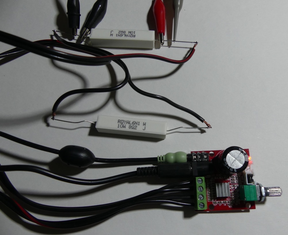

    The amplifier module with PAM8610 has a power connector, terminals for connecting speakers, a minijack input and a volume control potentiometer. The kit includes a small heat sink to stick to the PAM8610 chip. Class D declared by the seller suggests energy efficiency, while the possibility of working at 12V may allow for power supply from a gel battery. Module to be found in online stores by searching for the phrase: PAM8610 .
    The material is a continuation of the previous one with a similar amplifier module based on PAM8403 : https://www.elektroda.pl/rtvforum/topic3458041.html
    When testing the PAM8403, it turned out that the circuit at the output generates "chaff", while the current consumption is increased when we connect the 8om resistor at the output instead of the loudspeaker (with measurable inductance).
    After connecting the module with the PAM8610, it turned out that without the presence of an input signal in the speakers it is present noise louder than in PAM8403 . The attempt to listen to the music was successful, the quality is acceptable.
    The module was powered with 15V, 8 ohm resistors were connected to the outputs. In the absence of an input signal, the output is quite clear, causing the noise mentioned above:

    As with PAM8403, with PAM8610 the current consumption depends on the type of load (inductance).
    If there is no input signal with disconnected speakers, the system uses 26mA,
    connecting 8ohm speakers is 30mA consumption, connecting 8ohm resistors is 41mA, and with 4ohm resistors 44mA.
    The differences in power consumption are much smaller than with the PAM8610.

    but the amplifier module is also unusual, the output signal is very different from a typical class D amplifier, eg TDA8932.
    There are two jumpers on the board, one is closed (power on), the other is open (mute).

    Please. It was enough to add simple RC filters to the outputs to show the audio waveform. The oscilloscope math function puts two waveforms together and we have a sine wave.
    The tip works in the bridge, so you should not connect the mass of the oscilloscope to its output. It is possible if the mass of the oscilloscope / generator are not connected to each other, e.g. with ground. But the resulting waveform will contain a large component of 50hz mains noise.
    The oscilloscope now shows that the modulation used is unipolar. For one half of the signal, one output is grounded (PWM drops to zero fill) the other is modulated (PWM increases from minimum to maximum). For low signals, we have bipolar modulation, on both outputs there is a PWM signal with low filling.
    Another important piece of information is the large gain of the module with the value of 32dB or 40 times, which gives the sensitivity of 200mV.
    The PAM8610 circuit has the ability to adjust the volume using DC voltage. I think there are two types of volume control modules. In one there is a mono potentiometer which, by changing the voltage on the appropriate pin, regulates the volume. In the second stereo (in the picture above), it probably only changes the attenuation of the audio signal. In the black modules without pot, the volume control is turned off and the full gain is 32dB.
    Scalak also has differential inputs to avoid the hassle of the mass loop, as far as I can see this has not been used in the modules.
    One should also mention the power supply of the module. PAM8610 works in the voltage range 7-15V (max. 16.5V). With a load of 2x4ohms and 12V, the output power reaches 2x15W for audio waveforms and high efficiency, it will give about 1A of average power consumption (average power for music is about 30% of maximum power). It might seem that a 12V 1A power supply is enough to power it. Unfortunately, it may not be enough, because the maximum current pulses reach over 5A! 1-2A power supply may turn off! Using a 5-6A (> 60W) power supply seems pointless. The unregulated power supply is also dropped due to the large voltage drop.
    In fact, the only sensible power supply is a 12V battery or 3 Li cells.

    A simple module test developed into an interesting discussion and experimentation, I like that.
    What element values did you use in output filters?
  • #17 17208429
    irek2
    Level 40  
    Posts: 6141
    Help: 435
    Rate: 387
    On each output 4k7 and 10nF to ground. Output to the oscilloscope with capacitors.
    Such values give the limit frequency of about 4khz, so they filter the carrier well, which is about 300khz, but you can watch the signal of 1khz or lower.
    I also tried the filter twice on each output and one capacitor between them and the oscilloscope. The waveform was ok, but the mass of the oscilloscope was connected to the output of the amplifier and there was a lot of noise at 50hz.
    Sometimes I use a filter as shown below or the same capacity is only half the size. This one is suitable for measuring bandwidths up to around 20kHz and a 1kHz square response. It is a passive filter so it does not make "ringing". I also use LC filters and active 20khz 54dB / oct to measure noise and distortion. In the future, he will probably assemble the AES17 filter, because there is a schematic available.

    Unfortunately, this is class D, which means it sows after all :)
    Shielding, filtering, playing and fighting it can only take place on a specific example, because first you have to see / hear what you are fighting.
    I have also ordered the OEP30 module, it is not afraid of 24V power supply. The catalog has better parameters and is half the size! We will see how the comparison will be made :)

    Some time ago, while placing an order for electronic parts, I bought a module for PAM8403 "by the way". It made a very positive impression on me, so I ordered several modules for the PAM8610. Black module, no PCB potentiometer.
    After the first enthusiasts, unfortunately, a serious flaw of the system emerged - it is not suitable for heavy playing. The system starts to fade with strong control.
    I see the circuit primarily as an amplifier for a portable loudspeaker - and here the realities are that it was played "just louder" more than once, and the fact that it wheezes did not bother anyone at some point. This is how my previous TDA1557Q product was tortured, which I decided to replace with a "digit" in order to extend the battery life and, unfortunately, as it turned out, PAM8610 is NOT SUITABLE for such use. You can forget about working with a 2x4R load. even on 2x8R (and audible distortion) it likes to turn off. I will add that it is rather an overcurrent protection, not a thermal one, the amplifier behaves in the same way with small heat sinks on the chip and under it, as well as after their complete removal.
    It is a pity, it was close to the 'ideal'.
    The amplification is "hand in hand" - practice has shown that not every phone has a sufficient signal level at the headphone output to fully drive the amplifier.
    A few more dB of reserve would be good here. Well, unless these modules are not set to maximum gain? Because to be honest, I did not check - it does not make sense, since you have to be careful not to overload it anyway, because it will turn off ...
