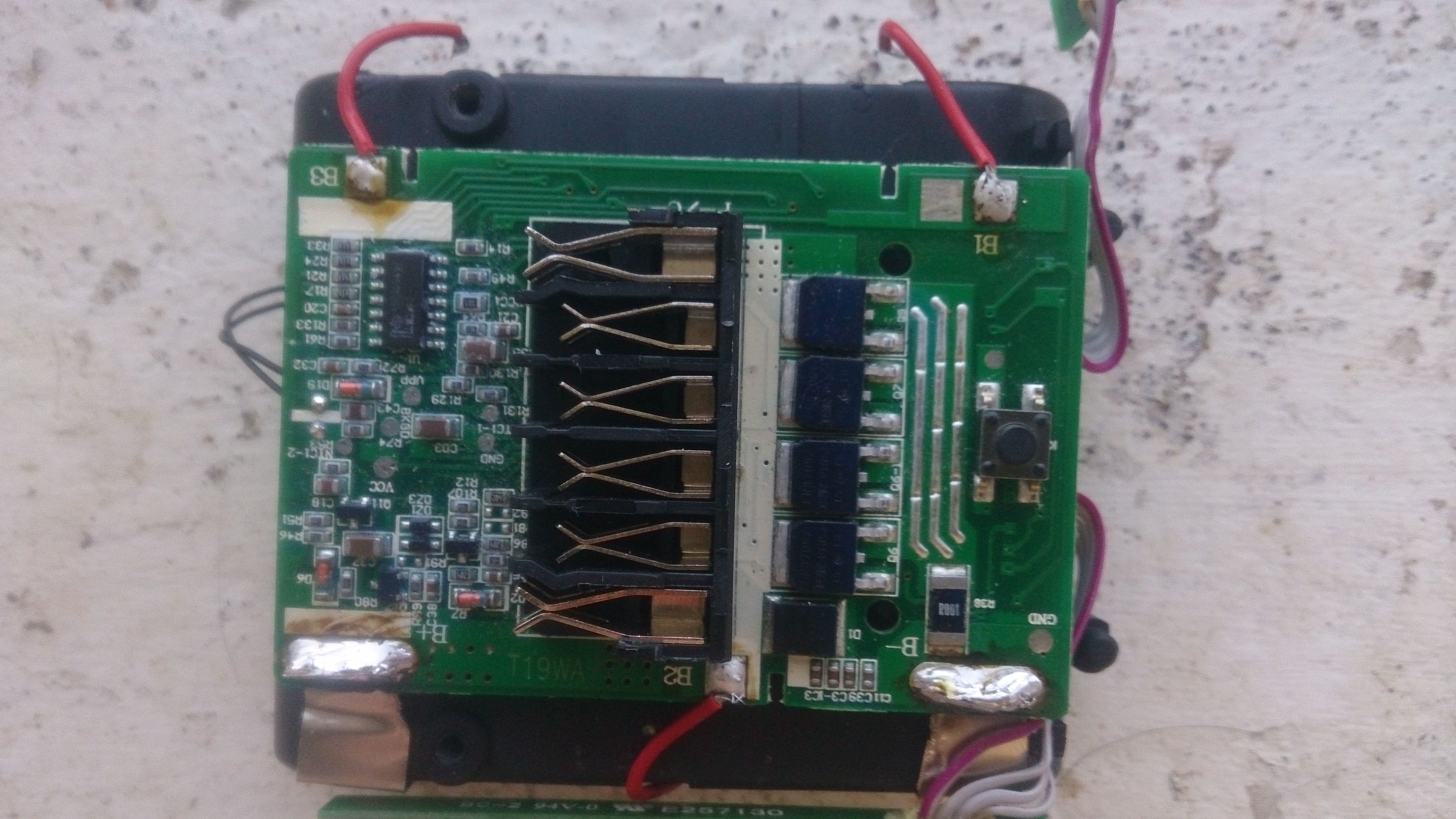

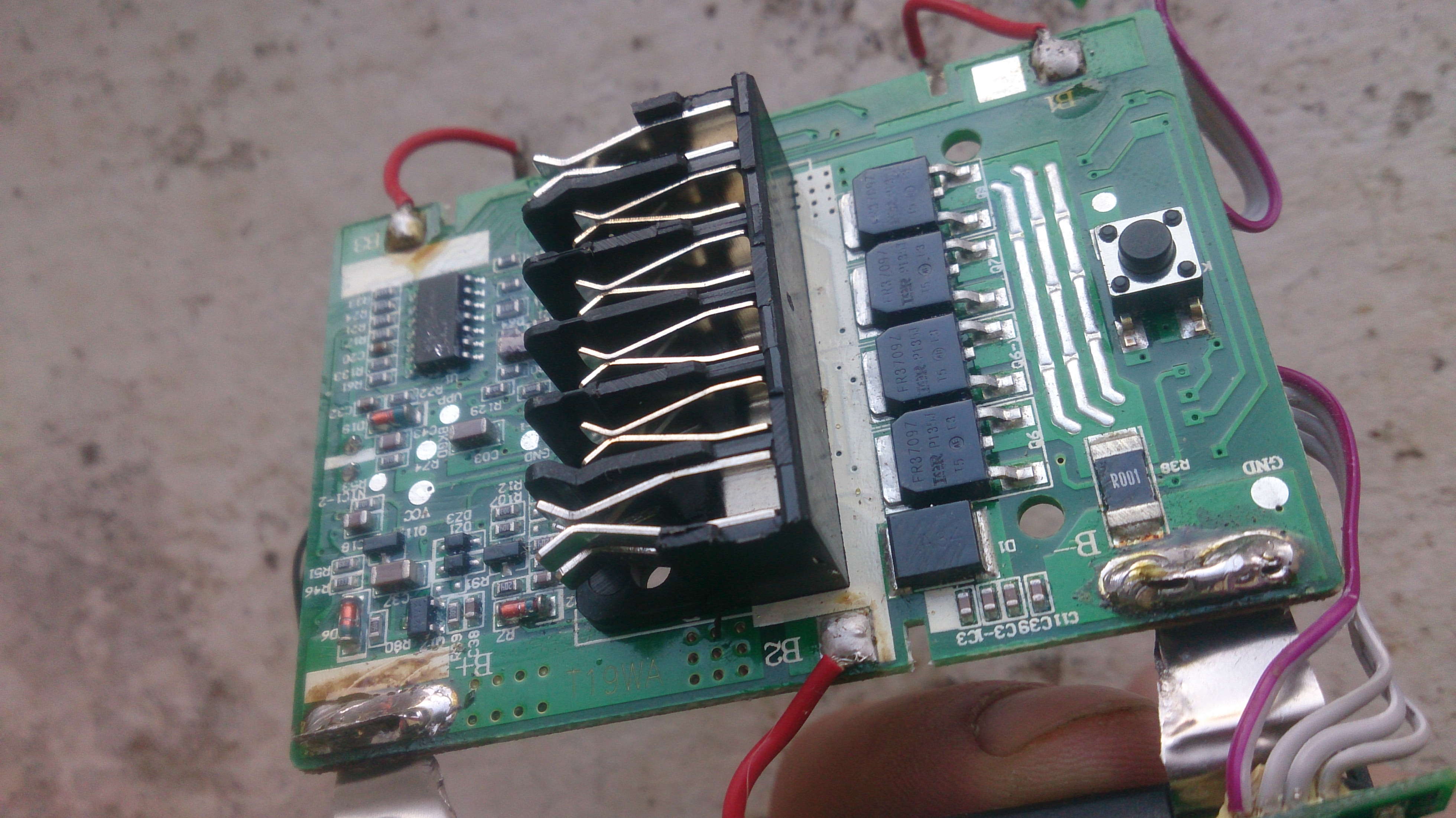

    Hello, I purchased a screwdriver with Li-ion battery.
    I replaced the cells for efficient, high-current ones but the symptom is that the charger does not charge the battery and the screwdriver for a moment lights the diode and nothing more. When the button is pressed, the voltage on the battery drops to 0V as if the electronics cut off the current.
    On the cells themselves, I currently have 3.6V on each, cells inr18650-25r.
    And here is the question, how can I charge these cells one by one with a suitable charger from 18650, just a question whether I can completely remove this electronics and use without it on the basis of charging outside and working without internal. security, of course, taking care not to over-discharge the cells?

    Show me what electronics are there. Write down the symbols of the chips, etc.

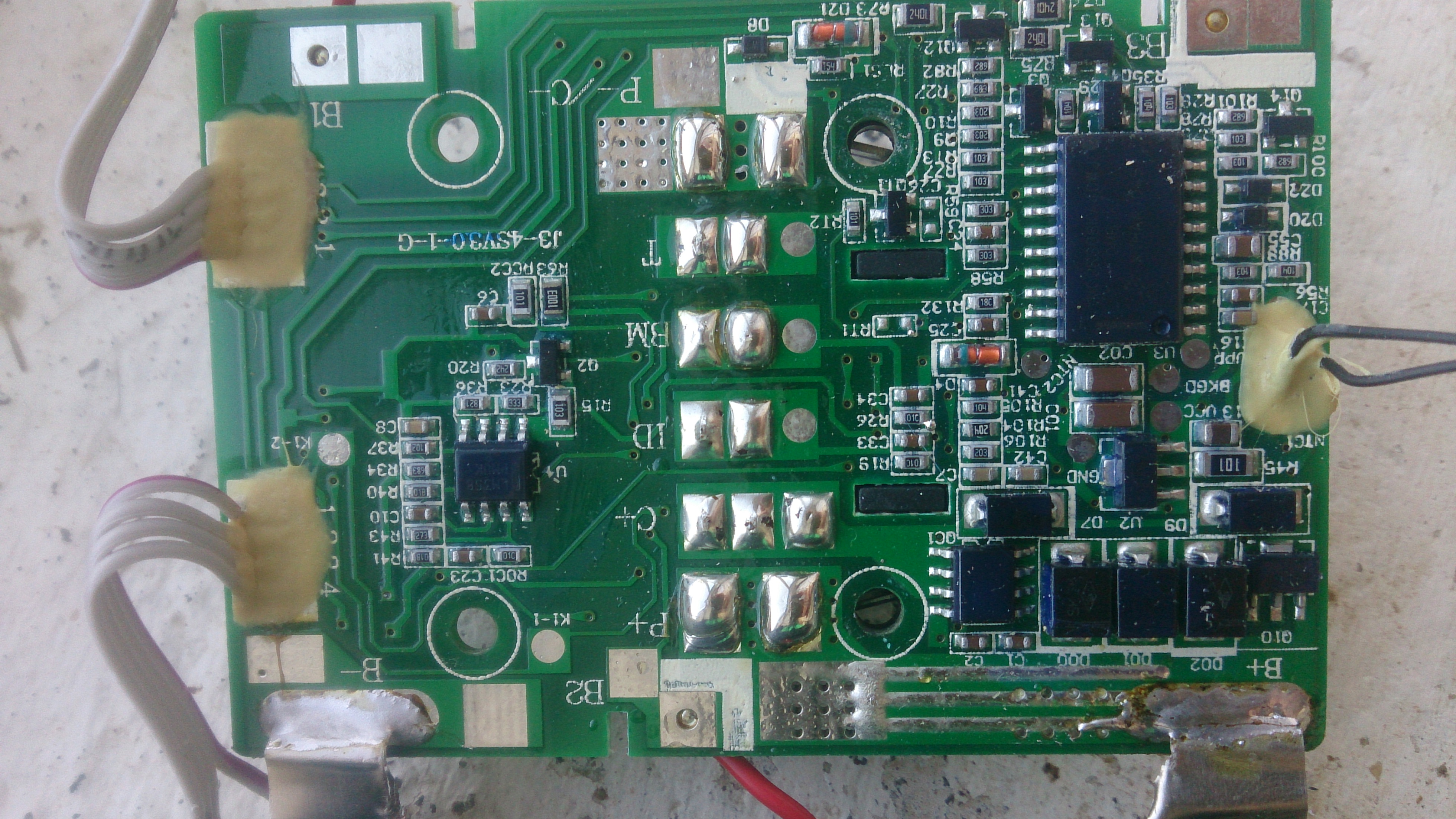

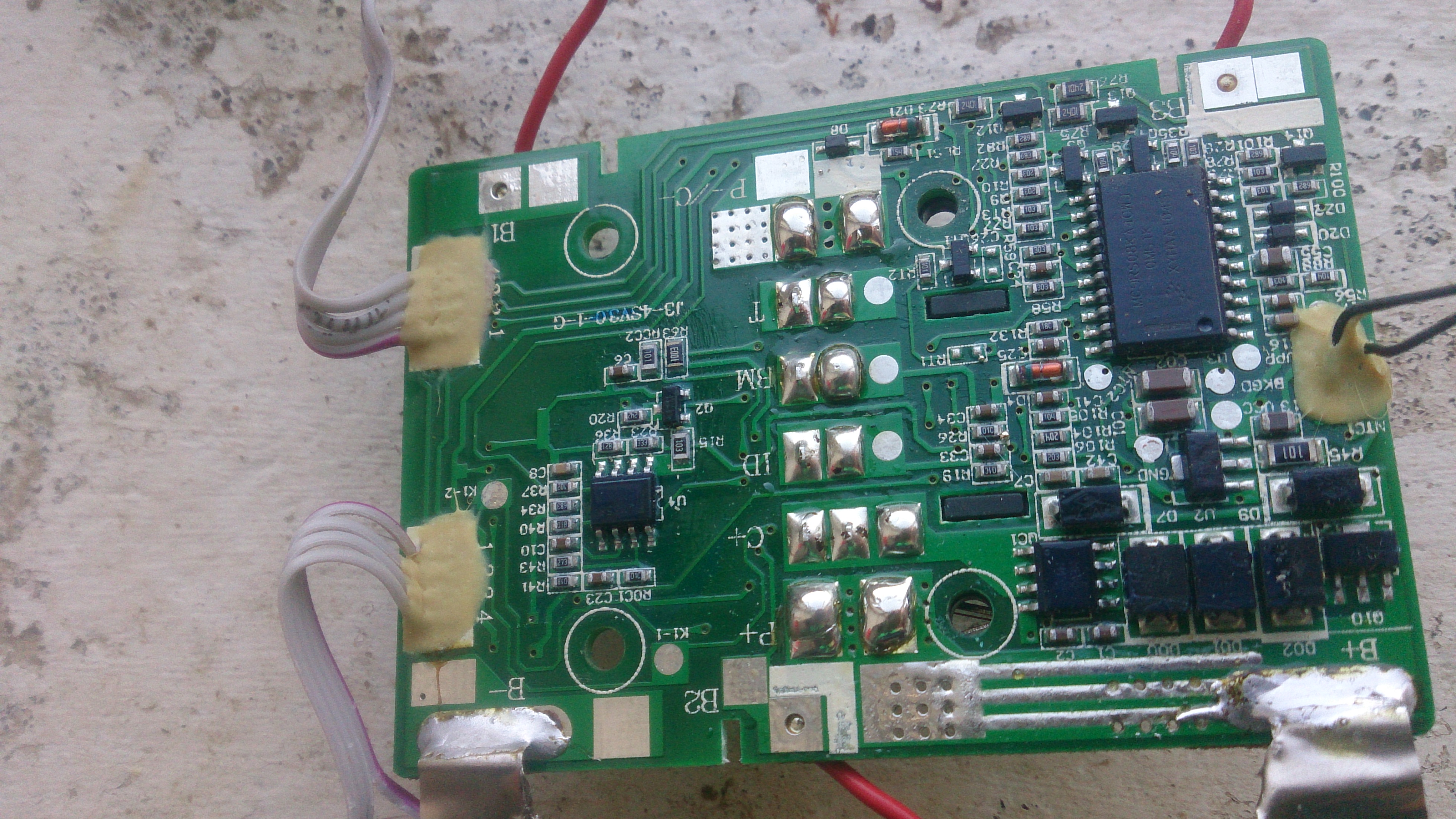

    What was written down:
    15pocs463 lm2902
    A34
    Fr3709z
    Mc9rs08ka4cwj 0m51k xyha1045
    Sk36
    LM358
    Niewyraźne chyba ME4435 m132-2

    The equipment was successfully repaired. The electronics are functional, the switch was damaged and it caused the short circuit protection on the battery to work, after repair the screwdriver works properly.
