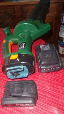

    I have one more question I have another boxer screwdriver with two batteries that I bought for a funny price after a year of use, the batteries went down, the charger claims that they are charged and the screwdriver is discharged (only the LED diode will flash for a moment - the flashlight function), they currently have voltage from 10 to 11v I understand that the circuit board is to blame, because by connecting the screwdriver for a short time the engine works, the battery looks like this;
    Einhell Screwdriver: Replacing NiCd with LiOn Cells & Compatibility with Original Charger Einhell Screwdriver: Replacing NiCd with LiOn Cells & Compatibility with Original Charger Einhell Screwdriver: Replacing NiCd with LiOn Cells & Compatibility with Original Charger
    In this case, I just need to convert the output and batteries to such a board?

    It is not necessary to drop the plate in the Boxer because one battery can be dropped and the BMS PCM protection detects that under load its voltage drops below the minimum 2.5V and STOP !! limit.
    The charger charges up to 3x4.2V = 12.6V (3s-1p package) and in the dead battery the voltage increases quickly and is supposed to be OK. After direct connection, the screwdriver properly spins on two links.
    The proposed BMS PCM module is ok, has the right current and is up to 3s but as far as I know Italian there is no balancer (it is not necessary but advisable). And how to connect the original charger that has a third temperature contact, and if it is not connected, it will not move.
    Returning to Einhel 10x1,2V = 12V but max is 10x1,45V = 14,5V. BMS shown is 4S, i.e. as I wrote below 4S (14.8Vmax16.8V) so the voltage is too high and can damage the screwdriver, I advise you to give 3S-1p or 2p and BMS 3S (11.1V-max 12.6V). As for the original charger, the voltage will be OK, but you need to examine what current it gives when the battery is discharged ~ 8V (for 3S-1p max 2A for 3S-2p max 4A) and whether it has a temperature contact (it is necessary to leave the thermostat because it will not start)

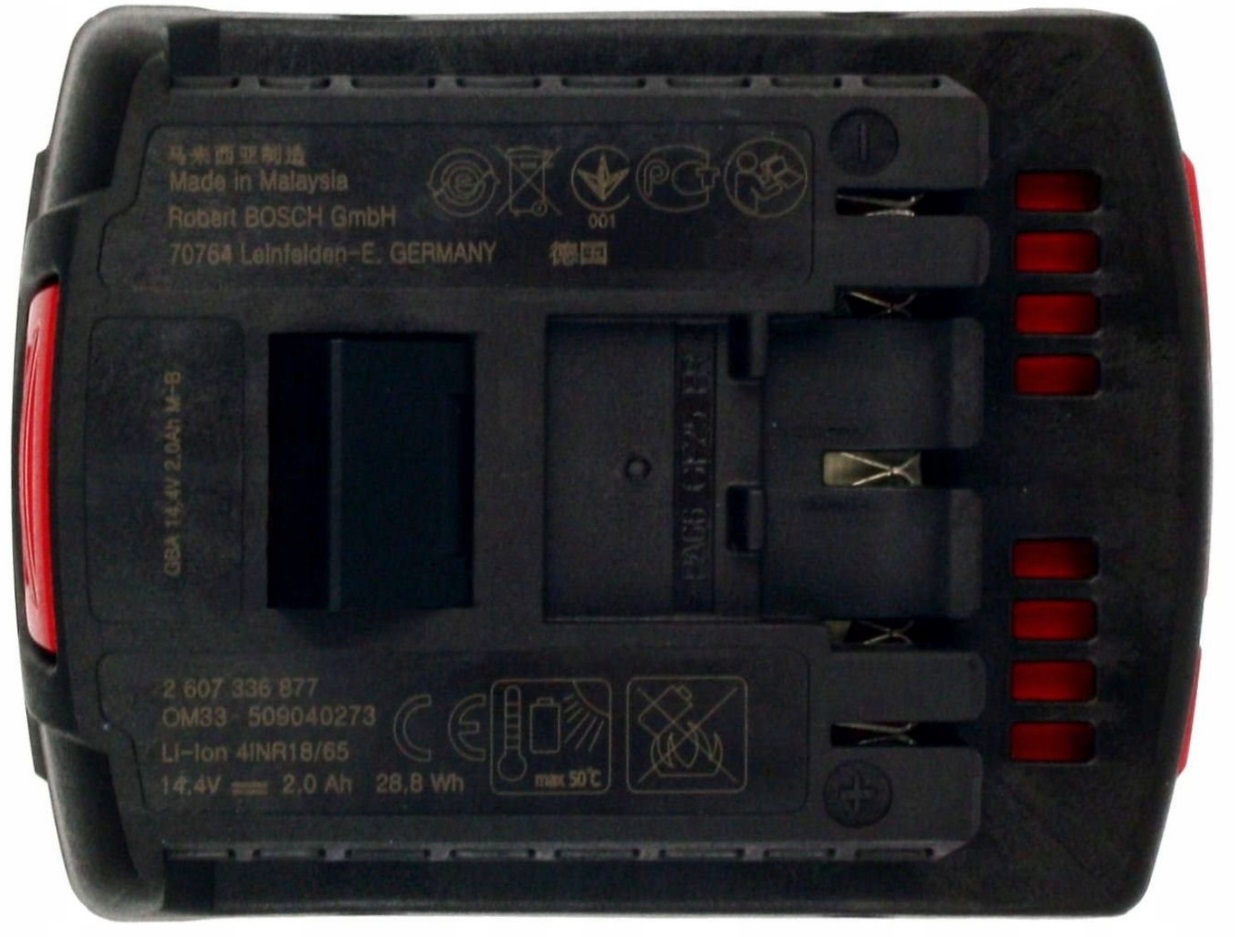

    As you can see on the photo, ACU BOSCH has 4 contacts and BMS 5S (18V) needs 6 connections, so the Robert Bosch battery should be built-in BMS maybe even with a balancer. Aku are protected in it against excessive discharge, overcharging and maybe short circuit. The BOSCH charger gives the right, limited current (because Li-Ions swallow / give away everyone EXPLOSION !!!!) and probably checks the temperature.
    To sum up, if there is voltage on the ACU contacts marked "+" and "-", two cables are enough to connect the adapter with an old screwdriver and a polymer fuse is installed in the screwdriver (we disconnect / cut one wire and connect it again with polymer - irrelevant polarization).
    It is different for BMS 4S (14,4V) because it needs 5 connectors, but the battery as seen above has 5 contacts so it can be different i.e. the same as I described above or the balancer in the charger but probably not because the chargers have 4 contacts. However, the battery is certainly not bare (without electronics) and should have at least excessive discharge / short circuit protection.

    Well no. I am outside the home so I have no way to get to the battery and attach a photo but I will use the instructions found in the meantime to demolish the Bosch Li-ion 14,4V battery:
    https://www.ifixit.com/Teardown/Bosch+GBA+Battery+14.4V+1.5Ah+Teardown/112253
    1. "The PCB houses 5 spring jaws total, two on sides are GND and VCC, inner 3 are connected with resistors and are used to monitor battery temperature during workload and charging."
    2. "There is no control board in the battery cell, which really improves the durability. The function of control board was moved into the charger and the drill."
    So it turns out that Bosch, however, gave up electronics in the battery and placed it in the charger and the tool ..
    I have twin batteries but 2.6Ah and most tools at 14.4V. It must somehow pair :)

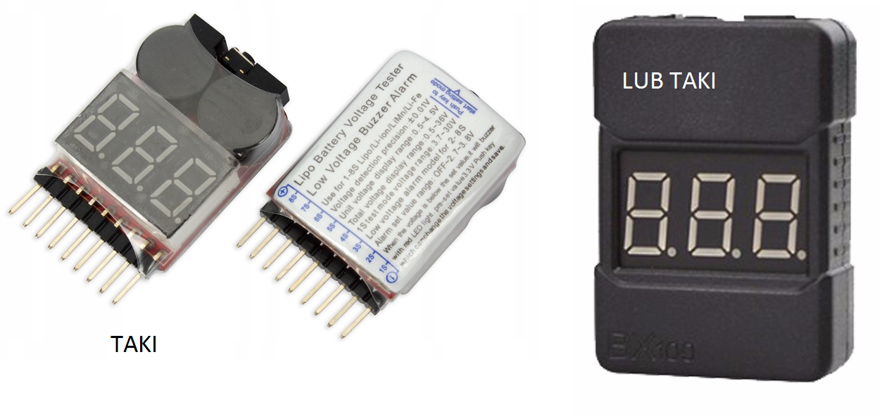

    Well, Robert B saved. Acu has no BMS or balancer but only output for temperature control. The charger has a charge and temperature control and the screwdriver a current limiter and probably control of the entire ACU discharge below 11-12V.
    I would not combine with the BMS building since you have the original AKU and charger. All you need is a polymer fuse and careful operation (discharge). If you fancy more checks, you can paste a voltmeter, diagnostic module in the ACU:
    https://allegro.pl/oferta/woltomierz-tester-napiecia-ogniw-1-8s-li-ion-18650-7559247510 Einhell Screwdriver: Replacing NiCd with LiOn Cells & Compatibility with Original Charger
    https://allegro.pl/oferta/woltomierz-tester-napiecia-ogniw-2-8s-bx100-7568579956
    There may also be something like this in a screwdriver:
    https://allegro.pl/oferta/wskaznik-naladowania-baterii-4s-16-8v-niebieski-fv-7557367317
    You can also like this + fuse:
    https://www.youtube.com/watch?v=7W3-M50uE8w
    But it's better with BMS:
    https://www.youtube.com/watch?v=Mlas6T-8E18
