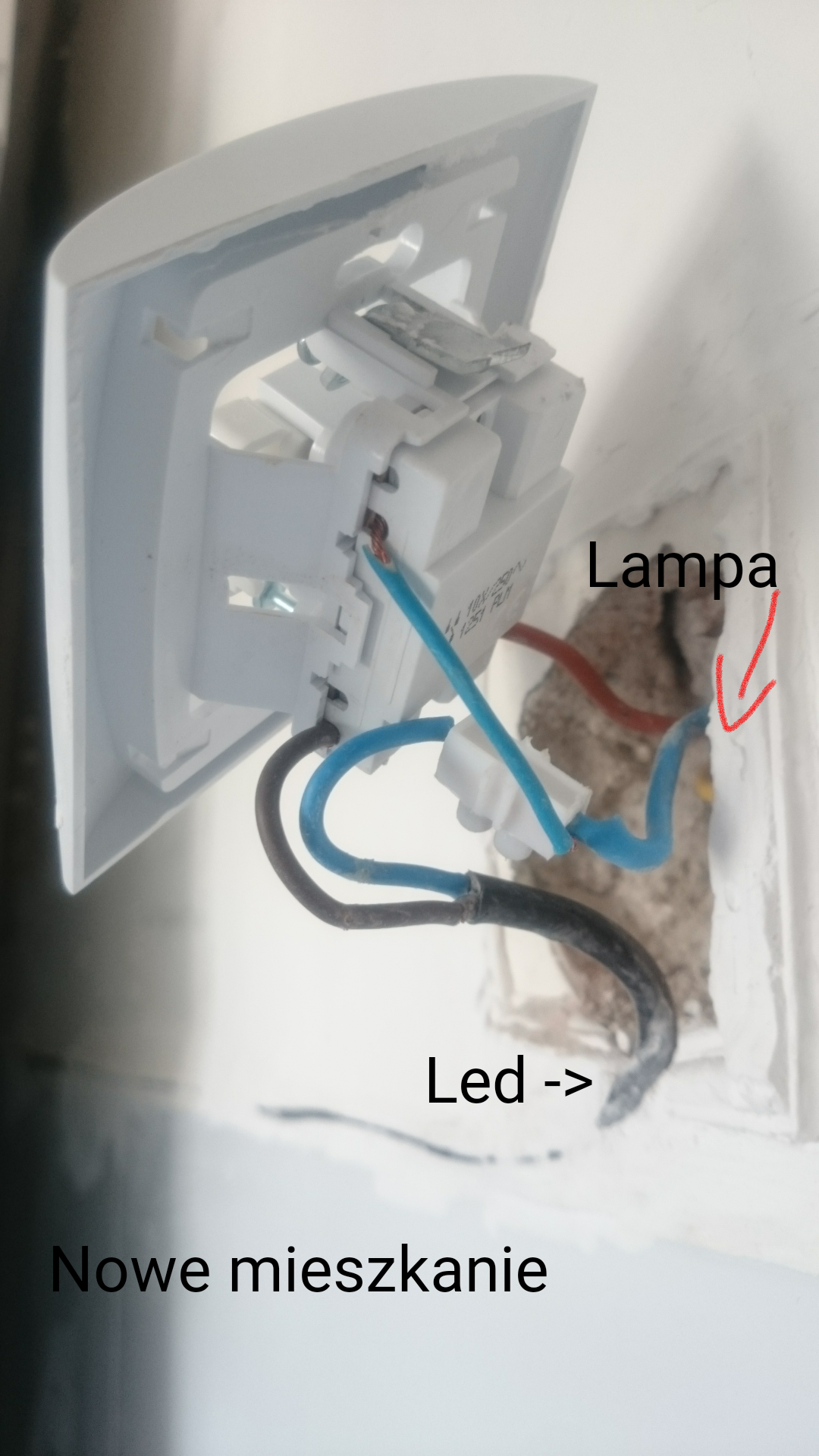

    Hello, I say in advance that I am an amateur and I am in a full stop :-)
    I am after moving and connected leds to a double switch and how to ignite the top it normally shines and when I turn on the LEDs that are under the cabinets that blink at the same time with the upper bulb: - / on the previous apartment everything was ok Mountain and LEDs worked separately elegantly in the new apartment I have a new switch (without this diode)
    • MOV_1949.mp4 (82.51 MB) You must be logged in to download this attachment.

    You have wrongly connected the dual switch, take a picture of the connection or describe the way you did it.

    Zero bridged as far as you can see and the same was connected to the old apartment

    After analyzing the effects from the video, that is:
    - light bulb lighting up
    - the bulb is gone
    - lighting of LED lamps
    - LED extinguishing
    the loop begins
    - a smooth light bulb
    This effect is a serial connection of a light bulb and LED lamp, I will describe what happens in order:
    -loading the inverter capacitors (up to LED) by the resistance of the filament's filament lamp is a smooth lightening of the bulb, after reaching the state of charge, the bulb goes out
    - the inverter activates LED lamps
    - the inverter disconnects the LED due to insufficient efficiency, caused by the bulb resistance in series, recharging without attached LEDs
    - liquid light bulb, after charging - switching on the LED
    How does it look in cables? You have to take a probe-bulb (not a neon lamp) in the grip and look for a mistake. In my opinion, N replaced with a common point of a light bulb-LED lamp, the diagram looks like this:
    LED Lighting Blinks When Connected to Double Switch: Differences Between Old & New Apartment Setup
    - connecting the bulb - correct
    - LED connection in a row with a light bulb and flashing
    - simultaneous activation of two switches - only the light bulb shines, because the LED is a compact bulb switch

    Hello, today was another attempt to solve the problem and nothing will show how I connected and what connection I had to an old apartment where everything worked LED Lighting Blinks When Connected to Double Switch: Differences Between Old & New Apartment Setup

    Either something is wrong with me or what is happening here ...
    Look. Let's analyze it in a photo from your old apartment ... you're sure it worked, I wonder what electrical has to be there trick if such a thing could fulfill its task.
    Now look at the 2 attachment I paste. This is the screen of your photo with notes.
    1. Why do not I see the phase conductor from the box? There are only wires from lamps and LEDs. What did you power it and how?
    2. The phase wire, which should run to the lamp is plugged in, just the phase wire, which you should power and led and the lamp.
    3. The phase conductor for the LEDs is connected to one of the 2 terminals. THIS IS OK. The lamp should be plugged in underneath the other one (or its phase wire exactly). So why are the N wires and led wires connected to the other terminal ???
    You have the arrows drawn in such an important program "paint" as it should be done. On 1 terminal phase conductor running from the protection, and for subsequent clamps phase conductors of lamps and LEDs. Neutral wires should not take any part in the circuit breaker. Perhaps in an old apartment you have already been so tired that it worked, but in a working NORMAL installation, there is no law.
    In the first attachment you have sketched how it should look. Please note that the blue wires (N) are not connected to the switch. If you do not know how to do it, ask an electrician or someone who has electrical qualifications.
    I corrected the text.
