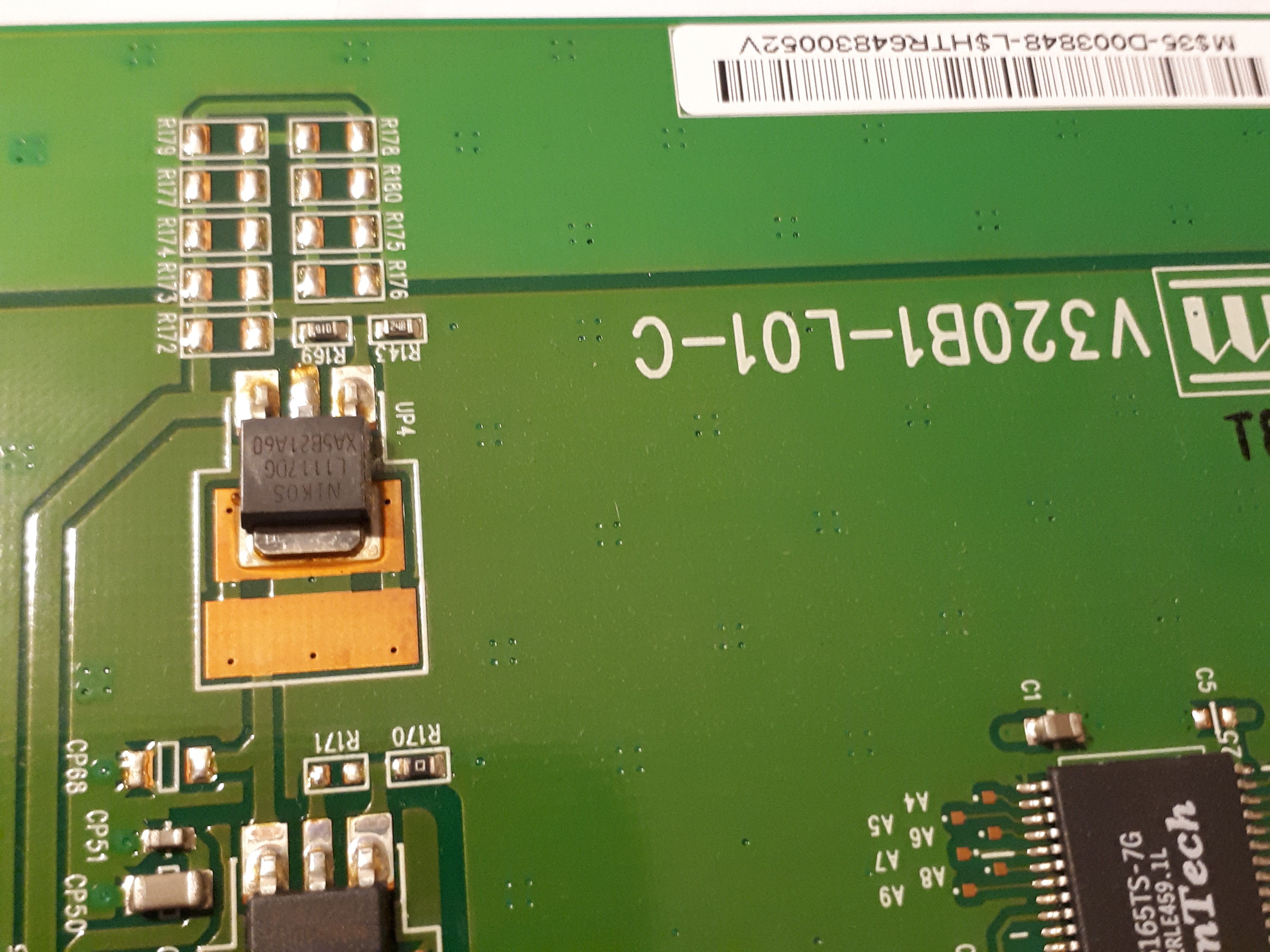

    according to the information on the net, I want to try to fix the T-CON first and then replace it.
    I have a V320B1-L01-C, i.e. a V320B1-L01 matrix
    The problem is that I need two pieces of information from you:
    - what is the package of the NIKOS L1117DG stabilizer - I can see it's TO-252?

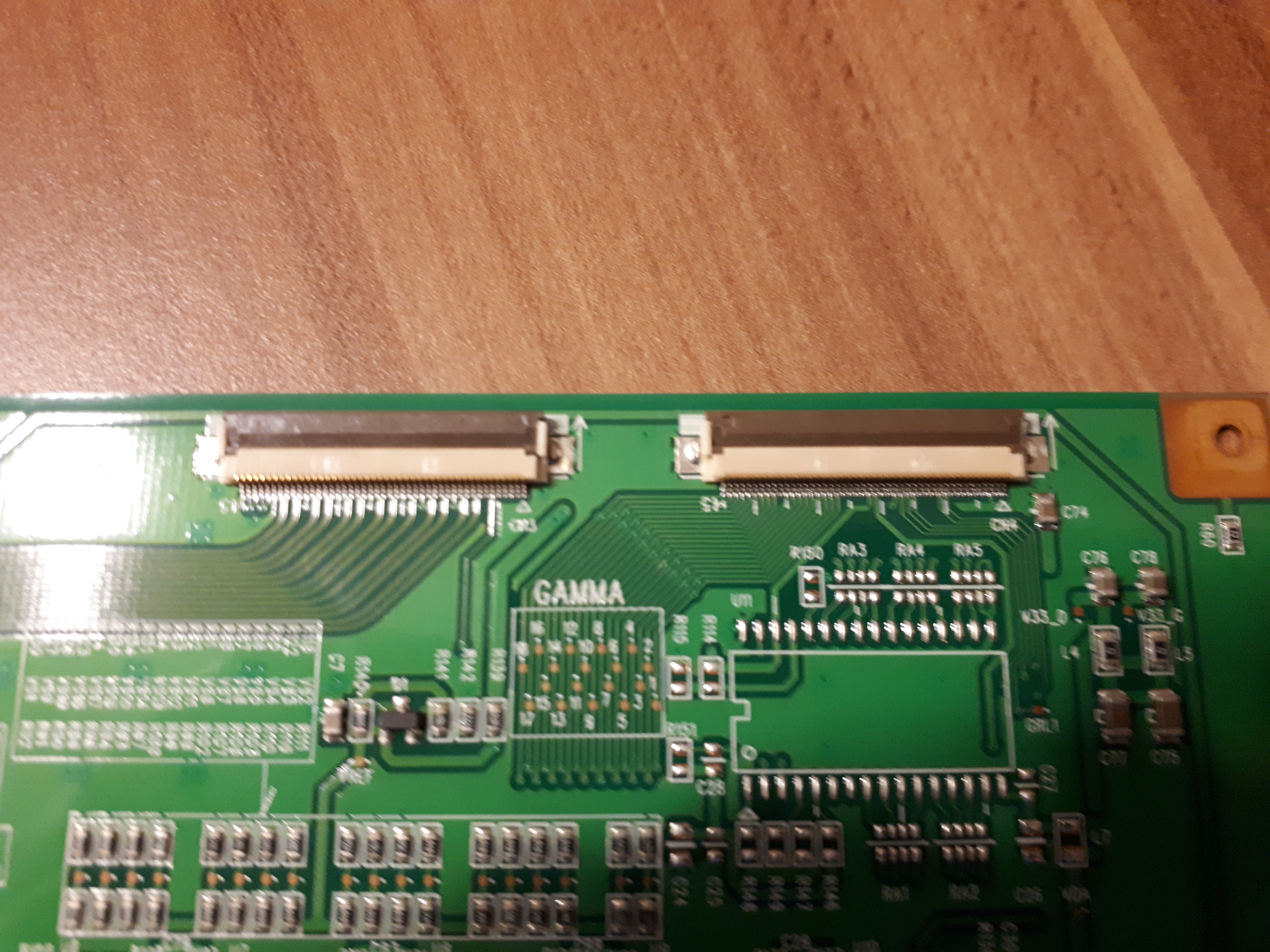

    - what type of plug is it? I broke the side hook when removing it, but I don't know what the plug is ...
    Do you have a ruler at hand? ;)
    And is the fact that there and other housings fit sometimes not visible? ;)
    criter wrote:
    i want to try to fix it first
    Then buy a damaged module with such a connector. It will be faster. ;)
    And finally, and maybe at the beginning, tell me why you want to replace (as I understand it) this particular stabilizer.

    criter wrote:
    Why this stabilizer? here is an explanation
    But the symptoms are not yet a sign of anything.
    The symptoms are the same, and the cause may lie somewhere else. So maybe at least a little diagnostics? ;)

    I managed to do it, although I replaced the T-Con, because it was at a good price with a Chinese, and I did not repair ...
    After replacement, it works as long as no one knows it ;)
