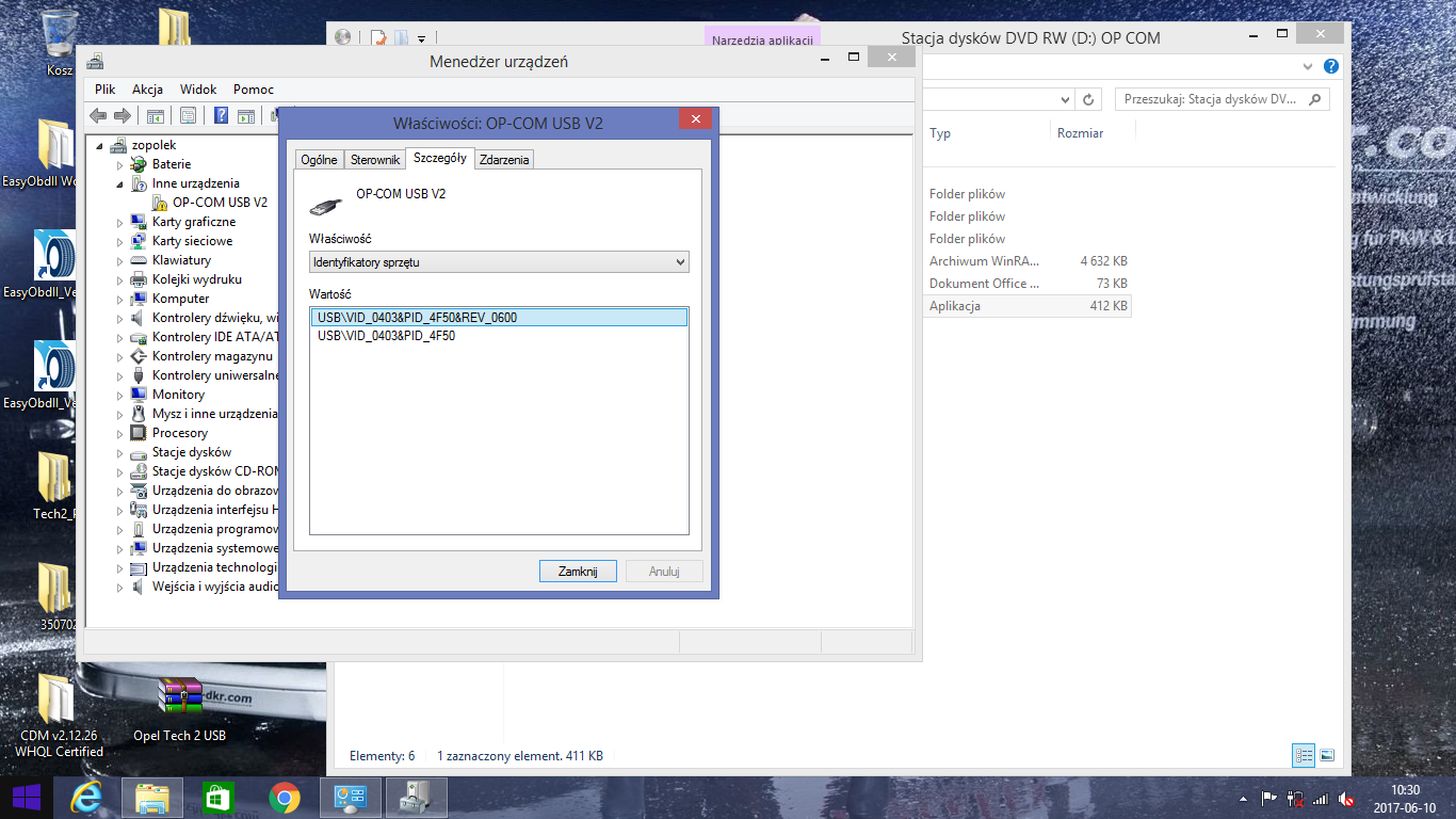

    Hello. I need a driver for the obd2 cable, unfortunately the driver attached to the cable does not work (the windows system encountered an error and the installation could not be completed) I will add that it is windows 8.1. Adds a hardware identifier

    Download these from the chip manufacturer: http://www.ftdichip.com/Drivers/D2XX.htm
    Then modify the inf files adding the identifier you have given like this:
    https://www.opelclubfinland.fi/viewtopic.php?t=197883&start=405
    the same you have given here:
    https://www.insignia-club.pl/viewtopic.php?f=21&t=310&start=720
