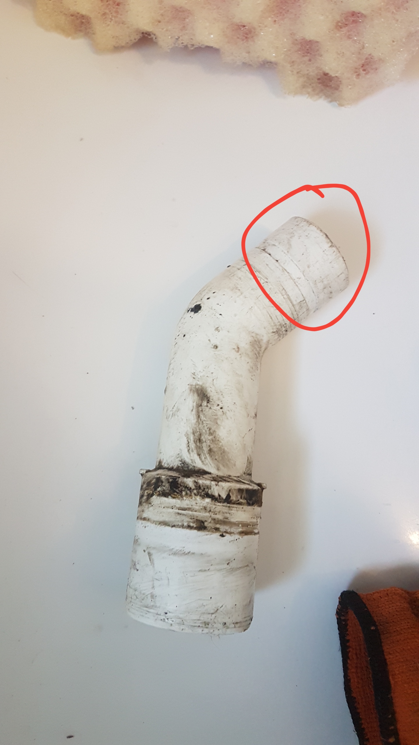

    Hello, I have a problem,
    Water flies from the place marked on the picture. This is not much, but the sumarum sums up the space under the bathtub. Can anyone do what?

    Loosen this nut, the one on the right, on the right. Undress, clean the whole, twist and act.

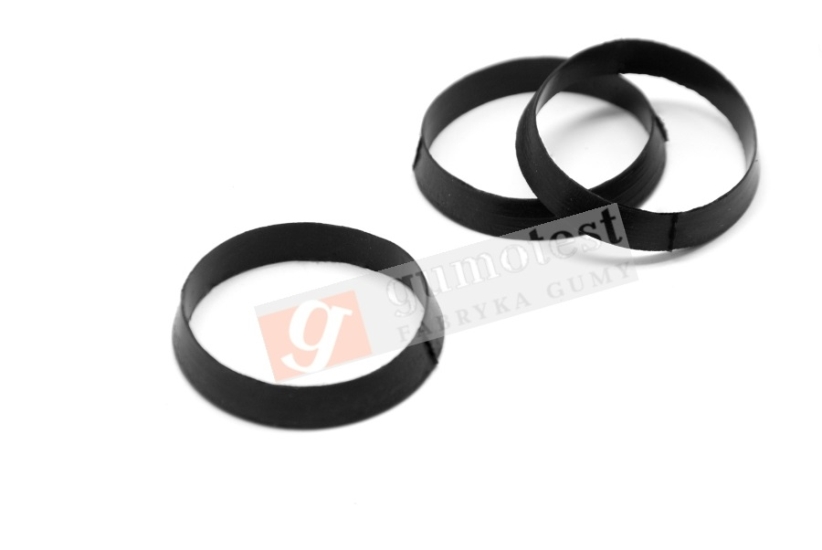

    There is a rubber seal there, more or less:
    Bath Drain Leakage: Water Running from Marked Area - Causes and Solutions (Image)
    Measure the outer diameter of the horizontal tube, go to the store with such things, buy a gasket with this diameter or similar tube, disconnect as a colleague advises above, clean, replace the gasket and ready.

    Maybe someone because of a difficult approach crooked the thread "caught" and when the next hand did not give advice to tighten it so left it?
    Buying new elements (cheap thing) and correct assembly will eliminate it.
  • #7 16531093
    lol2plxd
    Posts: 17
    I know what went on, the same is marked on the previous photo as on this:
    The thread has broken thanks to which it is screwed to the rest.

    There is no thread there. There is only a rubber gasket which is pressed by the nut.

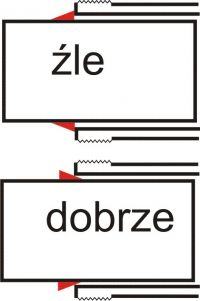

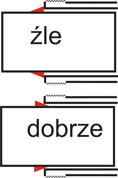

    Maybe someone put a gasket wrong.

    After traces on the pipe, I see that the gasket was put on. It was not tightened with a nut, check the first without this pipe, whether the nut is screwed to the very end, and then fold with the pipe with the gasket.

    The nut is gray with a different set and different thread pitch, you will not press the gasket.
    Change the nut to the one from the set, give a new seal and tighten it well. It will be cool.
