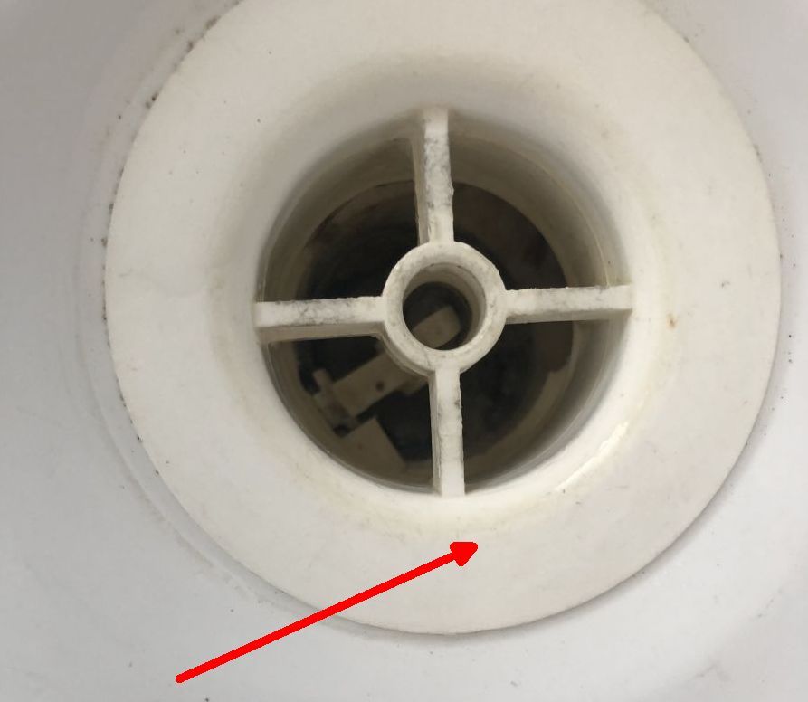

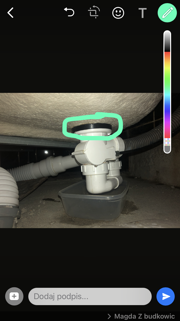

    Hello. My water is dripping in the place indicated in the photo, where the seal is. I need some advice. I am a woman and I would like to do it myself. I will add that it did not leak before

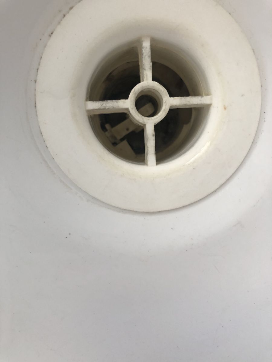

    If the gasket has not deformed or deformed, you may need to tighten the top nut (the one in the bathtub - the last photo).

    Preferably with a second person holding the rest of the system from below, as the whole thing can turn slightly and new leaks will appear.

    Hmmm...... I have yet to come across a siphon that, from the top (last photo), did not have a visible screw to tighten.
    Maybe it's deep down and you can't see it. You wrote that it wasn't leaking before, which means that the screw is rather there. This is the bolt that needs to be tightened, but carefully, as the thread is easily damaged. This is the only cause of the leak. Good luck.

    There is no screw.The two plastic parts are screwed together.In place of the screw comes the mushroom stem for closing the drain.It is lifted by the lever visible in the last photo, inside " at 8 o'clock".

    Most likely, the whole element is screwed in instead of the screw (shown by the arrow).
    DIY Guide: Fixing a Leaky Tub Drain and Seal - Female Homeowner Inquiry
    To unscrew it, you need a special key, which was included in the set. And it would be good to unscrew it and sand the unevenness on the bottom of the bathtub with fine sandpaper (where the seal is). You can also try to apply a thin layer of sanitary silicone to the gasket before installation. If you do not have this key, you can try to insert, for example, pliers as open as possible from the top and gently try to unscrew it. Don't use a lot of force, because in this case you will only act on two arms (and the key on four).
