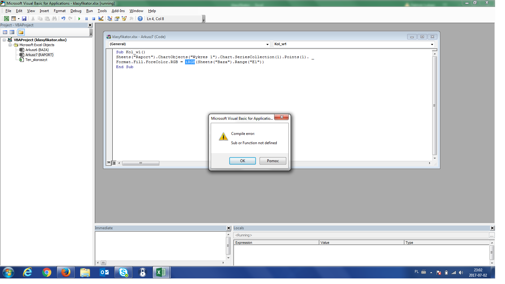

    Thank you for your help. I just have a problem with running this code. where should I paste this macro? because I have an error and nothing wants to happen :(
    Added after 12 [minutes]:
    screen in the attachment
    • Modifying Excel Chart Colors Based on Percentage Values in Different Worksheet screen1.png (135.22 KB) You must be logged in to download this attachment.
    How exactly, the message? which line is highlighted?

    #10 16565628
    JRV
    VBA, Excel specialist
    Posts: 2724
    Help: 805
    Rate: 455
    post # 6,
    2 codes - procedure and function
    add features
    Added after 59 [seconds]:
    it's all in a modula code, not a sheet
  • #11 16565724
    elfel
    Posts: 14
    revelation. it works
    thank you
