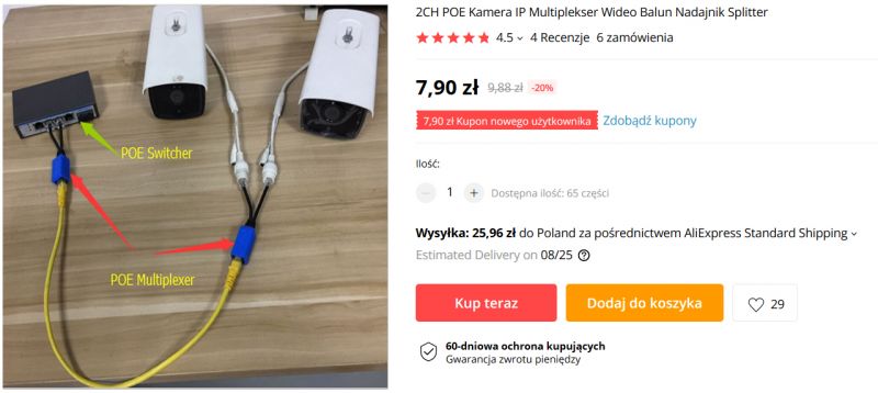

  • #15 18093007
    monsarrat
    Board Language: polish
    The Chinese have invented something like this - 2 RJ45 Splitter commbiner 2Poe
    Powering Two IP Cameras with One Twisted Pair POE Cable: Is it Feasible?
  • #17 18093829
    suworow
    Posts: 8802
    Help: 650
    Rate: 1272
    The Chinese invented this first and foremost how to make a wall out of a client. Your colleague may as well tighten two RJs on both sides of the cable. One e.g. on orange and green steam, and the other e.g. on blue and brown
    There is one condition. The switch must supply power to the signal pairs. And this is not always the case :)

    arkadiuszj1987
    Posts: 16
    Rate: 9
    I would like to hook up on the topic.
    I connected 2 ip dahua cameras on one UTP cable from the @potpot entry using pin 1236 and there is a very strange situation.
    Cameras work, however, only when it connects one of them to the PoE switch, when it connects both works the way it was connected first.
    What could be the reason?
