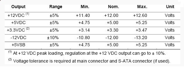

    It's your PC and I will say that such a PSU can damage the electronics, give the link, maybe you have not seen it and change your mind Black list of power supplies and renowned power supply brands
    Hardware
    Check how the power supply works under load, and more precisely its voltage on individual lines + 12V, + 5V, 3.3V. The power supply should meet certain voltage and fluctuation norms, as regards voltage standards, please visit Elektod at the Department - Computers -
    How to measure voltage with a meter?
    Voltage norms on individual lines.

    Myrasz wrote:
    Unimportant power supply, because there is nothing to do in this case,
    If you know best, why do you ask for help?
    Did you take measurements?
    https://www.elektroda.pl/rtvforum/topic1199202.html
    Have you checked the state of the capacitors on the board, card and power supply?

    Myrasz wrote:
    before writing the thread I checked all the voltage of the power supply, I looked at the motherboard, I did SMART, RAM, load GPU \ CPU tests and in no case did I receive any disturbing results.
    And such information should be included in the opening post, because no one here is a fortune teller to know what you have done and what knowledge you have about it.
    Since the problem concerns only one game, the reason may be a prosaic damage to one of its files.
    Voltage from the power supply is not everything. The reason may be pins, which you will not measure with a multimeter. The oscilloscope or substitute of the power supply remains hardware.
    - "SZPILKI", so these are these fluctuations, for example (from 12.18V to 12.23V) I associate well?

    These are not voltage fluctuations. Stilts or voltage peaks are short-lived and sharp. Not measurable with a multimeter and in poor power supplies can exceed the admissible values several times. They cause, at best, disruptions in the operation of the motherboard and other components, and in the worst case, their permanent damage.
    :lol: You bet too little. I watched on an oscilloscope with values over 18V on the 12V line and over 9V on the 5V line.
    Measurements that the author has no idea about.

    I do not know if I am carefully measuring the voltage from my XFX TS 550 Watt, but it was such a difference: nothing happens to the PC.
    - on the desktop, 12.15V and 0.00V
    - under stress: 12.25V and 0.001V
