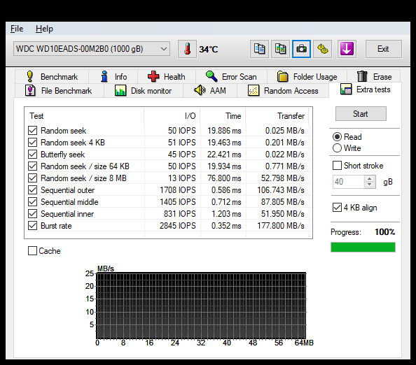

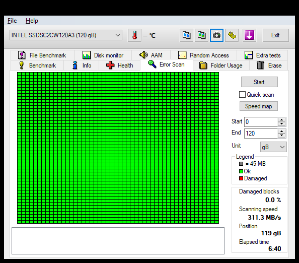

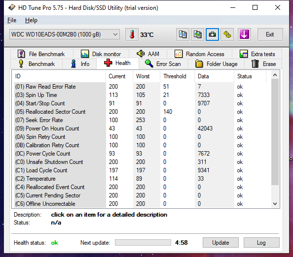

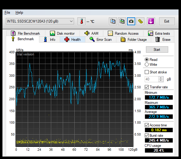

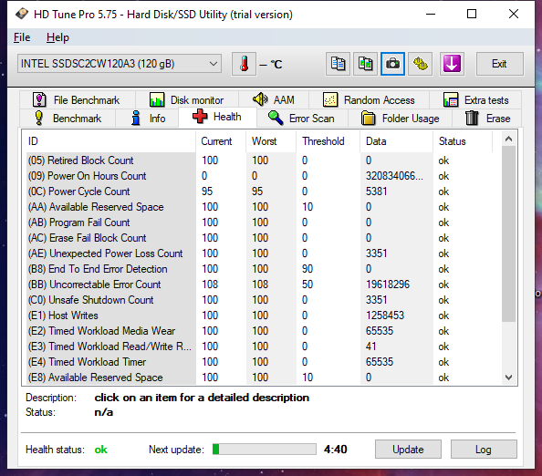

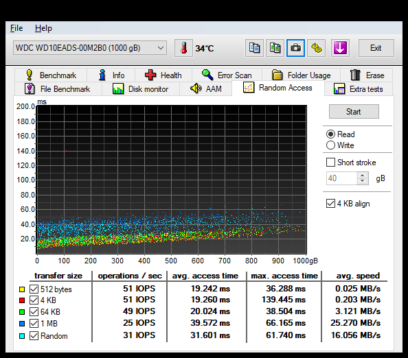

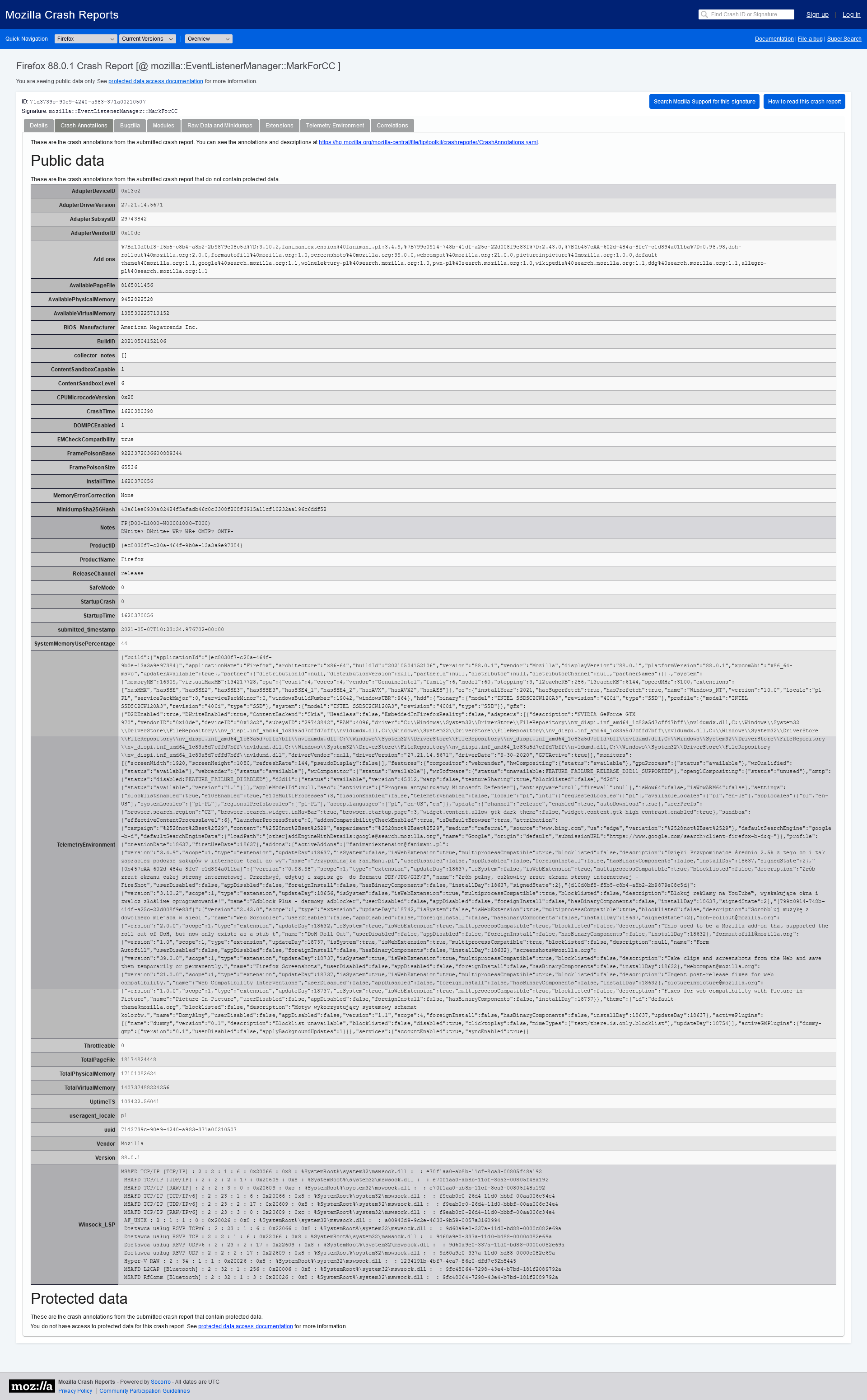

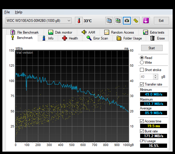

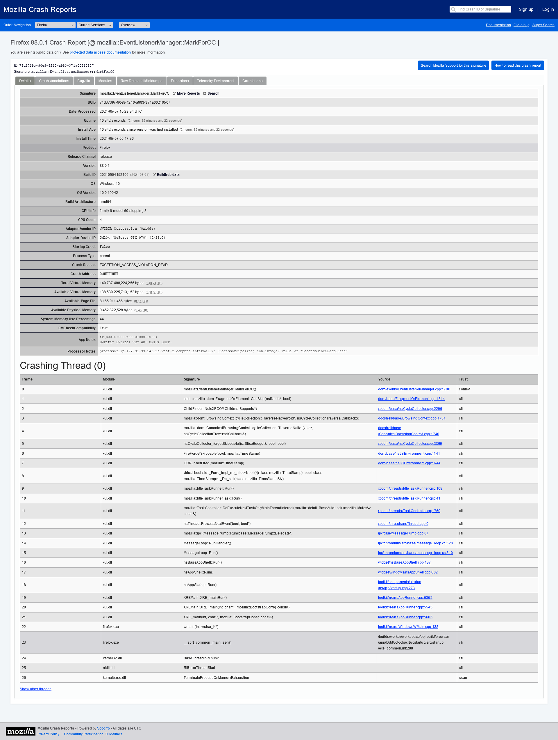

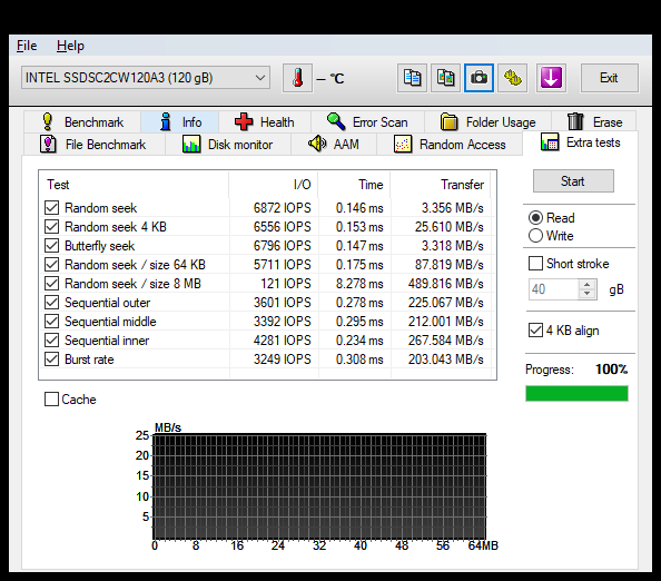

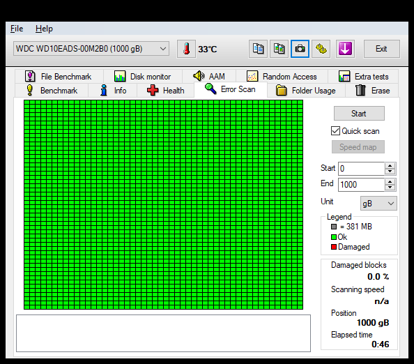

    In the attachment I am adding screenshots from the Firefox crash + scans from HDTune.

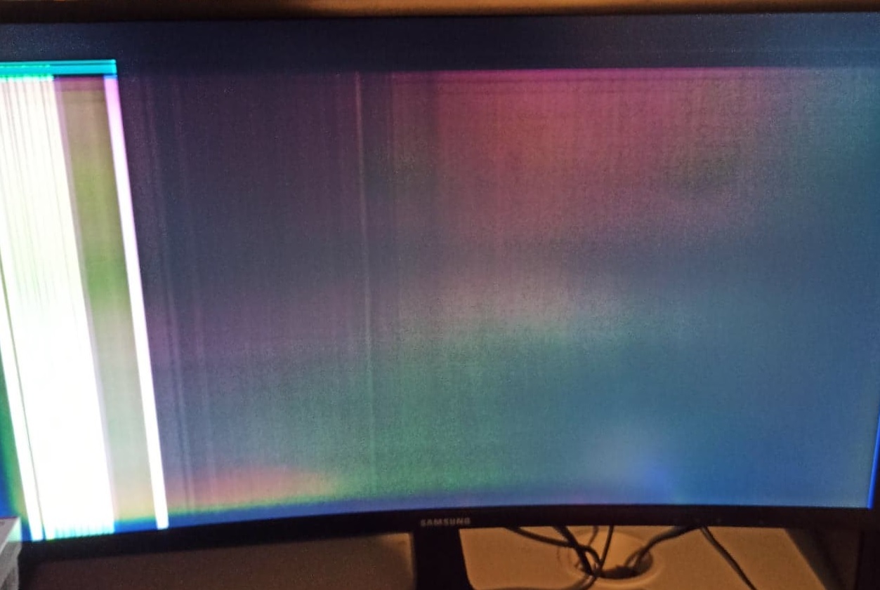

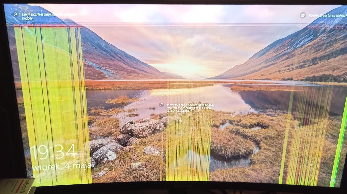

    I also noticed that when the computer is not turned on for a few days, the image appears on the monitor as shown in the attachments after turning it on. In a moment, however, it gets correct and everything works.

    leffort
    Posts: 7
    As you can imagine, these symptoms almost certainly mean that your graphics card is damaged. If you have the integrated one, take it out and test it.

    bedrull
    Posts: 49
    I think so too, but these stripes are so random (they only appear when I don't start my computer for a few days) that it's going to be hard to test.
