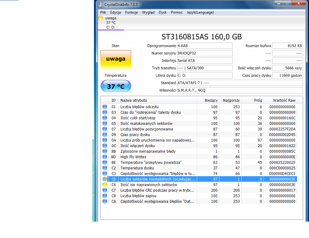

  • #6 16413906
    Kaymanpl
    Level 4  
    Posts: 145
    Rate: 10
    I have no idea how to check it, please explain to me oneself. And I will not do a new drive because I can not fire it and I do not have so many cables to connect 2.
    • Blue Screen in Windows 10: Fix Computer Crash, Startup Issues, No Repair Cost Bez tytułu.png (127.99 KB) You must be logged in to download this attachment.

    #7 16414117
    kokapetyl
    Posts: 13445
    Help: 1787
    Rate: 2101
    Kaymanpl wrote:
    . And I will not do a new drive because I can not fire it and I do not have enough cables to connect 2.
    The disk you presented is rather damaged and its repair will probably not produce positive results.
    If you can not connect two drives at the same time, then either buy missing cables or run SMART with MHDD. To do this, you need to run the PC from botmed media with this program (pendrive / cd). Something about this program https://www.elektroda.pl/rtvforum/topic1550200.html

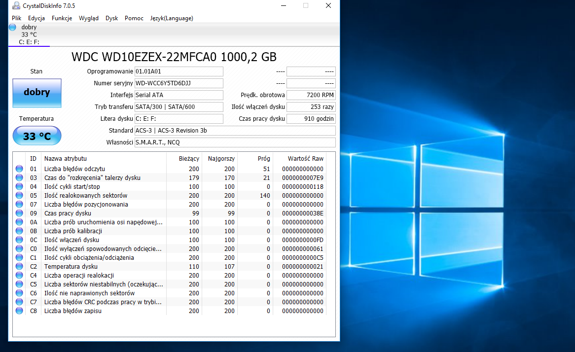

  • #13 16427653
    Kaymanpl
    Level 4  
    Posts: 145
    Rate: 10
    Hubotx, unfortunately, I do not have but I just made the format of the disk ca I still have a diem there, I have the most important data, so I did not lose anything only programs from c.
    I will make a Smart Disk soon
    Added after 3 [minutes]:
    Please, this is the result from my current new hard drive:
    • Blue Screen in Windows 10: Fix Computer Crash, Startup Issues, No Repair Cost asd.png (393.93 KB) You must be logged in to download this attachment.
