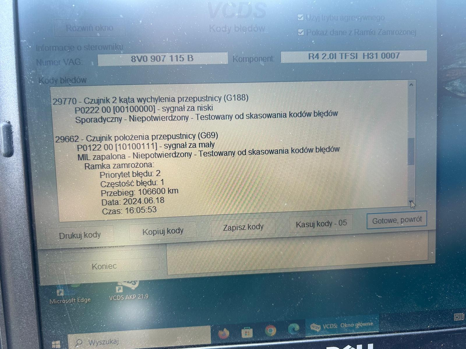

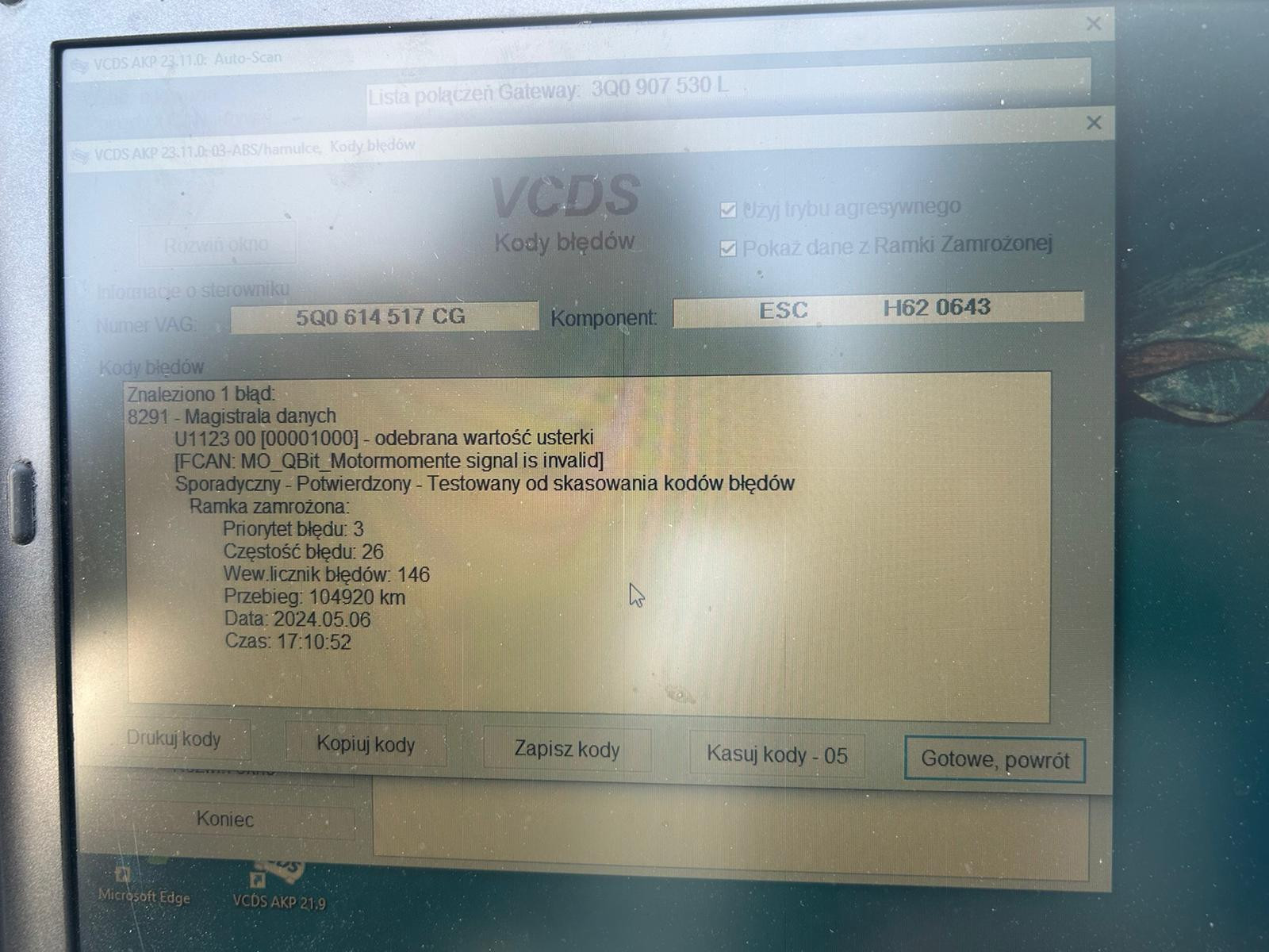

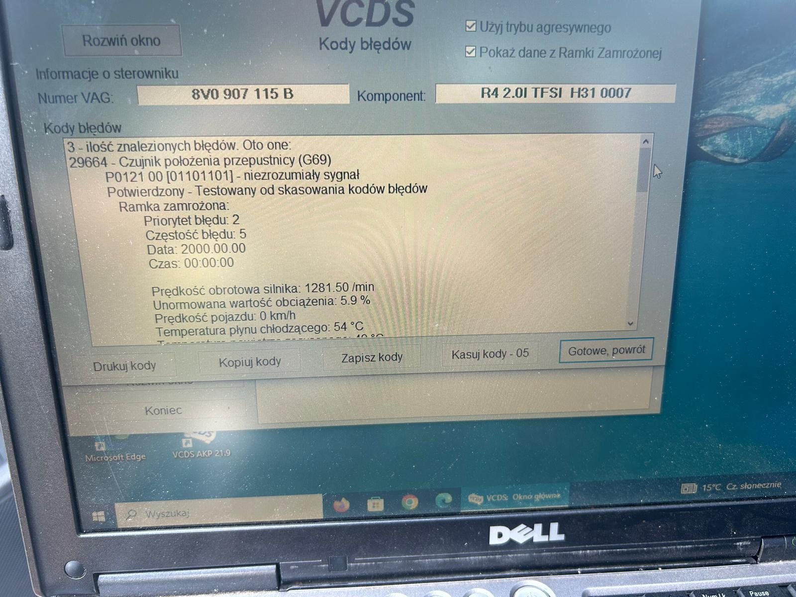

    Good morning, I have a similar problem to the previous speakers. A constant EPC light popping up, going hand in hand with an engine error. The throttle has been replaced twice now and the problem keeps coming back. Here is when the errors.

  • #19 21394391
    carrot
    Moderator of Cars
    Posts: 8438
    Help: 1311
    Rate: 3575
    Well, then you need to call the wire harness between the throttle and the controller, but not with a pen meter, but with a halogen bulb (H4 or H7), then you will have confirmed the continuity of the wires
