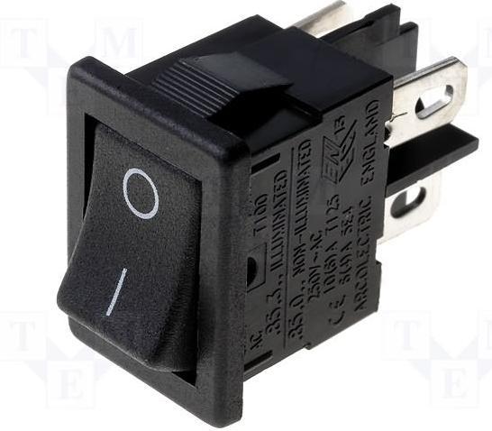

    What is the difference between these ON-ON and OFF-ON contacts?

    Okay, can I use an on-on or off-on button as a switch for the power supply? Is there a difference?

    And what is this switch supposed to do?
    As mentioned above, ON-ON is switch ON-OFF is switch (or switch if you prefer).
    smartfon wrote:
    apply the button
    Maybe show us this button (photo, link).

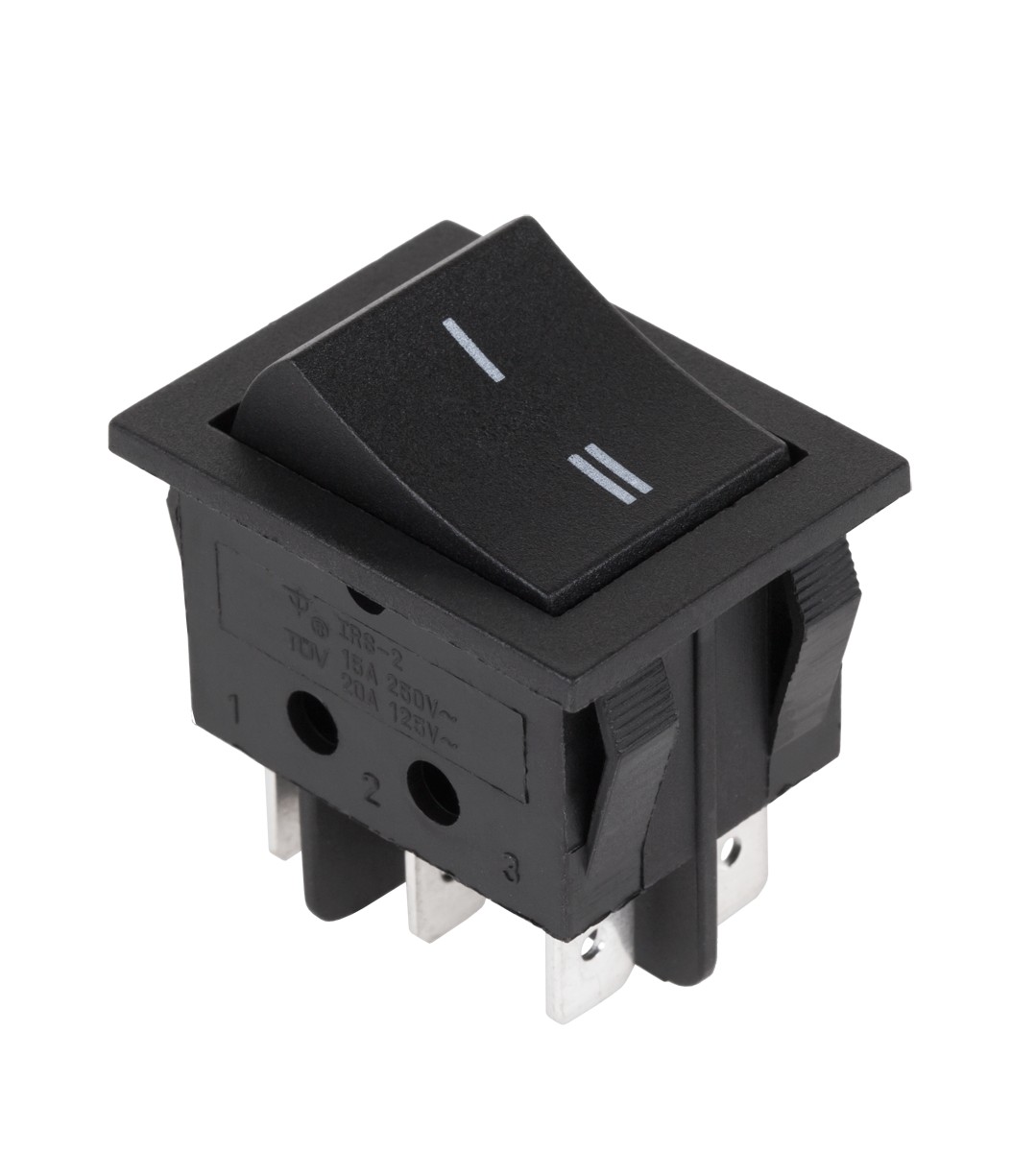

    elbrod-smrs101-6a-1291-rocker-switch-off-on
    elbrod-smrs102-2-1343-rocker-switch-on-on
    Moderated By ANUBIS:
    3.1.18. Do not send links that will cease to be active after some time. This will make the discussion meaningless.
    It is supposed to start the power supply. Which one can I apply to it?
    ON-OFF

    And if I used ON-ON, I wouldn't run the power supply?

    Oh, I see you still don't get it. In short - if you wrongly connect the cables to the ON-ON switch, you will not start it, if you connect it well, you will start it.
    Look again what the differences are:
    Difference Between ON-ON & OFF-ON Contacts: Understanding Switch Contact Configurations

    You can use any of them as long as you connect well.
    The ON / Off buttons are a bit cheaper.
