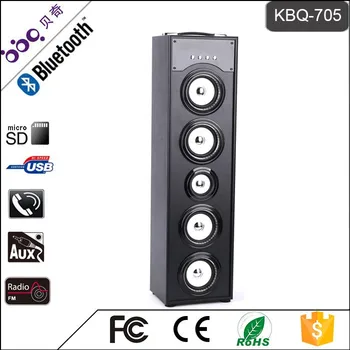

    rimot wrote:
    What speaker? What kind of USB socket is not working? Where are the photos? What to do? If you are "green" do nothing yourself. There are some topics on Elektroda regarding USB replacement ... Just look for it.
    Standard USB, Speaker: KBQ705 - http://sc01.alicdn.com/kf/HTB1slqNJFXXXXXuXFX...5-Newest-Wooden-Plating-Cover.jpg_350x350.jpg
    And the photos are in the spoiler.
