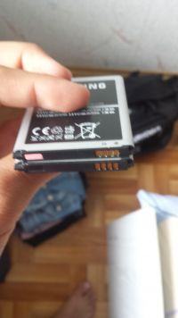

    Hello, as in the subject. I mean, I have 3 3.7V batteries for my Samsung Galaxy S3 (they are identical) and I would like to do something with them. I know that if I connected them in parallel, I would get the same voltage, but higher capacity. Could someone show if I could do it? If necessary, I can send a photo of what the battery contacts look like. And I have a question what else would be needed, a converter?
    Please help. Best regards.

    I understand, someone else could tell me how can I connect such batteries? Yes, plus to plus minus to minus and it will be in parallel, but here are 4 contacts and I don't quite know how, and the question is how to connect it?
    Edit: foto

    Even in this photo you can see that the + and - contacts are marked. Plus is the first from the right when looking at the photo and the minus is third from the right, to be sure check with the meter you have, the others are checking the status and charging of the battery. If you want to charge such a package with a phone that they fit, you need to solder it so that it enters the phone (little tin and thin wires or a copper ribbon). And as with any other charger, remember that by charging with too much current, the electronics inside the battery can cut off the charging.
